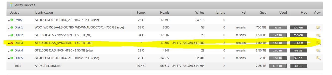

Disk failed ?
Can anyone give me some tips to repair this?
I know I have not been good at keeping up with maintenance.  I actually have 2 x 4TB WD Reds that I need to get installed.
This disk is disabled and its contents are being emulated. The disk might have failed but it quite possibly is fine. We need to see what has been happening. Go to Tools -> Diagnostics and post the zip file.

Disk 3 dropped offline but that doesn't mean the disk has necessarily failed. Power down, check its cables, then power up, start the array and grab diagnostics again. It will still show a red cross but hopefully the disk will be back on line and we'll get a SMART report from it. If the SMART report looks good then the disk can be put back into service.
However, your server has other problems. Disk 2 has three pending sectors, which will adversely affect the ability to rebuild the disabled and emulated Disk 3. Disk 2 also has 139 reallocated sectors. That's not an immediate problem but you need to keep an eye on it. Disk 4 has one reallocated sector - again not a problem in itself if it remains stable, but you need to keep an eye on it.

Okay,  I rebooted and started array.  My disk is still failed.  I started array and ran a Diag ... any thoughts?
