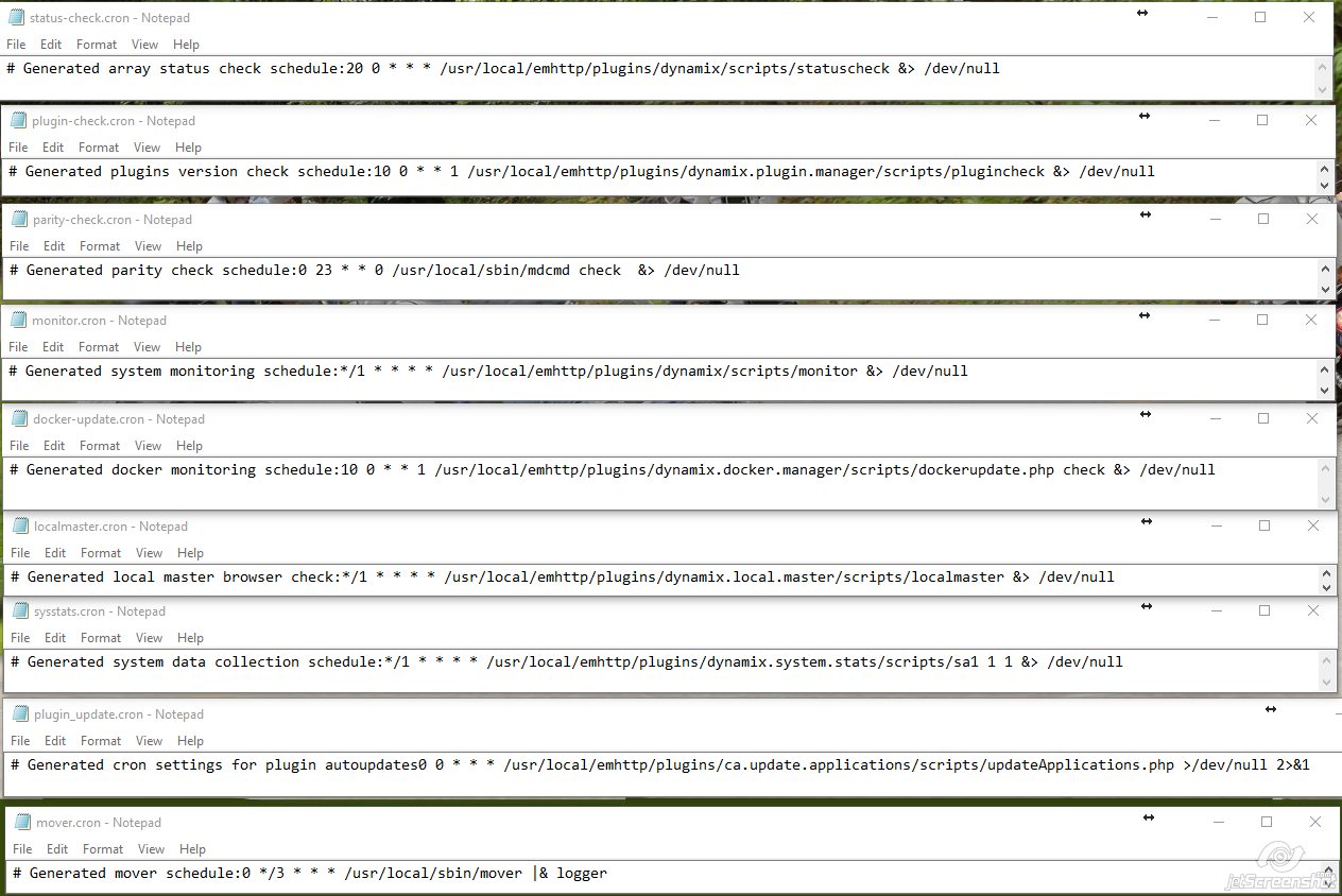

Regarding the subject of this topic (repeating/spam log entries), I've not been able to figure that out yet.  I searched on all the .cron files in the flash plugins directory.  I've attached an image of their contents.  Didn't see anything obvious...to a newbie...  But maybe you were referring to the cache_dir issue, rather than the repeating chdir failed errors in my syslog.
Edited by jeffreywhunter

2. Corrected cache_dirs and leftover unmenu entry in go file, solved those problems
But continue to see the chdir fail entries.
I have recently installed several dockers (MySQL, Pydia, Plexpy) and some plugins (Apache and ProFTPd).  But disabling didn't stop the crond errors.
I did a crontab -l, here's the output (just the default)
root@HunterNAS:/# crontab -l====> (Note I removed comments)# Run hourly cron jobs at 47 minutes after the hour:47 * * * * /usr/bin/run-parts /etc/cron.hourly 1> /dev/null## Run daily cron jobs at 4:40 every day:40 4 * * * /usr/bin/run-parts /etc/cron.daily 1> /dev/null## Run weekly cron jobs at 4:30 on the first day of the week:30 4 * * 0 /usr/bin/run-parts /etc/cron.weekly 1> /dev/null## Run monthly cron jobs at 4:20 on the first day of the month:20 4 1 * * /usr/bin/run-parts /etc/cron.monthly 1> /dev/null0 3 * * * /usr/local/emhttp/plugins/ca.backup/scripts/backup.php &>/dev/null 2>&1root@HunterNAS:/#
Did a cat of cron.d/root
root@HunterNAS:/etc# cd cron.droot@HunterNAS:/etc/cron.d# lsrootroot@HunterNAS:/etc/cron.d# cat root# Generated cron settings for plugin autoupdates0 0 * * * /usr/local/emhttp/plugins/ca.update.applications/scripts/updateApplications.php >/dev/null 2>&1# Generated local master browser check:*/1 * * * * /usr/local/emhttp/plugins/dynamix.local.master/scripts/localmaster &> /dev/null# Generated system data collection schedule:*/1 * * * * /usr/local/emhttp/plugins/dynamix.system.stats/scripts/sa1 1 1 &> /dev/null# Generated docker monitoring schedule:10 0 * * 1 /usr/local/emhttp/plugins/dynamix.docker.manager/scripts/dockerupdate.php check &> /dev/null# Generated system monitoring schedule:*/1 * * * * /usr/local/emhttp/plugins/dynamix/scripts/monitor &> /dev/null# Generated mover schedule:0 */3 * * * /usr/local/sbin/mover |& logger# Generated parity check schedule:0 23 * * 0 /usr/local/sbin/mdcmd check  &> /dev/null# Generated plugins version check schedule:10 0 * * 1 /usr/local/emhttp/plugins/dynamix.plugin.manager/scripts/plugincheck &> /dev/null# Generated array status check schedule:20 0 * * * /usr/local/emhttp/plugins/dynamix/scripts/statuscheck &> /dev/nullroot@HunterNAS:/etc/cron.d#
Pretty vanilla...??!?
Try checking the cron log.
cat /var/log/cron
The entries running every minute other than the system monitor are the master browser and system stats plugins.
cat /var/log/cron
I filed a defect report where in safe mode update_cron still runs and is pretty much guaranteed to spam the logs
cat /var/log/cron
Cat /var/log/cron returned nothing.
root@HunterNAS:/# cd /var/log
root@HunterNAS:/var/log# ls
apcupsd.events  debug       faillog  libvirt/  nfsd/      preclear.disk.log  samba/    setup/   tor/
btmp            dmesg       httpd/   maillog   packages/  removed_packages/  scripts/  spooler  wtmp
cron            docker.log  lastlog  messages  plugins/   removed_scripts/   secure    syslog
root@HunterNAS:/var/log# cat cron
Sent from my LG-D852 using Tapatalk
So this means that the system itself is spamming the log?
No.  It just means that in safe mode, the plugin system is still adding in the cron entries for the various plugins, but since the plugins themselves aren't installed, the syslog is going to indicate errors everytime that particular cron entry runs.  Explains why your /etc/cron.d/root file had the entries in safe mode, and why in safe mode you were still seeing the syslog spam from system stats (which runs every minute)
That makes sense as an explanation from seeing those entries in safe mode.  But does it also explain why I'm seeing those same entries while not in safe mode?  Is there something I can turn off now to stop the log entries (I'm having to reboot the server almost every day because of the log filling...)...
Until its figured out, the solution is to uninstall the plugin in question (system stats) and reboot.
Uninstalled Dynamix System Stats...  still seeing the crond spams...  Syslog attached...
Obviously its a different plugin?  If you look at the last couple of emhttp log entries you'll see emhttp: nothing to sync, then unbalance loads, then the crond errors start.  Are these entries proximity to the start of the crond errors diagnostic?  Could this problem be connected to the WebGUI and some font issue?
