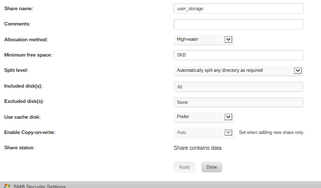

Hello Everyone,
I recently acquired a IBM x3200 M3 Server and decided that it could do some use as a NAS with all the whistles. I started with FreeNAS not knowing about unRaid until recently. And wow, I have to say I love the ease of setup compared to freeNAS. Although, I do know that I am now missing out on some features such as Snapshots and the ZFS file system.   I have successfully installed unRaid and got an array set up and working.
I wanted to know if there are any ways to improve my setup as far as performance goes. Currently I have my unRaid box connected to my router (Gigabit)  with CAT6a cable through-out my house. I also have two Netgear Gigabit 8 port switches that lead upstairs as well.
I am getting 112/s MB up / download connection between a PC in between my router. Are there any other settings that I can change in order to gain more speed? (I have attached a screenshot of the shares settings)
If it matters at all I have added my unRaid box to my domain as well.

you're essentially maxing gigabit, assuming your MB is megabytes and not megabits. you can fine tune here and there and eek out a few more MBps or switch over to 10gbe. But that entails a bit more financial commitment....
If 10GbE is out of reach due to costs or other reasons, you could look at LACP. However, you'll still have to have a capable switch and nics.
That said, if gigabit speeds are fine for your client machines but you have a bottleneck at the server then a good switch and nic bonding on the server might be enough.
Thanks for all your help! I suppose it's doing its' job then ;) .
