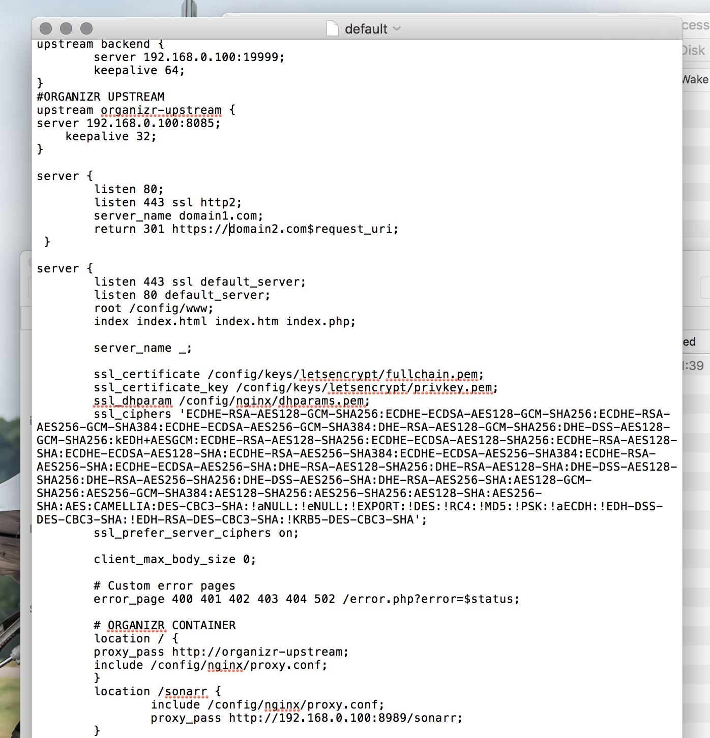

Hi all,
I'm hoping someone can help me with getting my (eg : sub.domain.com) to bring up Organizr when going to just the example link but it keeps defaulting to sub.domain.com/htpc
what I want to know is what do I need to change in the default file for lets encrypt to achieve this end goal?
eg sub.domain.com/organizr or just sub.domain.com to bring up organizr page
default file added to post

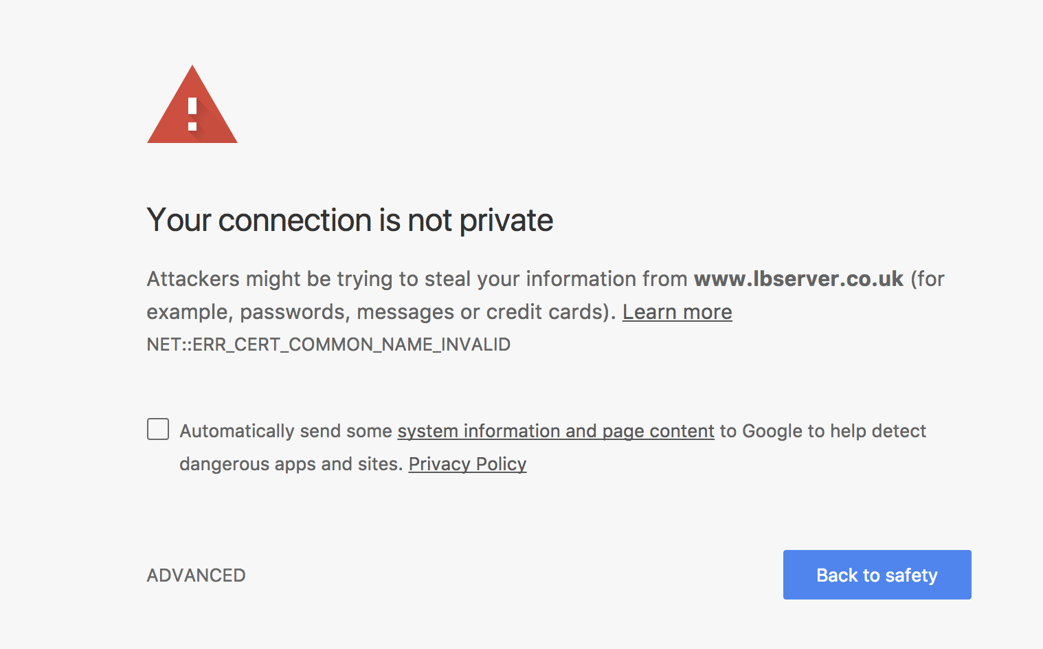

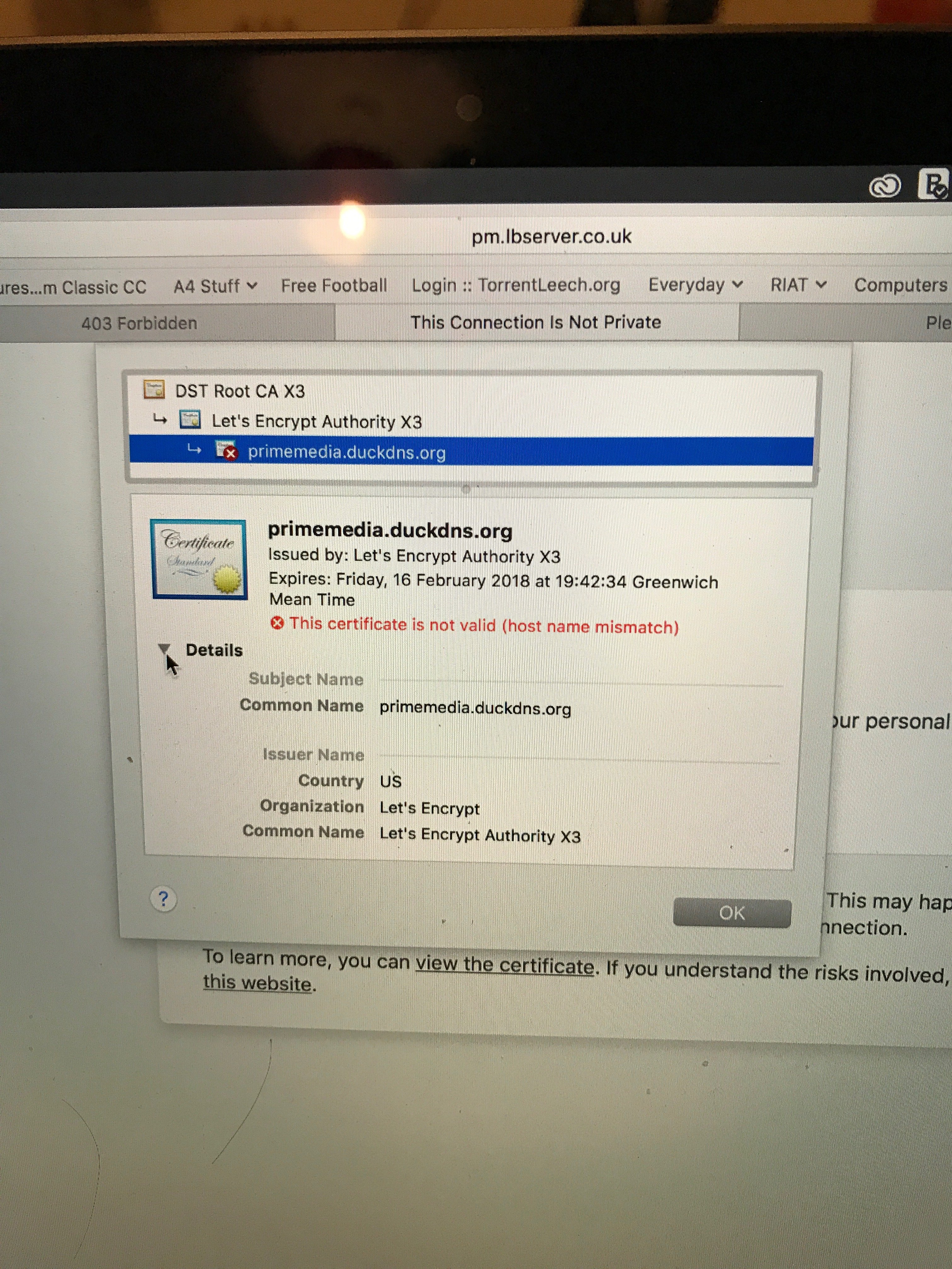

I have the Letsencrypt and the Organizr container installed but have the settings in Letsencrypt
I'm also have issues with certificate I have a duckdns set up eg https://sub.duckdns.org which letsencrypt does the cert ok for with no errors however I wanted to forward a 1and1 domain to it eg sub.server.co.uk using cname (sub.duckdns.org) but I get a mismatch with the certificate ... any ideas? also can I just forward the main domain instead? eg server.co.uk to sub.duckdns.org
Edited by Lee B
Your domain provider can probably forward the domain to sub.duck.org Check setting on your domain provider page.
I think you misunderstand ... I can forward it using CNAME but I get a certificate mismatch
 53273111617__5567FDDC-63E5-42A8-AD66-A6257F8A67E6.thumb.jpeg.66b5d55f7610bd1cff29d0d5c0cd3221.jpeg
Then you can do a return 301
server {
        listen 80;
	listen 443 ssl http2;
        server_name domain1.com;
        return 301 https://$domain2.com$request_uri;
server {
        listen 80;
I placed the above code in the default file
5a13843ae3a54_ScreenShot2017-11-21at01_39_08.thumb.png.d24cdc57086931e2aa8c173fee64be14.png
but still not fixing the Certificate mismatch,
 5a13843cedba4_ScreenShot2017-11-21at01_40_24.png.5bad1f7251265f48caedcfa0e6acd55a.png
5a1384432f3d6_ScreenShot2017-11-21at01_40_33.thumb.png.a12ff071f8da21f5238f8767e2357f03.png
plus can I force it to go from the unsecured http://www.domain.co.uk to https://www.domain.co.uk
Cheers Lee

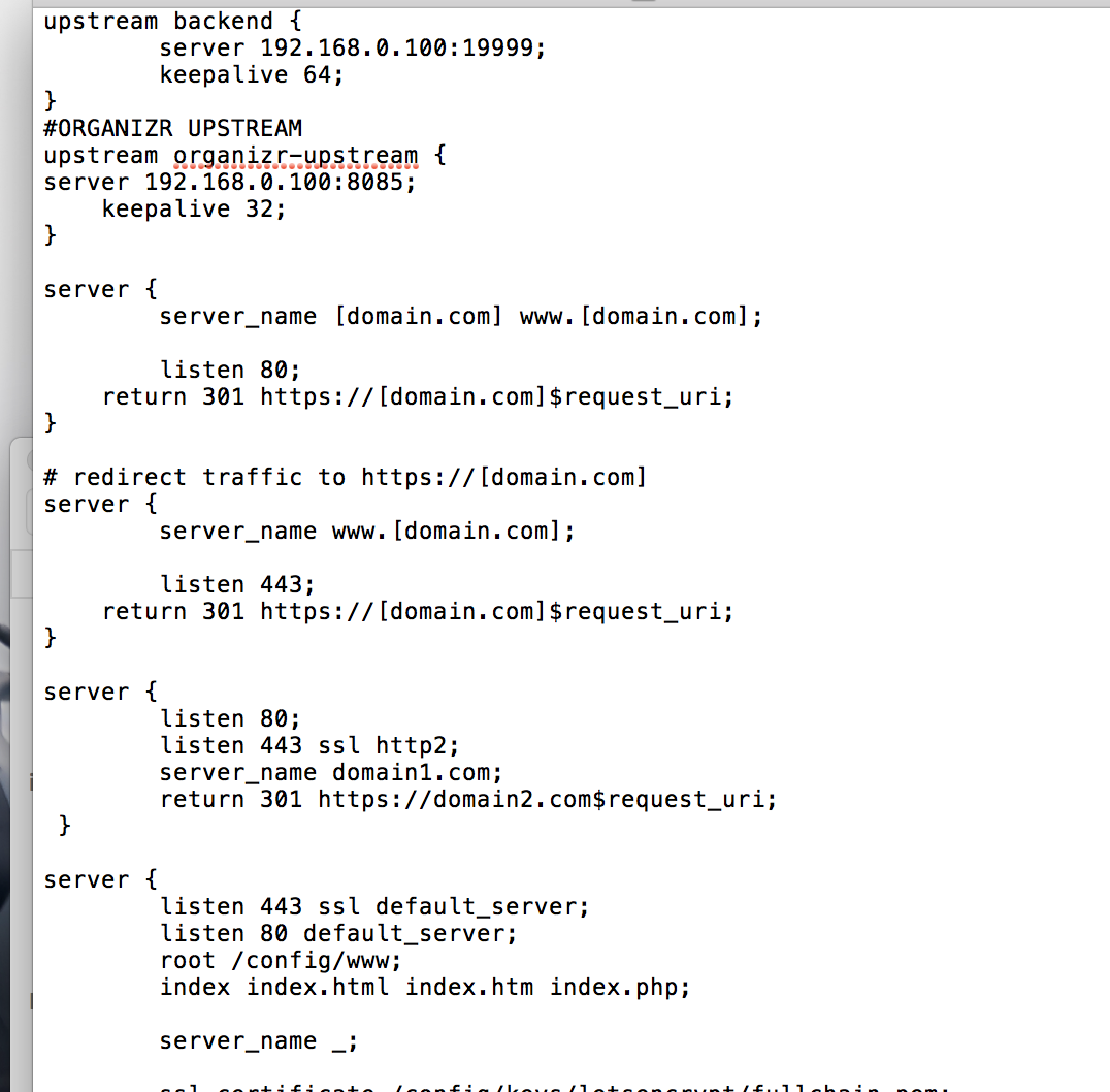

even tried this I found on the thread
5a138c58478a1_ScreenShot2017-11-21at02_14_31.thumb.png.d4dec4cbf72cdb9cfcfa5c47c2accc3e.png
