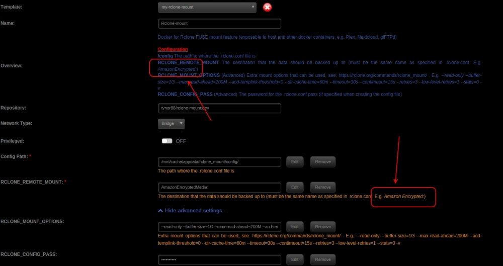

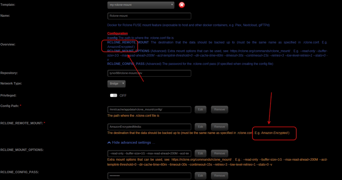

Having a play around with this and I think there's a typo in your template -submitted an issue on github
Happy to help :)
When /mnt/disks/rclone_volume was created it was owned by root with 755 permissions. Quick chown/chmod fixed it but I was getting permission errors before that.
It might also be worth highlighting the ":" at the end of the value in the RCLONE_REMOTE_MOUNT key.
ie.
KEY: RCLONE_REMOTE_MOUNT
VALUE: GDrive: <<<< This colon is important
For testing it's wise to point at a smaller subfolder ie. GDrive:rclone (I'm impatient 9_9)

Right, gotta fix that. I was using a folder which was created by @Waseh's plugin, so my permissions were ok.
Yes, i tried to make that clear in two places. (See screenshot). But you're right - it wouldn't work without a colon. I could perhaps check the variable at startup, and fail fast if there is no ":" specified.
