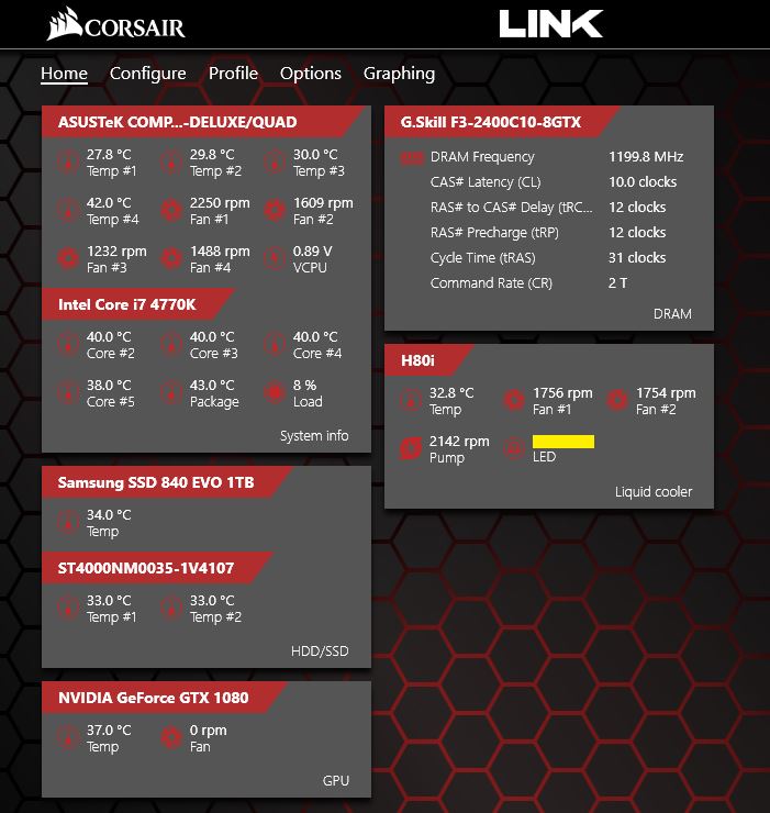

I've moved to the Corsair H80i v2 cpu cooler on my unraid server and I'm looking for a version of the Corsair Link App that works in Linux /unraid, perhaps a plugin?   After searching, it' doesn't seem there is a plugin, but I thought I would ask if anyone is working on one.
The only other option is to spin up a Windows VM and run the app from there, assuming it would be able to talk to the H80i.
In case you have not seen the Windows version, here is a screenshot Windows 10 system;
