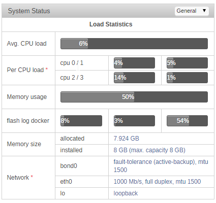

Sometime ago my docker image got filled up, so I didn't think much about it and just made the image bigger. Now, few weeks later the situation is the same, even though I installed no new applications.
I've found a topic about deleting log files, I tried that, but it didn't seem to work. How can I troubleshoot this?
Here is info from settings:
	Total devices 1 FS bytes used 18.28GiB
	devid    1 size 25.00GiB used 21.02GiB path /dev/loop0
Attached image shows change of 9% (2.25GB) within 24h!

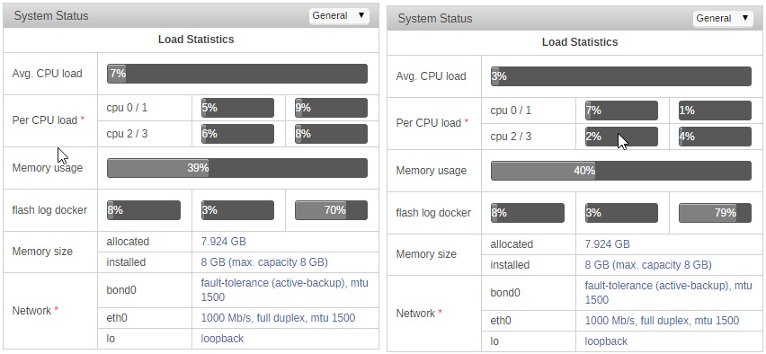

OK, I removed Deluge.
Here is cAdvisor now:
plexinc/pms-docker latest sha256:beb7140c2a4a2a7ca 381.65 MiB 6.07.2017, 02:07:15
linuxserver/resilio-sync latest sha256:e742cb2dba2875364 165.85 MiB 8.07.2017, 00:37:21
google/cadvisor latest sha256:f9ba08bafdeaf8158 54.66 MiB 10.03.2017, 00:30:29
gfjardim/crashplan latest sha256:3517caa72cbcf70a7 756.87 MiB 25.10.2016, 17:47:05
It still doesn't add up to 17GB:
	Total devices 1 FS bytes used 12.30GiB
	devid    1 size 25.00GiB used 17.02GiB path /dev/loop0
