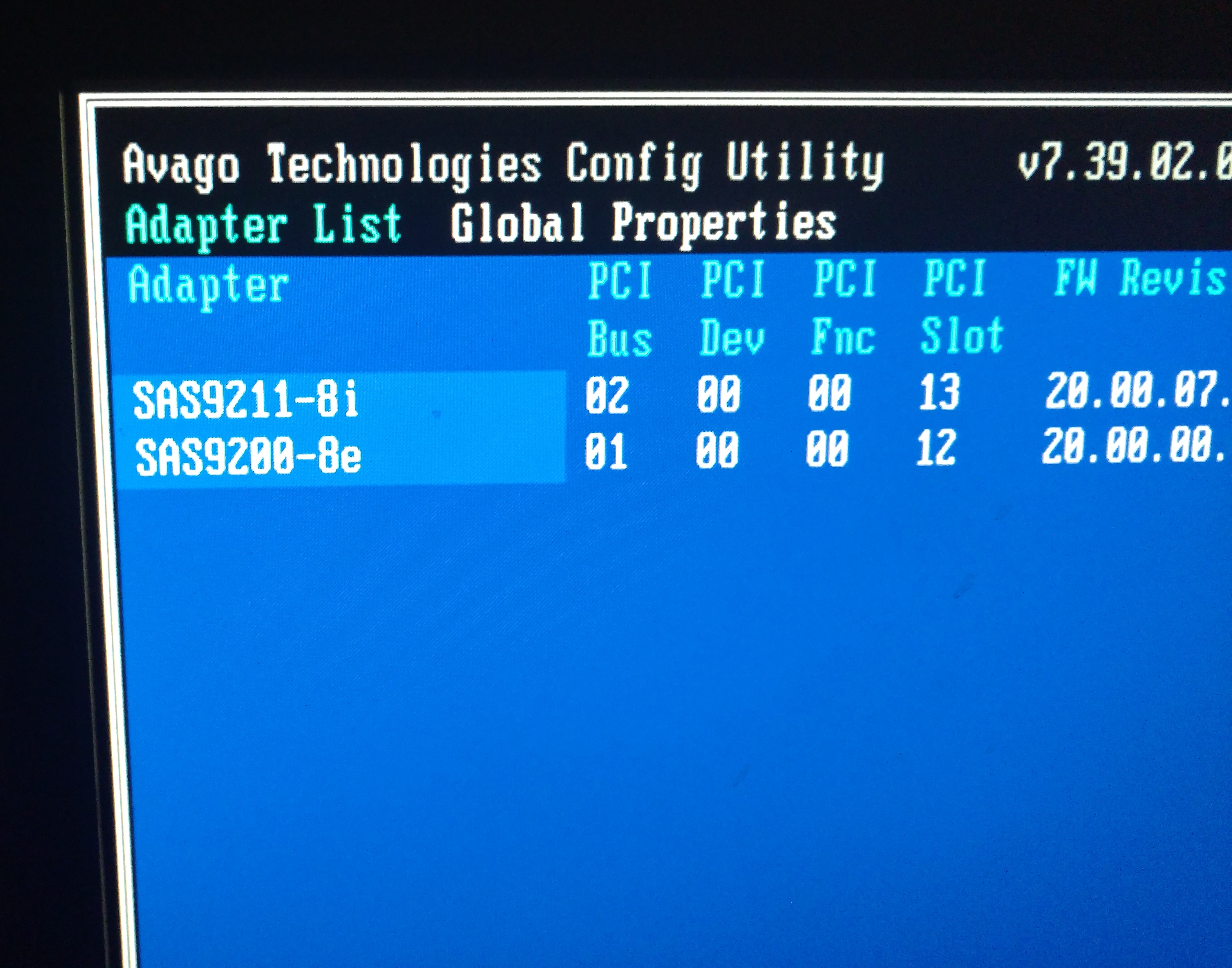

July 30, 20179 yr Have an M1115, added what is supposed to be an LSI 9211-8i. On boot, the BiOS for the controllers shows an SAS9211-8i and an SAS9200-8e. The 8e is the new card. I immediately had hundreds of read errors, but only on my 8TB Seagates. These were connected to the new controller. Other disks were also connected and no read errors were present. A parity check, as a test, was attempted. 250-400KB/s, eventually going to 0.0KB/s, with over 600 days to complete. I swapped cables so the 8TB disks would run on the old controller. Now I am getting 15-28MB/s on a parity check, so far no read errors, but obviously these speeds are atrocious. From what I can gather, the "8i" means 8 internal connections, while the "8e" means 8 external connections, ie, SAS expander. So perhaps the new card is flashed with the incorrect firmware? Diags attached. Any help appreciated. ffs2-diagnostics-20170730-0542.zip
July 30, 20179 yr Author Additional research. Could be a counterfeit card. This is my main concern. According to what I've read online, the 8e is indeed a model number expressing external connectors, which have a cable model type different from internal connectors. I doubt the cables are electrically different, but if they are, then if the card thinks it should be communicating over one type of cable (external) and I have it connected with internal cables, I am worried about data corruption. If the card is counterfeit, I am worried about data corruption. If the card is legit and was flashed with incorrect firmware, I am worried about data corruption. I have a parity check going again and it seems to have settled at 20-29MB/s..... About 25% of what I usually get. So something is very definitely wrong somewhere down the line. While I do not appear to be getting read errors now, I am getting thousands of these: Jul 30 06:46:06 ffs2 kernel: scsi target1:0:4: handle(0x000c), sas_address(0x4433221105000000), phy(5) Jul 30 06:46:06 ffs2 kernel: scsi target1:0:4: enclosure_logical_id(0x500605b002c8b32b), slot(5) Jul 30 06:46:06 ffs2 kernel: sd 1:0:4:0: task abort: SUCCESS scmd(ffff8802c42b1c80) Jul 30 06:46:08 ffs2 kernel: mpt2sas_cm0: log_info(0x31110630): originator(PL), code(0x11), sub_code(0x0630) Jul 30 06:46:39 ffs2 kernel: sd 1:0:2:0: attempting task abort! scmd(ffff88030c4d2c00) Jul 30 06:46:39 ffs2 kernel: sd 1:0:2:0: [sdd] tag#4 CDB: opcode=0x88 88 00 00 00 00 00 02 4d b6 50 00 00 04 00 00 00 Jul 30 06:46:39 ffs2 kernel: scsi target1:0:2: handle(0x000d), sas_address(0x4433221103000000), phy(3) Jul 30 06:46:39 ffs2 kernel: scsi target1:0:2: enclosure_logical_id(0x500605b002c8b32b), slot(3) Jul 30 06:46:39 ffs2 kernel: sd 1:0:2:0: task abort: SUCCESS scmd(ffff88030c4d2c00) Other posts on this forum point to a controller problem. I am re-using old cables, but they were used (successfully) with another controller in another system. Perhaps the controller is flat out bad? I really want to just power down the server until this is settled, but there is data there that would be nice to access. I can live with slow speeds, for now, but as I said, my chief concern of course is data corruption. Is it safe to proceed or should I just power down the server until I have time to swap out the new controller and return to the old config?

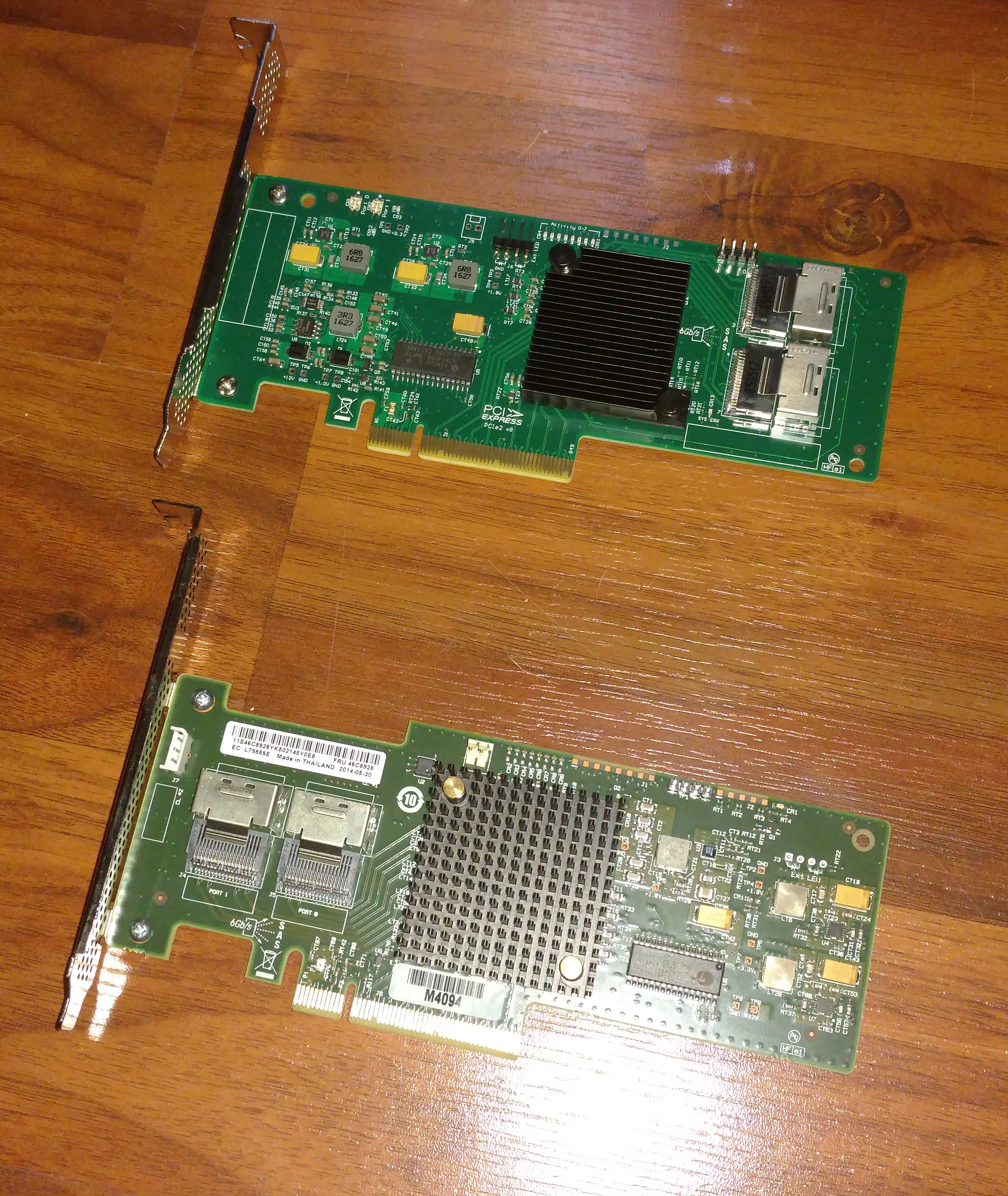

July 30, 20179 yr So an 8i will have 2 internal SFF8087 ports, and the 8E will have 2 external SAS connectors on the PCI BracketCan you try remove the new card physically from the server? It may be that the two cards are too far apart in firmware to be playing nice in the one setup. I run my LSI cards on P20 across the board, some people prefer P14 as well. If you can try removing the new card, and for curiosity, post a photo of the cards tooCheersSent from my iPhone using Tapatalk
July 30, 20179 yr Author As suspected, the card thinks its an 8E, but its not. Might that be an issue? Back to original config, old LSI purring along, onboard SATA controlling the rest. 140MB/s parity check, will eventually settle down to 80-90MB/s as usual. So we're back in business. Old card is out, gonna mess with firmware and cables on my next days off. Otherwise its going back to the fleabay user I got it from. Pics attached. I realize I cut off the firmware revision, but yeah, the firmware is different. Old card is on bottom (vertical sata ports), new card is on top (ports on the end of the card).
July 30, 20179 yr Community Expert Possibly a bad/fake controller or just flashed with the incorrect firmware, also the p20.00.00 was very problematic, it should be like the other one p20.00.07, you can try to flash it with the 9211 p20.00.07 firmware and see if there's any difference.

August 3, 20179 yr Community Expert 23 minutes ago, bjp999 said: This is the second problematic 9200 card reported here (other was a -16e). I would steer clear of them. They are an older generation (not sure why anyone in China would want to clone them, versus a more modern 9201 or 9211). It's not a 9200-8e, he bought a 9211-8i and besides being a fake it comes with a 9200-8e bios, I have a genuine 9200-8e and it works perfectly, it uses the same SAS2008 chipset as the 9201, 9210, 9211, etc.
August 4, 20179 yr Author 1 hour ago, johnnie.black said: It's not a 9200-8e, he bought a 9211-8i and besides being a fake it comes with a 9200-8e bios, I have a genuine 9200-8e and it works perfectly, it uses the same SAS2008 chipset as the 9201, 9210, 9211, etc. Yes, exactly correct. Marked as a 9211-8i, sold as a 9211-8i, pictured as a 9211-8i, the card that arrived looks like every other 9211-8i, however it boots as a "9200-8e" and, lo-and-behold, is a fake according to Broadcomm. It functions in the technical sense, but will not sustain more than 21MB/s. I also determined that the PCIe x16 slot on my motherboard is bad, and that was the cause for the read errors on any controller installed in that slot. Any controller/cable/disk combo in that slot resulted in either no drives being detected, or read errors on the drives that were. So now I am looking at a 9201-16i (as mentioned above, server pull from a US seller with 60k+ positive feedback, I think I'm safe) to replace the 9211-8i as I need more port density.
