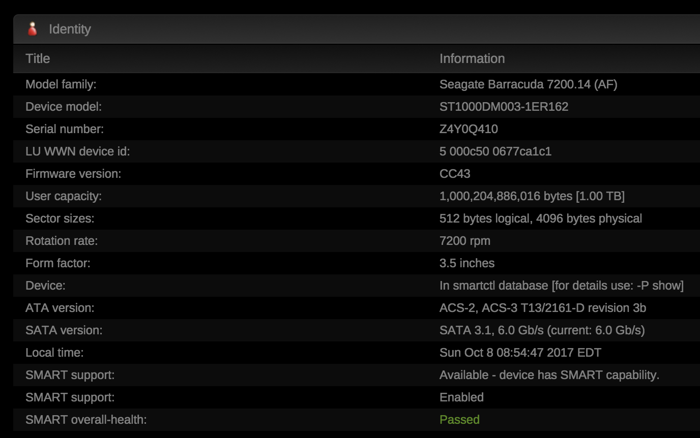

October 8, 20179 yr Thanks for the analysis @Squid I am suffering from this issue too. I wanted to let you know that I during parity check I did have the same issue with ACS-2, ACS-3 T13/2161-D revision 3b. The drive dropped off just like the ATA8-ACS did. Also, I have a parity disk that is Toshiba using ATA8-ACS that also dropped off.
