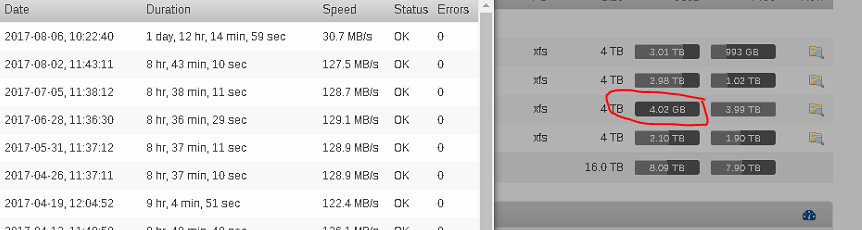

Drive 3 failed. When I finished rebuilding, all the files were missing on the disk

I was having trouble connecting to my array. So I restarted. When it was restarted, disk 3 was not formatted. So I tried to rebuild with the same disk
Did you hit the "format" button that appeared at anytime?
yes, i probably hit the format button be for i started to rebuild :S
That's the problem.
If a disk comes up as unmountable, it has some corruption on it (probably as @trurl said due to cabling issue, etc)
By hitting format, you've wiped the contents of the drive (format in unRaid is the exact same as any other OS).  If at the time the drive was enabled, then you've formatted the physical drive (and updated parity info to reflect this).  If at the time the drive was disabled, you've formatted the emulated drive - Subsequently rebuilding onto the same drive has then rebuilt the drive from the parity information - So it's now wiped clean.
Unfortunately right now, because you've done one of the two above scenarios, and rebuilt onto the existing drive, basically you've lost the file(s) that were present on the drive.
