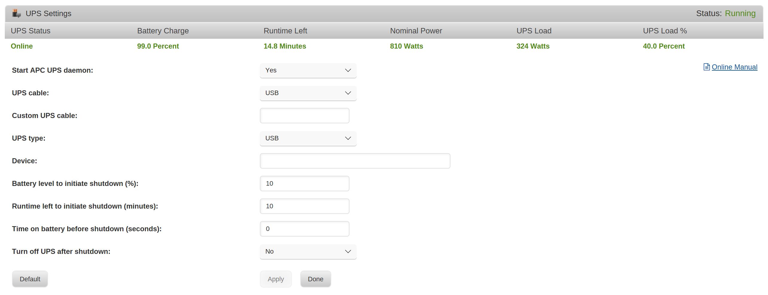

My power just went out. My power supply beeped (I heard it from the other room) and it seems to have shut off. When the power came back on, it started a parity check. My UPS settings are attached. I'm not sure why it didn't shut down properly. Any ideas?

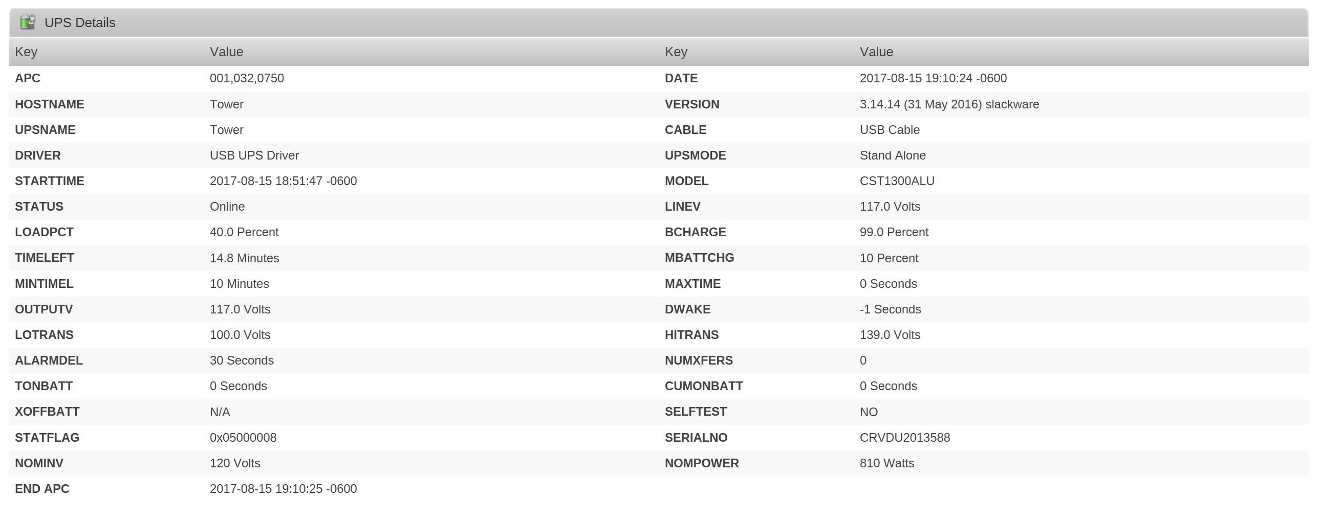

Looking at what you posted up.  Your load is 324 Watts!   I would next suggest that you look up the spec's on your UPS and see what the runtime is at that load with NEW batteries.  Then think about the age of those batteries.  (Battery capacity drops steadily with age until it almost reaches ZERO.)  (That "Run Time" number is almost never very accurate.  Don't put much faith in it...)
I also noticed that you have both the "Time left" and "Battery Level" set to 10 minutes and 10%.  That  is probably way too long and too a low percentage when the battery is a couple of years old.

I would also suggest that you set the Time on Battery" to something like 30 seconds.  The exact number on seconds something you should determine based on your experience in with your local Power Company.  The reasoning is simple.  In the most of the developed world, if the power is out longer than the value you set, it will be out for an extended period of time.  Far longer than any reasonably priced UPS system can provide.  You might as well bite the bullet and shutdown the server down quickly.  At the same time, the period should be long enough to get you past those power dips, line issues, and power company controlled outages.  (When I lived out the country, the power would go out an sunny summer afternoon day without a storm with three hundred miles for about 20 seconds.  The only thing I can think was happening is that the line repair men were opening a line breaker so they could make the final connection to the high line under a "no power" condition.)
One more possible issue.  The Max Wattage rating on a UPS is a very hard limit and is an instantaneous maximum.  If it is exceeded longer than a few milliseconds, the UPS invertor will do a hard shutdown!  (This is done by the manufacturer to protect those switching transistors to reduce the warranty costs.)  You might need to figure out what the peak load of this server is when everything powers up during the shutdown procedure.
Thank you both. The UPS is supposed to be around 850w but it is a few years old. This is my first real experience with a UPS. I just kind of assumed the "runtime left" would take into account the age of the battery, reflected by the current rate of discharge. I guess not. I've run the test and see if I need a new battery, which is most likely the case. How long do they last typically? 1 year? 2?
