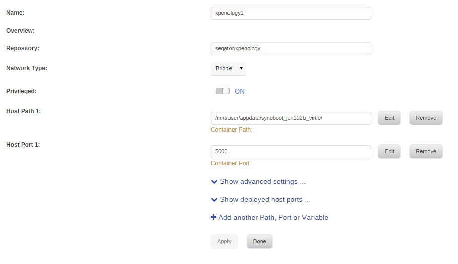

Made some headway yesterday... try the following:
Download img file from here named "synoboot_jun102b_virtio.zip" https://xpenology.com/forum/topic/7387-tutorial-dsm-6x-on-proxmox/?page=2 , put in folder for build, (a folder on your unraid box for doing the build)
Download GitHub repo files and folders from https://github.com/segator/xpenology-docker
You should now have a file called synoboot.img, Dockerfile, readme and a folder named bin with files in it.
Edit the file Dockerfile and uncomment out the #ENV VM_MAC "00:11:32:2C:A7:85" line and put a # in front of the other mac address line.
Now execute the following docker build -t segator/xpenology .   (note the ".")
Create new docker in the docker tab name it xpenology, name the repo segator/xpenology, setup paths for /image to be a folder in app data, setup a port forwarding for 5000.  Turn on privileged mode
Start up.
open web browser, goto your http://youripaddress:5000 .
Edited by dnoyeb
updated instructions

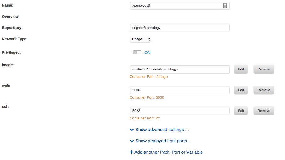

Here's a screenshot of my settings if you use the directions I posted above for building it off his github.  I have port 5022 forwarding to 22 as well so I can SSH into the box.
Edited by dnoyeb

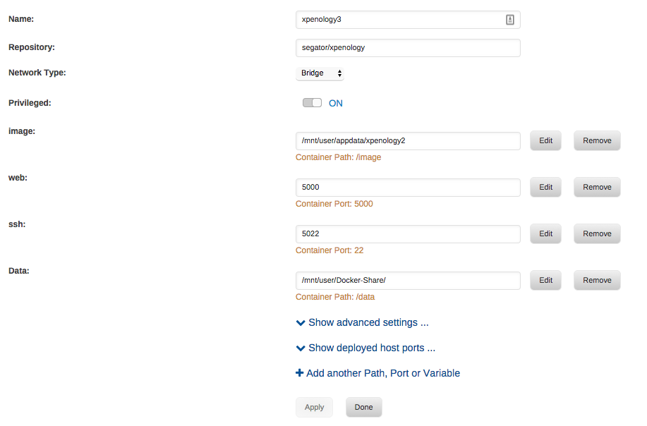

Key pieces of information here from his Github page...\
by default this docker image map the path /data to the 9p "hostdata"
mkdir /volume1/\@unraid
mount -t 9p -o trans=virtio,version=9p2000.L,msize=262144  hostdata /my/host/data
So, be sure to add a /data mount point to your docker page like below.  Keep in mind that whatever path you put in there will be shared with xpenology.... so if you want your entire unraid mnts showing, do it as /mnt/user/
I'll try and post up my version of the img file with the 9p files baked in, once using it; you just need to remount the mount point after a reboot (script it).

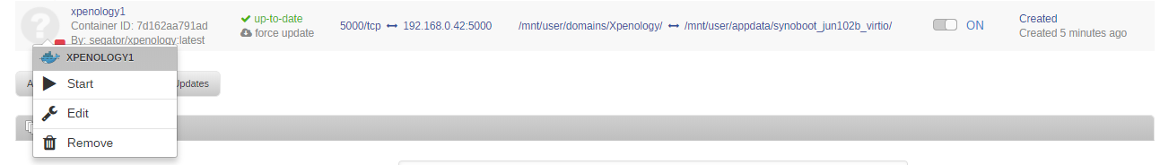

I'm getting nowhere,  i've no idea how to add that new Data tab.
Only able to direct to the folder set up previously with synoboot.img and docker files, plus port number.
Before i was running baremetal xpenology and i'm trying unraid for first time. Complete noob!
