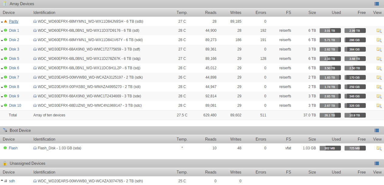

I have shrunk my unraid setup and removed an old drive with errors. Since I have added new bigger harddrives I do not need to replace it with a new disk as my storage needs are covered. Thus removing it seemed like the best option. I followed the instructions.
Now, new parity sync has just started and already after a few minutes I have had errors on three drives (two new drives and one that is a couple of months old). Obviously I am concerned. Should I be or is it normal that new drives have minor issues in a sector or two? I have just recovered from drive issues with my old hdd's. I solved this with you good help. Now I am again concerned.
No, run an extended test on those disks.
Can I run an extended test on the drives while parity is being rebuilt? Is that safe?
The three drives in question are not the parity drive, but they are being read to write the parity.
No, but the parity is going to be corrupt, no point in letting it finish.
Ok, so cancel the parity rebuild and run extended SMART test is the correct way forward?
Yes, to see if the problem is with the disks or some other issue.
Can I run extended SMART test on multiple drives at the same time or should I way intil one has finished before I start the next one?
You can run all at the same time.
Here are the SMART reports:
Edit: Report deleted.
Edited by kno
All disks passed the extended test, the issue is elsewhere, quind of expected since it's rare to have multiple failures at the same time, but it's good to rule them out.
Problem is most likely cable related, but it could also be a bad/failing power supply, controller, etc, start by checking/replacing all cables and then start a new parity sync.
