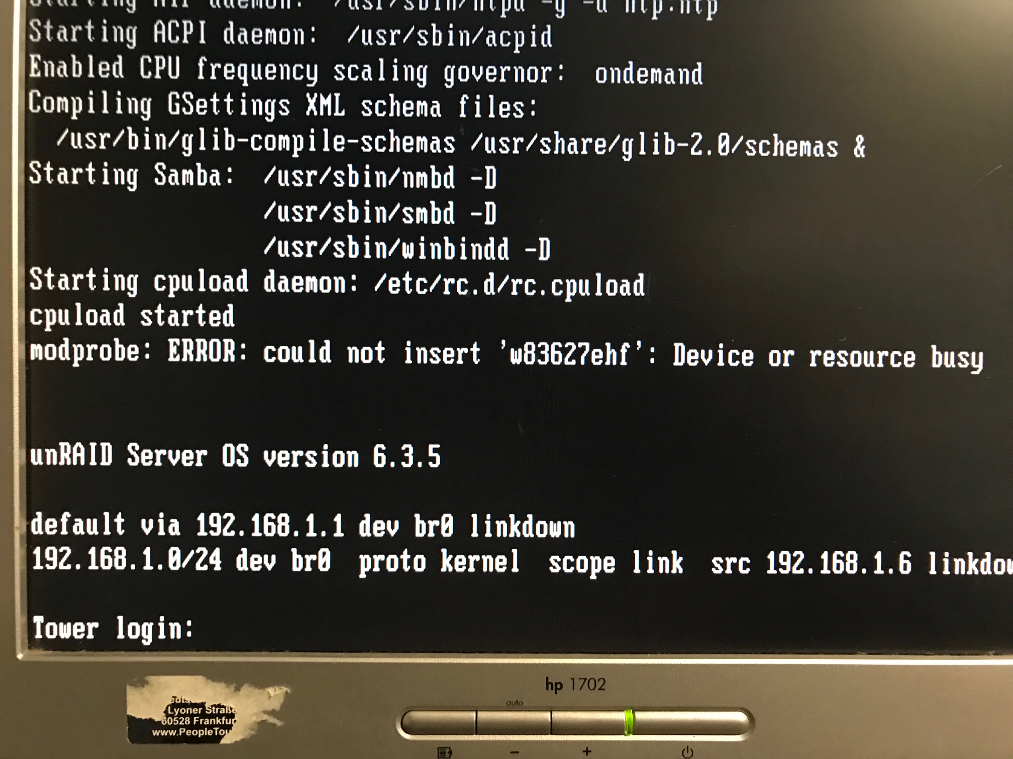

i have these hard crashes too. A week ago i came home to find my server unresponsive. after reboot my system wouldn't boot up in unraid.
i inserted my USB boot drive into a windows machine and got the 'you need to check this volume' so i did
after this i made the drive bootable again and iserted it in my server
server booted up and i got into the WEBGUI. started the array and started the parity check
all well and all until 2 days later. same happend out of the blue. no warning no nothing. just a hard lockup
after going through the same procedure as before i got into the system yet again. making this photo.
Now again my system is unresponcive and wont even boot.
maybe it has something to do with my hardware. will have to wait till next week.

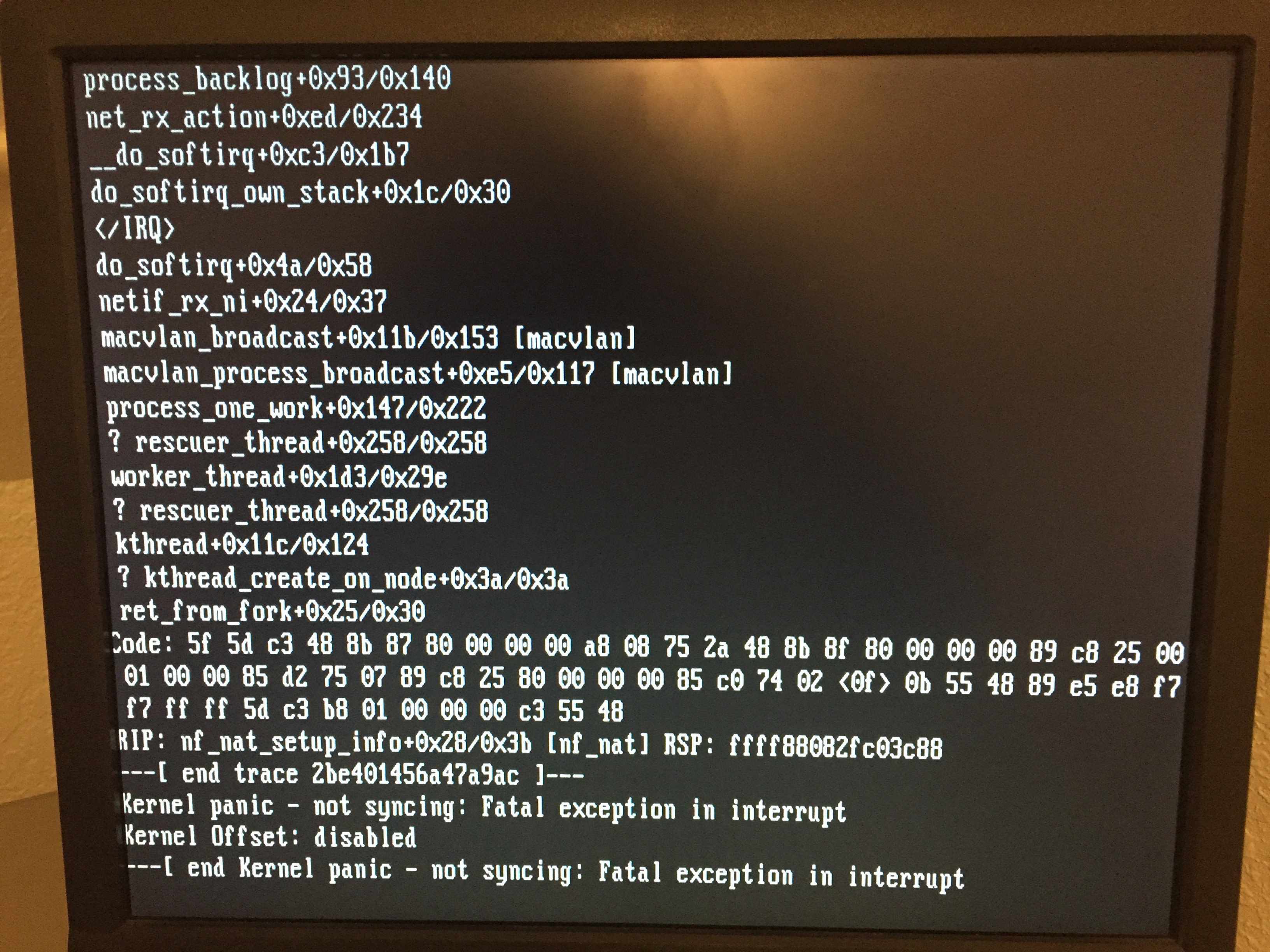

I was on the previous GA release, I believe it was 6.3.5 and was very stable. This is a server that has been stable for years. I wanted to get rid of pipework and move to the more native way of giving a docker container a dedicated IP. I have been hard crashing every few days. Is pipework compatible with the 6.4.0_rc10b version? I am considering going back to pipework just to see if I can regain stability.
thank you
thank you
Using version 6.4.0-rc10 and all my docker containers use macvlan (custom) networks without a problem.
Can you post your diagnostics after a crash happens.
The server was not responsive on the console. It is back up, usual docker containers started and it is doing a parity check. The one virtual machine is also back up.  The last hard crash was Monday around 8pm, this one was overnight Tuesday/Wednesday.
If it is the macvlan then I'm considering just not using it for the time being. The intent of separate IPs for each docker container was just so that it made it easier to track traffic in the firewall.
thank you

You should log in and tail the syslog as per the instructions in the first post of this thread. In my case, I was locking up with bridge mode enabled for a docker. I have disabled it and haven't crashed since.

I have removed all of the dedicated IPs from my docker containers. They are now all back on Network Type: Host.  The parity check from the hard crash this morning is at 85%. I am hoping that this makes the server stable again. Thanks to all.
