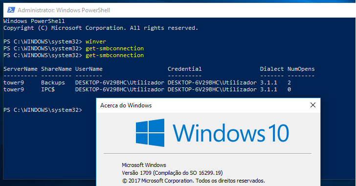

October 19, 20179 yr Community Expert 14 minutes ago, meoge said: It should just work if it defaults to SMB3, but it's definitely broken There's no general problem with unRAID and latest Windows update, I can connect fine without any issues, and as you can see it's using SMB3:

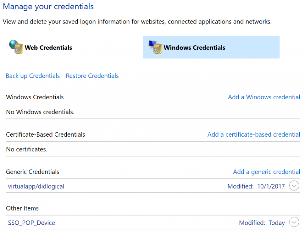

October 19, 20179 yr Author Quote Control Panel\User Accounts\Credential Manager I deleted all saved credentials for that server, every entry, listed by server name and by IP address. After removing those saved credentials, I can browse the server again. @meoge - you seem to have the same issue I was seeing, unable to connect via name or IP address. Have you tried deleting any credentials directed at your unRAID machine? That's what fixed it for me. I figured it out after I'd typed up my post, so I went ahead with the initial post and solution for others who may need it.
October 19, 20179 yr Author 7 hours ago, SSD said: If the IP address has changed, there is caching that occurs (separately for browser and Windows). I've had cases where the browser would not open my unRAID server by IP, @SSD - I was able to connect by name and/or IP to the unRAID web interface for both servers. Ping also worked fine for both by IP address. I just couldn't browse files using Windows Explorer (SMB). I tried adding a HOSTS entry to the server I couldn't reach, but that didn't help. Apparently after my Windows 10 VM was upgraded to 1709, the credentials it had saved to connect to Server A by IP and by Server Name would not work correctly, and it threw an unhelpful (Microsoft-standard?) error message each time I tried. The credentials are anonymous, not a custom name / pwd created in the unRAID GUI. Using Control Panel\User Accounts\Credential Manager, I deleted the saved credentials, and everything started working properly again.
October 19, 20179 yr 47 minutes ago, stewartwb said: Using Control Panel\User Accounts\Credential Manager, I deleted the saved credentials, and everything started working properly again. Thanks @stewartwb! Gotta love this Windows 10 world where beta code can land our your hard disk with no warning. I just looking in my Credentials Manager and don't see what I would need to delete if I was hit with this problem. See screenshot below. Can you indicate what you saw and what you did. (BTW - no idea what that generic credential is, but did a search and evidently it is normal).
October 20, 20179 yr Author @SSD - I agree, your saved Credentials in Credential Manager looks good - I see no potential you'll have the issue I had when my Windows 10 upgraded automatically. I'm still curious to see whether @meoge is experiencing the same issue I had, and whether removing old saved credentials could improve his server's behavior.
