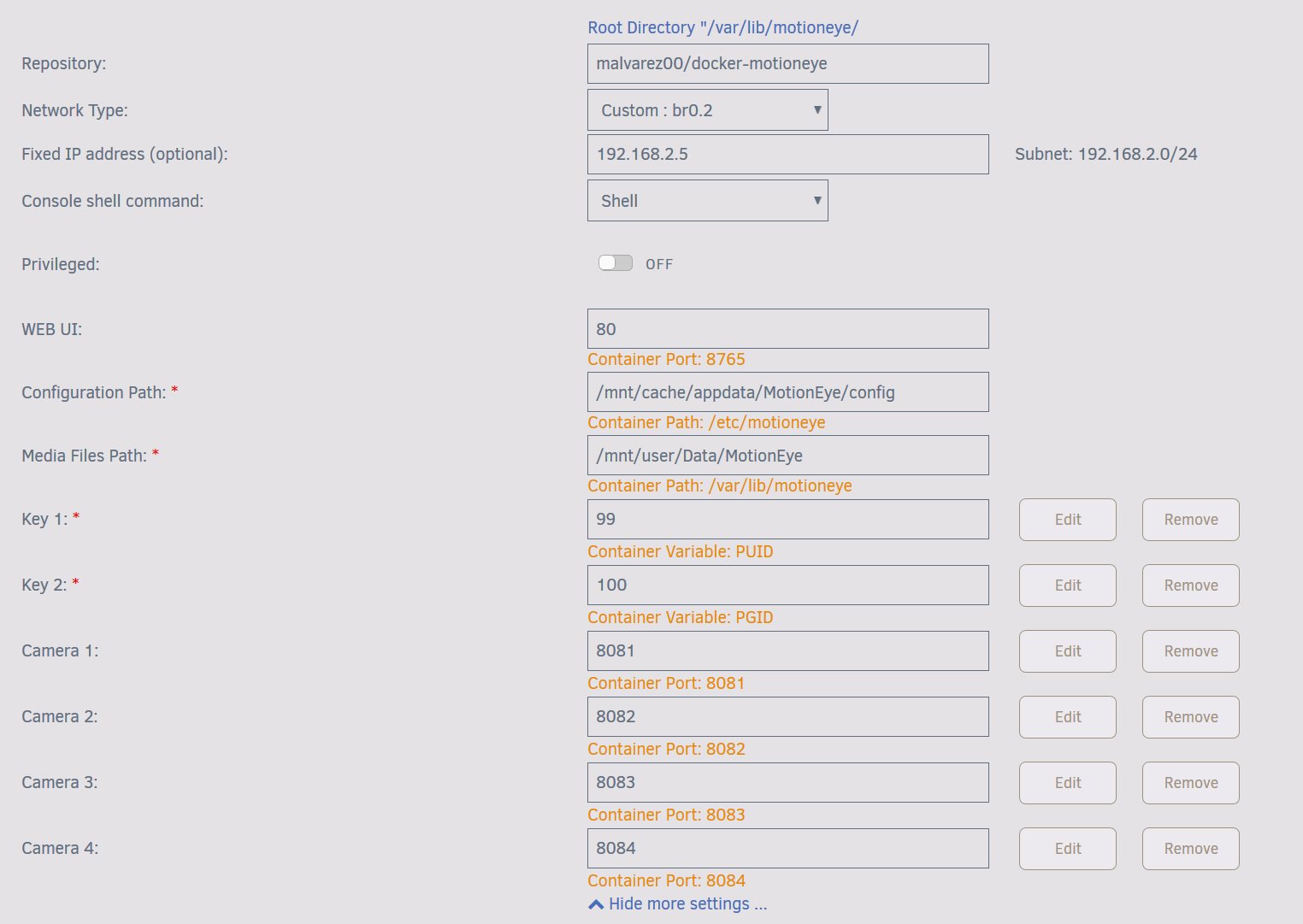

[SUPPORT] malvarez00 - MotionEye
I have got motioneye running as a docker on an unraid server which I recently setup.  The problem Iam having is that after restarting the server and then trying to login to motioneye I get an invalid credentials error.  I know that they username/password are correct.  Do I need to edit a config file or something so that it doesnt cause this error?

Hi Guys I have motioneye setup and have my cameras working on my unraid server.  Iam having a problem where when I shut down the server and try to login to motioneye it says I have invalid credentials.  I noticed on the log that it isnt saving to /etc/motion/ for the config file.  Any help thanks.
I am unable to set time zone in UI even after enabling it in the motioneye.conf file

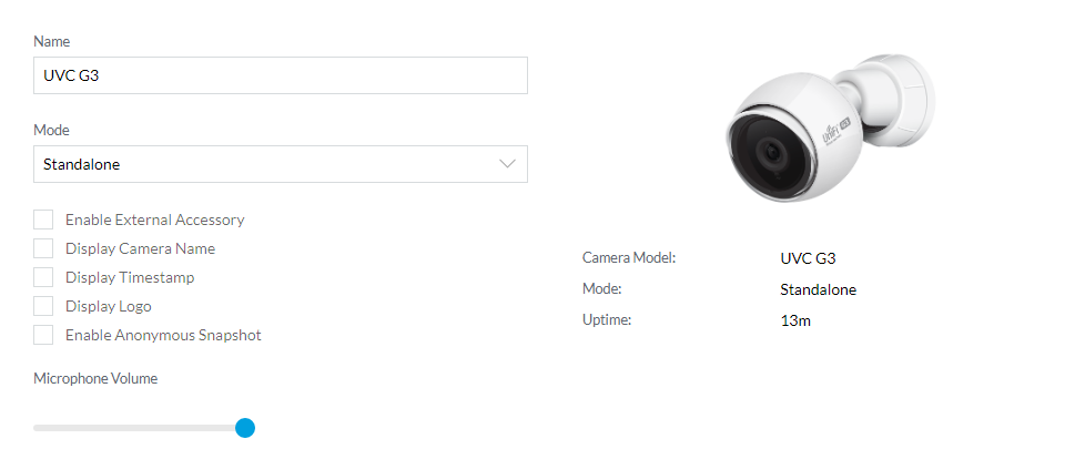

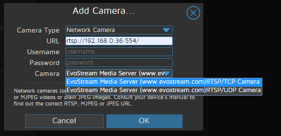

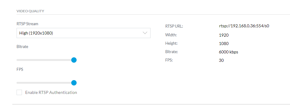

I have been having a bit of an issues with  MonitionEye that it is not showing the Stream from my IP Cam
I have been able to set up my Unifi cam with no issues, and set it to standalone.  fixing it's IP address
then I when to monition Eye and install the Docker, using all the default, then I tried to add the Unifi Cam, but here is where I am getting the problem.
as I have gone through the steps to step up the connection
I have tried both EvonStream and each time I am getting this
the pain in the ass is that I had this working, and then I packed it all away as I have builders around and I didn't want anything to get damage.
here are my Cam settings
before anyone say, I know that my Enable RTSP Authentication is turn off,  this is for testing only and I will turn it back on, once I get a feed from the cam.
can anyone help me work out why I am not getting a stream image within MonitionEye
Are you using chrome to view? if so see my post before yours.

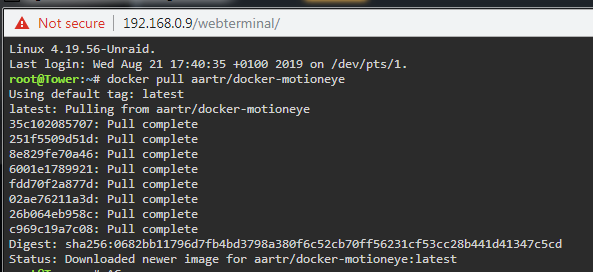

Thanks for the update.  I would just like to confirm that all i have to do is open a terminal and cut and paste in the command, reminding to change the repoaitory.
Update:  Ok I take a chance and I run the following command within a terminal docker pull aartr/docker-monitioneye
which gave me this
but I am still getting the spinning icon, when I go within monition eye and not a Cam Feed
Edited by chris_netsmart

No, you'll have to go into the Unraid web interface, open the docker tab, click the motionEye icon and select "edit" from the dropdown. In this form find the "Repository" field and change "malvarez00/docker-motioneye" to "aartr/docker-motioneye" and press apply. This should go totally seamless but I'd recommend backing up your "motionEye" folder inside of your appdata just to be safe.
Edited by aartr
Corrected the repo name

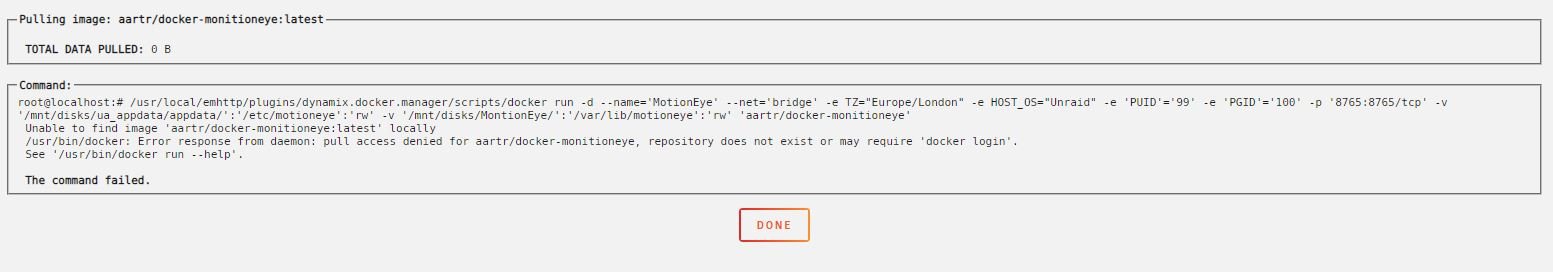

On ‎8‎/‎22‎/‎2019 at 7:20 PM, aartr said:
No, you'll have to go into the Unraid web interface, open the docker tab, click the motionEye icon and select "edit" from the dropdown. In this form find the "Repository" field and change "malvarez00/docker-motioneye" to "aartr/docker-monitioneye" and press apply. This should go totally seamless but I'd recommend backing up your "motionEye" folder inside of your appdata just to be safe.
I just tried that am I got the following error
PS. I have moved my config files off from the cache as I found this was eating through my SSD. so at the moment I am testing moment as slow working out the best solution to move them back, to prevent the SSD being eating through.
Hi Chris,
Sorry not sure what happened but I misspelled the repository name. It should be "aartr/docker-motioneye" instead of "aartr/docker-monitioneye". I'll update my post above to include the correct repo name as well.
@aartr  thanks for the link, at long last I have a working monition eye

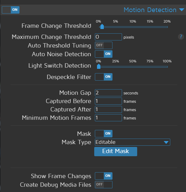

quick question. I have my montioneye running now for about 4 weeks and so far it is working as I would like it to do,  but there is on thing that I haven't worked out and I don't know if it is design thing.
that when it captors something it is only saving it in 9 sec chucks, or less which is a pain,
I have copy a screen shot of my settings in the hope that someone can see my mistake.
any ideals on why ?

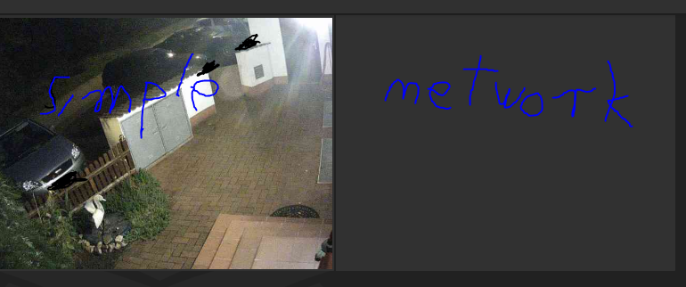

Dear all,
i have a issue that my cam isnt working anymore. When i use the Motioneye Docker and use a "Simple MJPEG Camera" i can see the Picture. But when i use "Network Camera" it dont stops loading the picture.  (the Network Cammera Mode is needed to have motion dedection)
i use this link for the Cammera: http://192.168.189.34/videostream.cgi?user=SafetyCam200&pwd=XXXXXXXXXXXXX
It worked one year flawless but now i dont see the picture in the cam anymore.
What i tryed to do until now:
Delete the Docker
Removed the Appdata Config Folder
Installed the Dock
Here  comparison between the modes.
Same Problem.
Has somebody an idea?

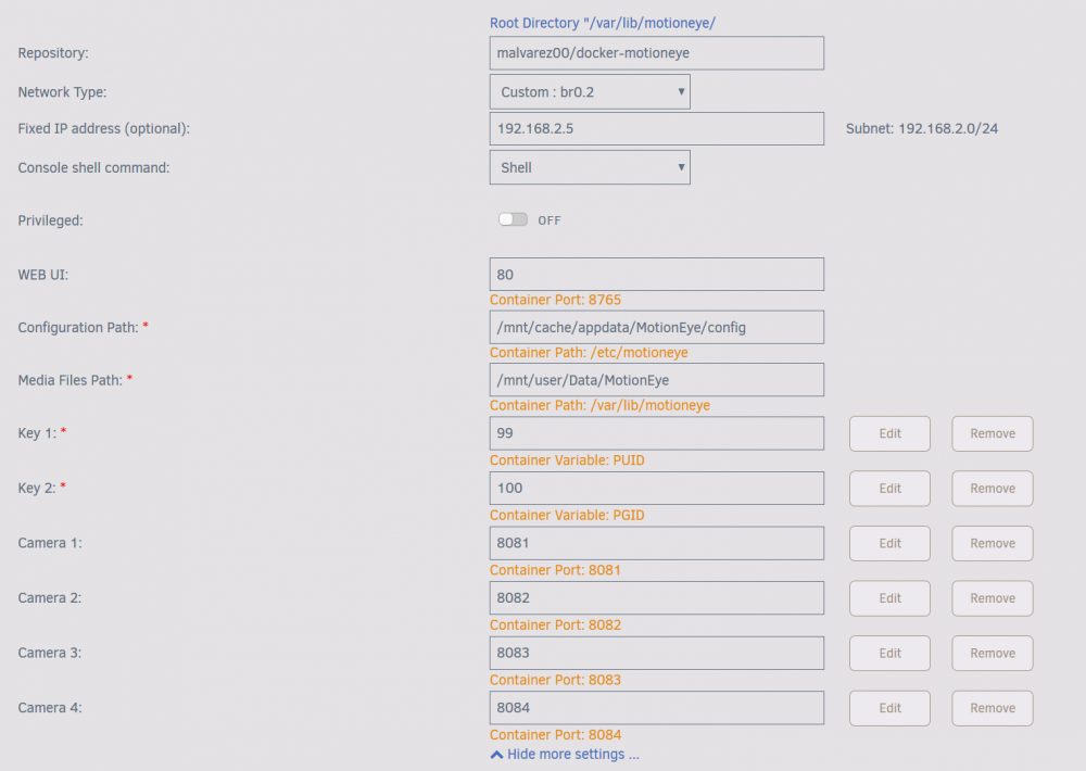

Here is a screenshot of my config:
image.thumb.png.b315c019c521eedc5f6506d3d7ed5c78.pngimageproxy.php?img=&key=e5eec7c5c933ca16imageproxy.php?img=&key=e5eec7c5c933ca16imageproxy.php?img=&key=e5eec7c5c933ca16
Edited by dave
Added screenshot
Is it possible to rollback? I noticed there aren't "Releases" in GitHub for this repo so I'm not sure if that will work!
