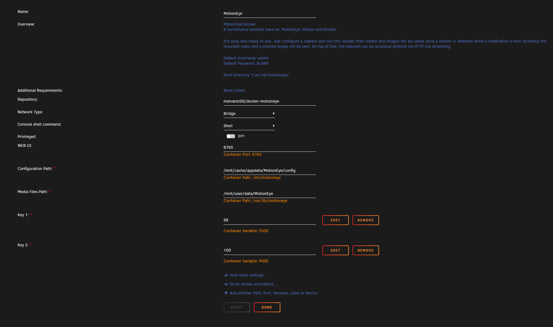

Hello, everyone,
I have the problem that Motioneye does not start after installation.
It always gives the error message "CRITICAL:root:failed to read settings from "/etc/motioneye/motioneye.conf": [Errno 2] No such file or directory: '/etc/motioneye/motioneye.conf'"
What do I do wrong or what could I do to make it work?
17 hours ago, siemershh said:
Hello, everyone,
Can you show the settings of your container?
Hi everyone,
currently running into the same error. Used the template as is.
I just checked there is no motioneye.conf in the configuration path, anyone can tell me where to get it from?
Many thanks
I remember also having a bad time making this container to work.
Oddly I managed to start it by using small caps in paths:

Doesn't install.
I'm on Unraid 6.12.13. It goes through the motions of installing but the appdata folder only contains an empty 'config' folder.
I've rechecked mapping to appdata and recording, tried removing and reinstalling.
