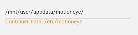

Why can't I start motioneye on my unraid device, it is fully installed but I can't start or run the application to configure my cameras.
see attached

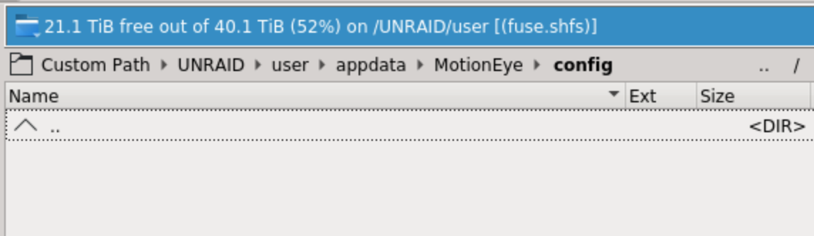

I have the same issue.
CRITICAL:root:failed to read settings from "/etc/motioneye/motioneye.conf": [Errno 2] No such file or directory: '/etc/motioneye/motioneye.conf'
Folder "config" is empty -> motioneye.conf not created.
Edited by elcapitano

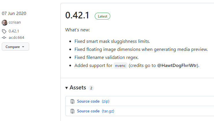

Any plan on getting this container (version 0.42)  updated with the last version 0.42.1 ?
