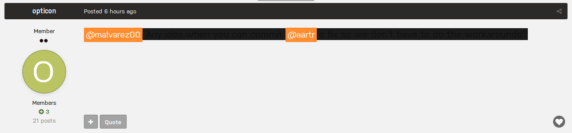

@malvarez00 Any idea when you can commit @aartr's fix so we don't have to do the workarounds?

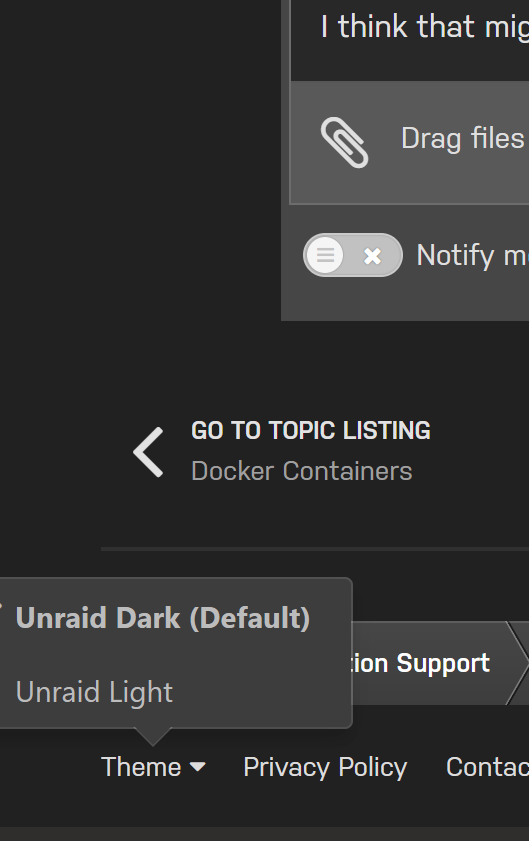

@opticon, your post is a little difficult to read, you may want to quit messing with font, color, or size.
I think that might be because your on the light theme? I've just left mine at the new default dark theme.
If there's a fix etc let me know. First time posting with this new forum so I don't know if it's a issue for everyone etc
Edited by opticon
It's definitely because of the theme difference. If you leave the text default and just type, it's fine. If you really MUST play with fonts, colors and sizes then I recommend you spend the time to switch back and forth between the themes to make sure it's visible for everyone. You can switch themes quickly at will, and preview how your post will appear. An unposted reply will seem to be gone when you switch, but as soon as you click reply it will come back.
