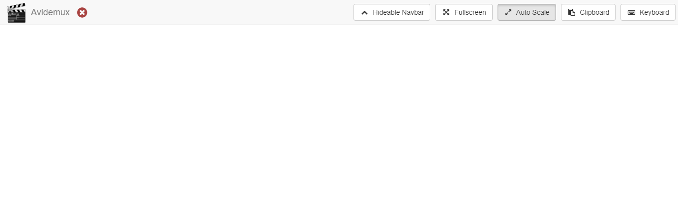

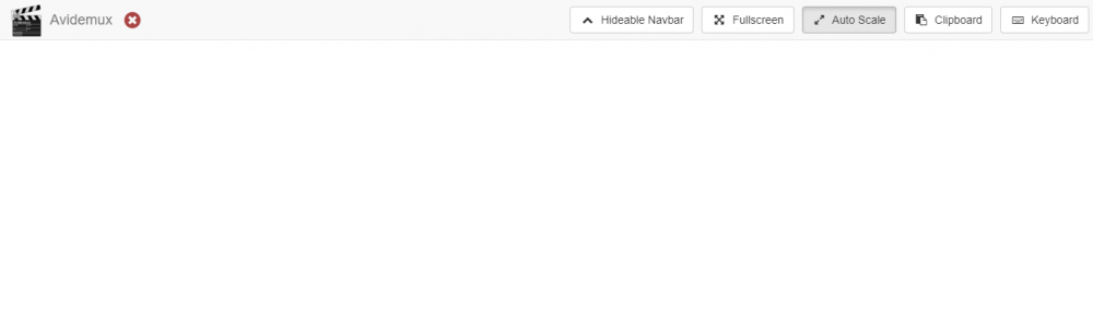

I can't seem to get this container to work. Going with the defaults, there are a number of erros in the log:
Connecting to the WebGUI gives me an empty page:
any ideas?
any ideas?
Can you try to clear your browser's cache?
yes, that seems to have fixed it, thanks!

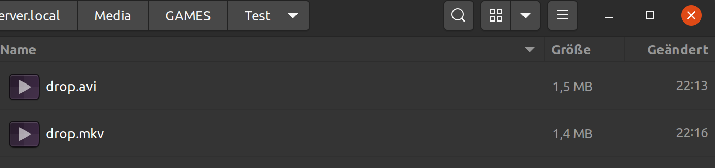

here a sample from cli to simple remux a file
/storage/GAMES/Test # avidemux3_cli --load drop.avi --nogui --audio-codec copy --video-codec copy --output-format MKV --save drop.m
kv --quit
--load loads the file
--nogui ...
--audio/video-codec copy ... we dont want to transcode, just remux
--output-format mkv ... if thats what u want
--save --- new filename here
Edited by alturismo

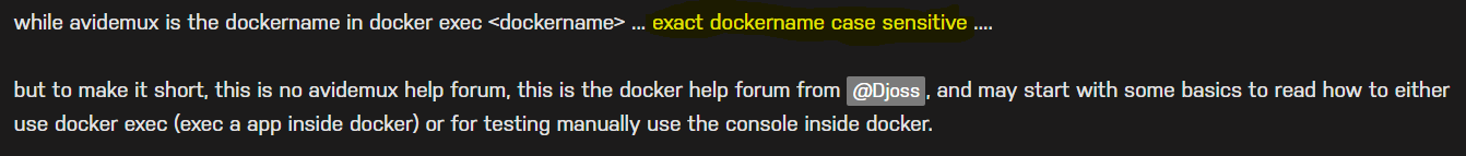

hmm  ok  so which part of the code is the executable  I tried
avidemux3_cli     and command is not found
same with the avidemux2  and  avidemux  from the sample code  what else do you need?  and I know I don't have a drop.avi    I just tried the code
root@Tower:~# avidemux3_cli
-bash: avidemux3_cli: command not found
root@Tower:~# avidemux3_cli --load drop.avi --nogui --audio-codec copy --video-codec copy --output-format MKV --save drop.m
k-bash: avidemux3_cli: command not found
vroot@Tower:~# kv --quit
-bash: kv: command not found
and dunno why when I copied and pasted your code    it did the kv --quit  should been part of the first part
Edited by comet424

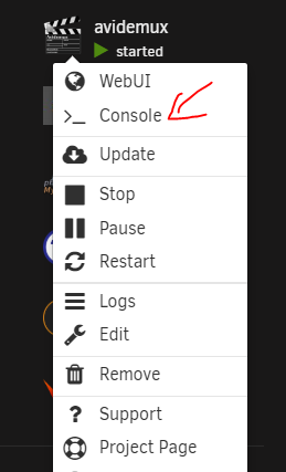

ok, as you are running this command from the unraid shell and not inside the docker ...
may start like this
Linux 4.19.107-Unraid.
Last login: Fri May  1 05:58:58 +0200 2020 on /dev/pts/3.
root@AlsServer:~# docker exec avidemux avidemux3_cli --help
 Command line possible arguments :
    --append, append video  (one arg )
    --audio-codec, set audio codec (copy|Lame|FDK_AAC|LavAC3|Opus|TwoLame|...)  (one arg )

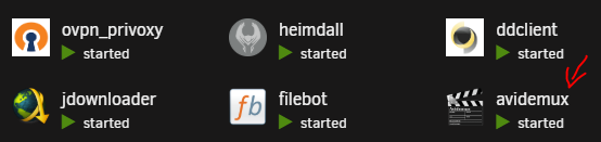

while avidemux is the dockername in docker exec <dockername> ... exact dockername case sensitive ....
but to make it short, this is no avidemux help forum, this is the docker help forum from @Djoss, and may start with some basics to read how to either use docker exec (exec a app inside docker) or for testing manually use the console inside docker.
Also, this was just a test sample for 1 file from cli, not to run through your folders and remux all ...
ok you lost me docker/help forum  etc..  the script would be command line not docker.. as there is no section in the avidemux docker settings to say add script..
I used the command line  to post your script as its a command line script      and then you do  chmod +x   to make it runnable...    if your supposed to be able to add script to the docker. then you need to go back 100 steps and say how do you add a script   other then running it from the command prompt.
as I don't know what your talking about now lol
and I tried your command above but doesn't work

about a script, i never said u have to add a script inside a docker, but BEFORE you start with a script u should test, and the easiest way would be directly in the shell from the docker, simple as this, click on the docker and then hit console
then u are "inside" the docker and can simple use avidemux3_cli directly ... without docker exec ....
if you dont know these things and differences u may rather start with basic tutorials here how to use docker commands, then you will see what i meant, as i dont know what your knowledge is etc ... its not a nice move to "lol" and point to things i didnt even mention.
and basically u are asking for avidemux functions, not about if this docker itself works or not (what this forum is about), that was my point why i mentioned this is not a avidemux forum, also not a avidemux subforum and may the author will say at some point this is not his app, he made the docker around it, just to clarify ... and i tried to point you directions how u can achieve what u want, but also here, i always said its a sample how a script could use avidemux todo what u want, but its not YOUR script for YOUR usecase, was just trying to help.
just copy/paste my command without understanding will sure lead in "no success" as we have different enviroments (pathes, etc ...) and diff usecases.
long story short, check what i mentioned, read the manuals ... and its pretty easy to get what you want by simply drop your files into your folder and run all auto or do it as 1 time job manually by exec some script ... if you need help with a script, there are subforums here and im sure u get help therefore there.
but also again, 1st i would try testing some avis from you manually if the result is what u want (remux and working).
either in the end by
docker exec <YOURDOCKERNAMEHERE> avidemux3_cli --load /YOUR/MOUNTED/PATH/yourfile.avi ............. --quit
(and that would also be your user scripts script in the end ...)
or inside the shell as described above
cd /YOUR/MOUNTED/PATH/
avidemux3_cli --load ............. --quit
