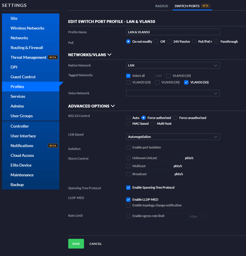

  • I do have a unifi switch and by default it trunks all vlans to all ports.  I'll take some screenshots to illustrate where i'm at   **edit** I basically nuked all the routes and started from

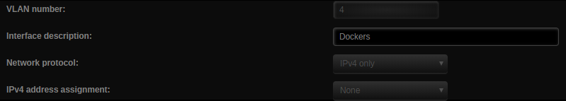

    Installed 6.4.1 and set VLAN interface to no IP for unRAID.  Then configured docker with the appropriate network.  Everything looks good.  The UniFi docker container is in a separate VLAN and unRAID i
  • This is by design. What you should do is to not assign an IP to br0.5 interface under unRAID Network Settings, then proceed to setup the interface for docker custom network. It will then wor

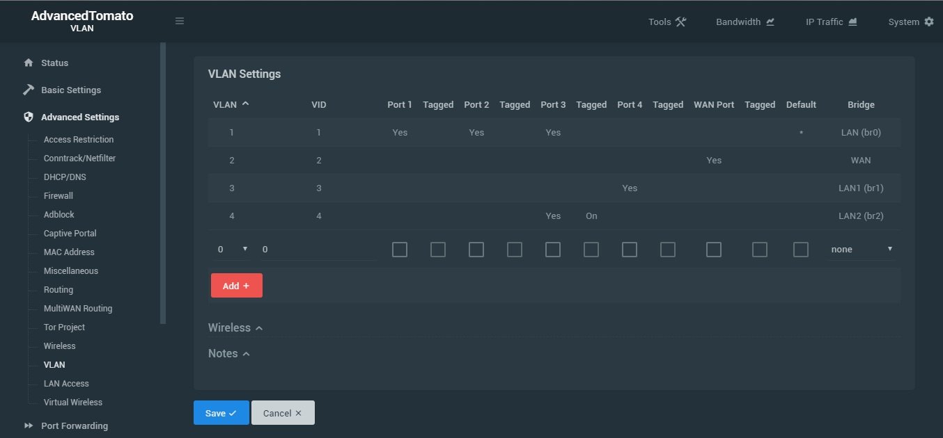

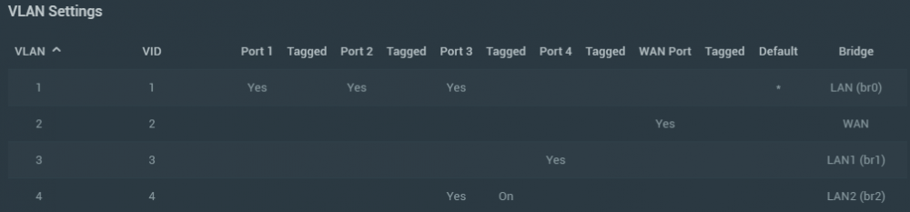

@bonienl one last question: I'm trying to configure my router, however i'm having trouble trying to find the appropriate options in the webui.

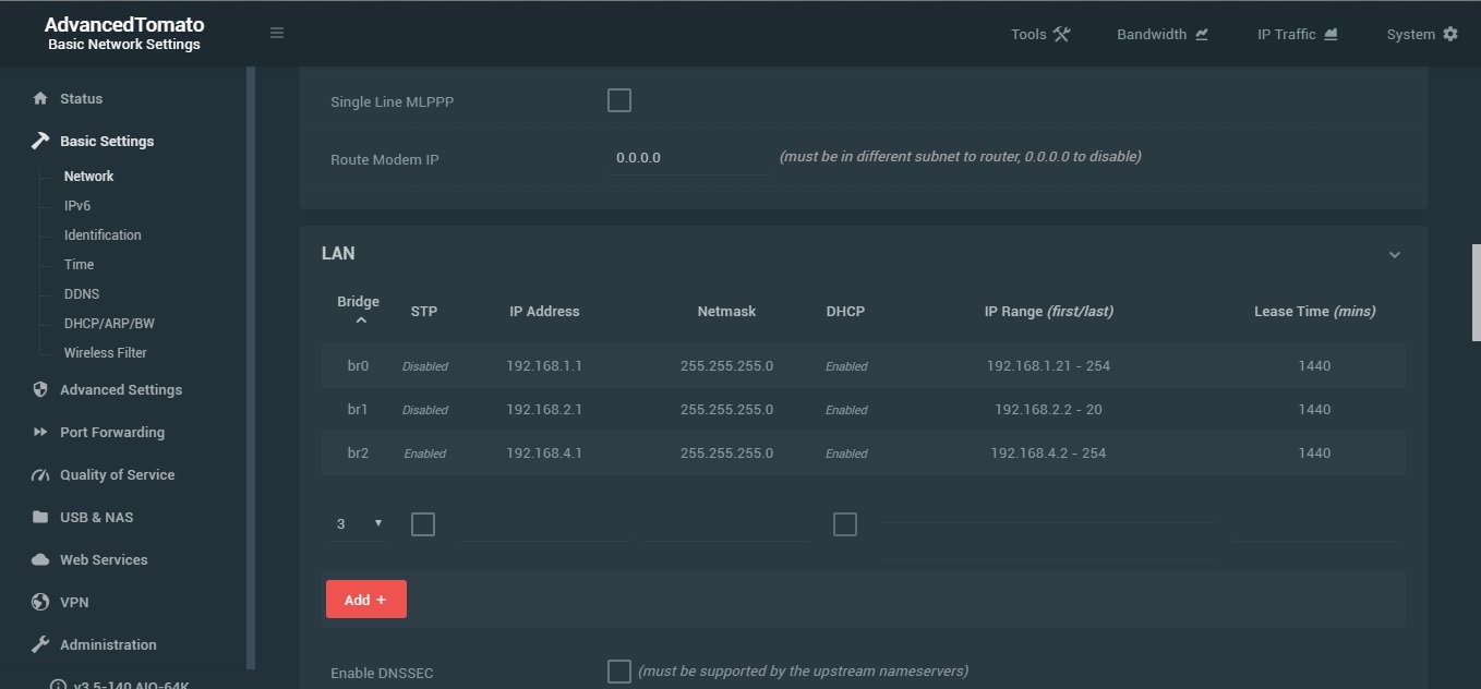

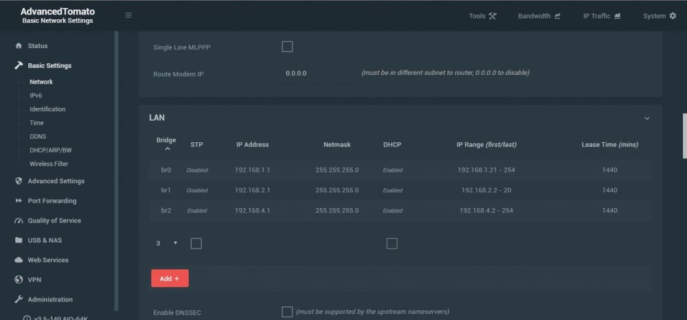

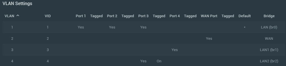

As mentioned previously, i'm using a Netgear R7000 running AdvancedTomato firmware. There's network and VLAN menus but i'm not sure about assigning certain networks to a VLAN ID.
I've set up port 3 (which is connected to the switch with unraid), as a tagged VLAN4 port. Is this correct? Although further advanced options as per your tutorial aren't available under VLAN.
I'm sure the option is available somewhere, the verbiage is probably just different, and nestled in another section somewhere.
Would you have any idea how to set this up, or similar setup instructions elsewhere?
It looks correct, but

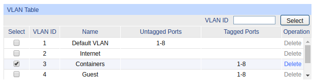

make sure to set the SG108E to understand that there is VLAN4 and that it should be tagged on the pertinent interfaces,

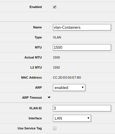

I'm using a mikrotik router, so I define the VLAN subinterface:
and assign it a subnet 10.0.3.1/24

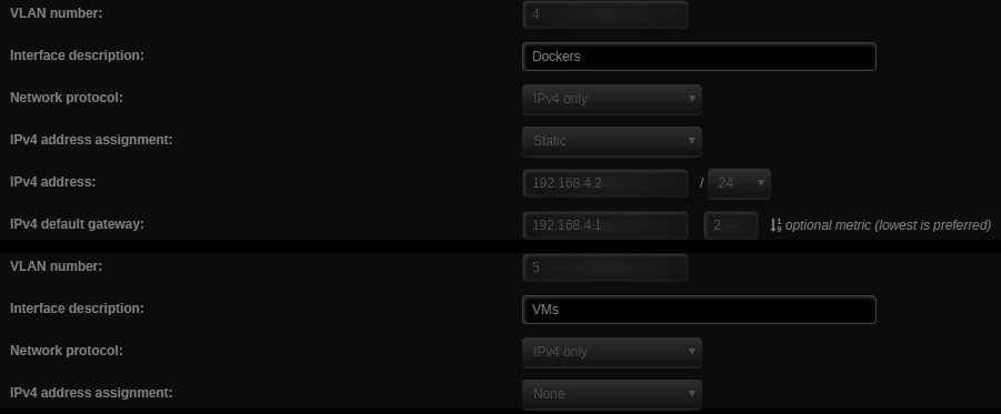

My VLAN table on my switch TP-Link SG2008 is like this:
And the docker network:
You need at least select the ports to which unRAID and your router are connected as "tagged" on your switch.
As explained in the excellent story of @ken-ji tagging those ports creates a separate communication from unRAID to router. AKA an isolated network.
On your router configuration of port 3 looks alright. It allows both untagged traffic (br0) and tagged VLAN 4 traffic (br2).
You have correctly defined br0 and br2 as different networks and to let them talk to each other, traffic is 'routed' by your router, which allows a container (192.168.4.x) to talk to the server (192.168.1.x) unless you have defined firewall rules on your router which prevents or limits this communication.

Now for the final piece of the puzzle though, the router IP on VLAN4 is now 192.168.4.1 (192.168.1.1 on br0), I put that in the gateway IP in unraid for br0.4. The docker has no internet connection. Using Sonarr as an example, i get "no route to host" errors in the log.
Is there something I need to do specifically to allow internet access to the br0.4 VLAN? I've tried setting the gateway to both 192.168.4.1 and 1.1.

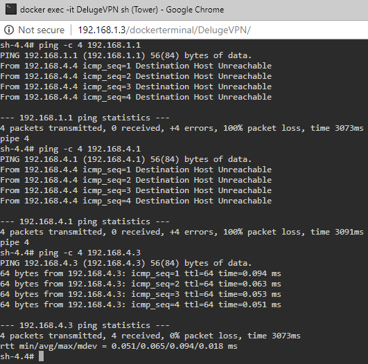

Open the console of the docker from the WebUI
try pinging the router ip from there.
also check the IP of the docker from there with
ip addr
if the ping is successful, then check your router rules as it might not be routing properly
Edited by ken-ji
ip addr

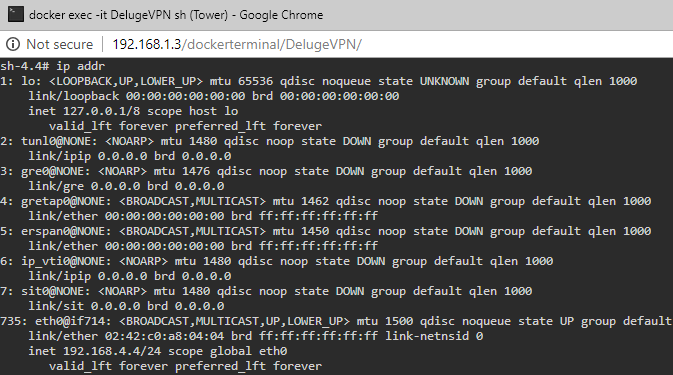

I'm not familiar with Linux syntax in unraid, how do you ping 192.168.4.1?
ping -c 4 192.168.4.1
and also grab the output of
ip addr
ok. that's one really bare docker. I'll try to spin it up and have a look later...
I've had the same results on 2 other dockers, running on both the VLAN and bridge. Although DelugeVPN gave a ping result, so I transferred that to the VLAN and got the below results. Can ping other dockers on the VLAN but not the host or gateway. Additionally, the ipp addr are below.
image.png.f8d8b9543a9bcc98557f0c35783d205b.pngimage.png.b8c744cd6fe7408a8fdde3a4bc4fcd48.png
Edited by Boo-urns
Not sure why you can't ping/connect to the gateway yet. but you should not assign an IP to the VLAN interface of unRAID

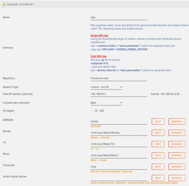

Within the docker settings, i've entered the following for br0.4.
I get correct IP assignment upon starting the dockers (and the network shows up as a choice within the docker), however I get the same problem, no internet connection from the dockers/no connection to host.

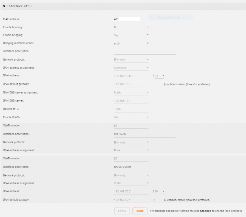

FYI @ken-ji I found a post where you said to remove the IP addresses from the Interfaces.  Did this and it worked straight away.
Thanks!

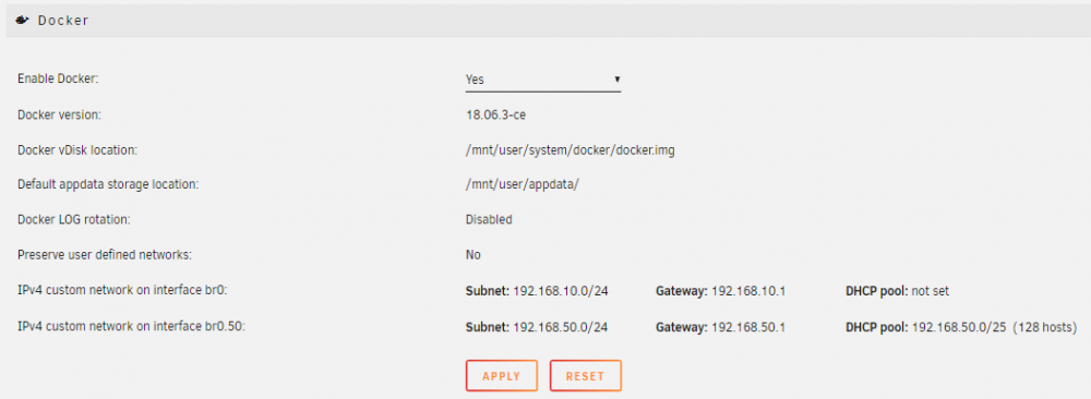

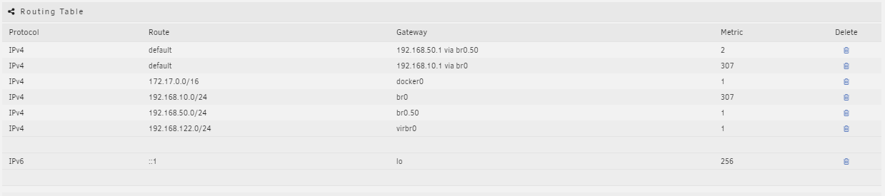

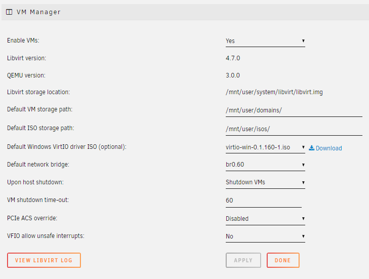

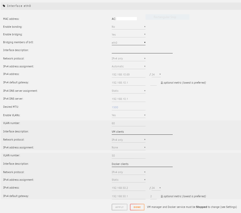

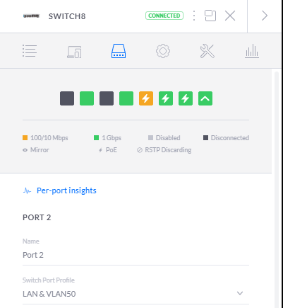

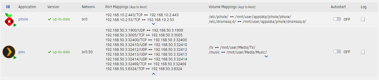

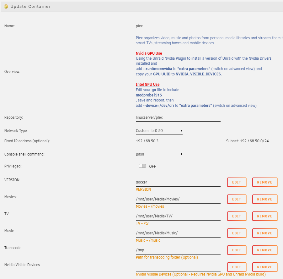

has something changed for 6.6.7? I tried this tonight but lost WebUI access (and all access) to my Plex Container. I've been running Plex just fine.  From my secure LAN (VLAN10) desktop I can't ping Plex (192.168.50.3) or Docker (192.168.50.2) but I can ping the unRAID server (192.168.10.69). My router firewall rules are set up so I can ping any subnet from VLAN10. I have an EdgerouterX.
Here is my setup. Please let me know what I'm doing wrong.
unRAID is connected to switch port 2.
Edited by adminmat
