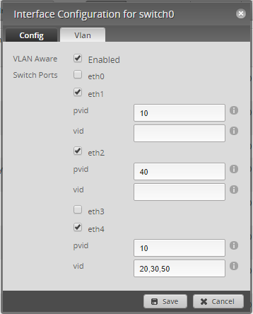

Update!!! Got it working. I forgot to add the VLAN number to the "vid" field on the Edgerouter's switch0 for the Switch's trunk port. As soon as I added 50 the Plex WebUI lit up. 🤘 Victory!
I can also confirm that I CAN ping from my PC on VLAN10 to the Plex Container on VLAN50.

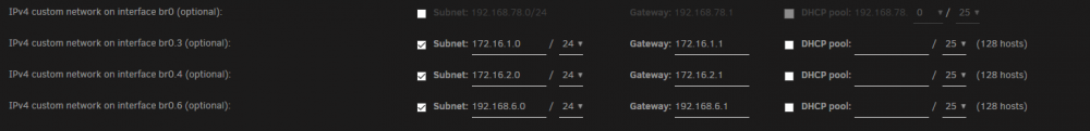

On 1/3/2020 at 3:51 PM, Weavus said:
Having trouble getting br0.5 showing up in the Docker 'Network Type' dropdown. I only see br0.
Can you post a screenshot of your network settings and a screenshot of your Docker settings (docker service stopped and advanced view)
As requested. Thanks.
FireShot Capture 002 - Gargantua_DockerSettings_ - 4a4125231f62863be9f65f3db7b8116adc218f5b.unraid.net.png
FireShot Capture 001 - Gargantua_NetworkSettings_ - 4a4125231f62863be9f65f3db7b8116adc218f5b.unraid.net.png

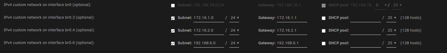

On 1/3/2020 at 4:37 PM, Weavus said:
I have the VLAN listed in my Docker settings as shown above and br0.5 is listed on the Docker settings page. However Docker network ls or the 'Network Type' dropdown on container templates is not showing it.
Same here :(
Any progress?
@noski @NKnusperer Did you add the network to the Docker settings? Make sure to have the array stopped and to toggle the Advanced view in the upper right corner.
RESOLVED !
The problem was that I entered the wrong Gateway IP in the Docker settings.
This is correct:
Subnet: 192.168.50.0/24
Gateway: 192.168.50.1
However I used 192.168.1.1 as Gateway.
Edited by NKnusperer
