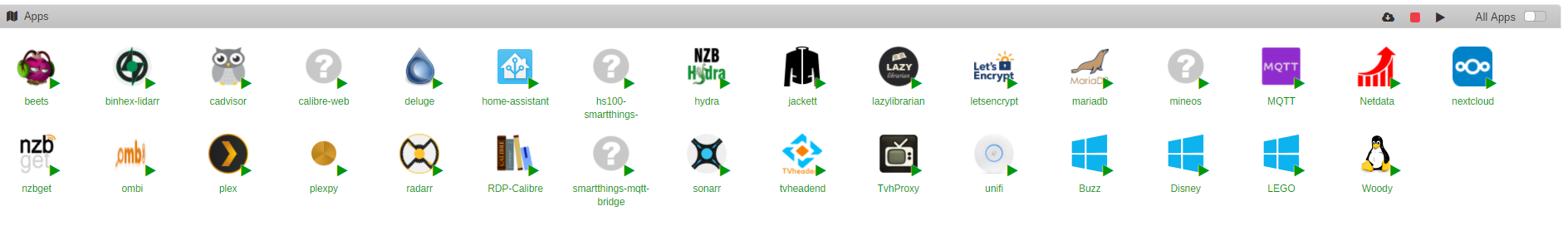

I think I'm going to try and fix it coming the other way - isolate my dockers, rather than take cores away from multi-tasking:
5a550326595d6_FireShotCapture30-Highlander_Dashboard_-https___1d087a25aac48109ee9a15217a.thumb.png.226ebe1808e75db7d95c2a7e6951c69b.png
I've just disabled all my dockers and watched a 1080P youtube video without any problems.  I'm going to try and locate the docker culprit(s) and isolate their cores, so they don't crossover with the cores used by my VM, Buzz (others are used by my kids)
