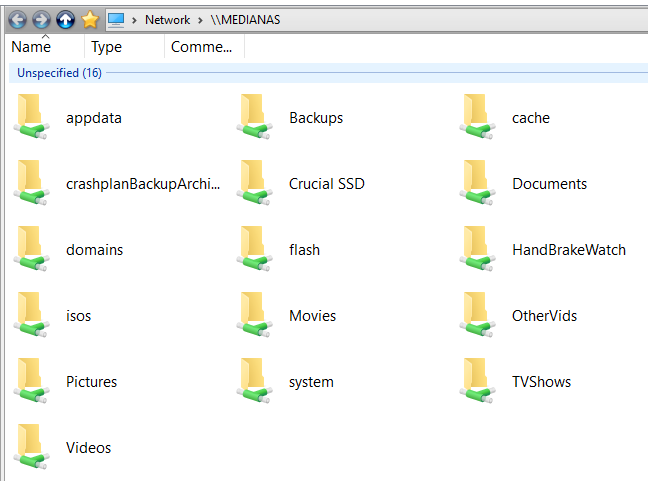

It's important to realize that /mnt/user/Movies isn't a single place.  It's a sort of "smart" directory listing.  Here's the wiki reference, it's definitely worth a read through.
Briefly, though, when you browse your server from your PC, you will see that " Movies" is available since you created it as a user share.  When you mount it as a folder, you will be accessing /mnt/user/Movies.  But like I said, that's not a single place.  It's actually many places:
  • /mnt/cache/Movies
  • /mnt/disk1/Movies
  • /mnt/disk2/Movies
  • /mnt/disk3/Movies
  • etc
When you copy a file from your PC to the "Movies" folder on your server, unRAID will pick one of those places to put the file.  If Movies is set to use cache, it will place the file in /mnt/cache/Movies.  Later "mover" will move the file from /mnt/cache/Movies to, let's say, /mnt/disk2/Movies.  You never have to worry about that.  By accessing the virtual directory /mnt/user/Movies, unRAID takes care of aggregating all those physical places into a single logical overall view for you - all nicely packaged into the share called "Movies".

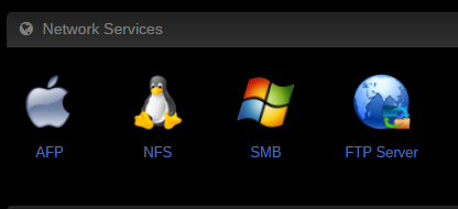

How do you see unraid  movies drive on your computer so you can add more movies to it?
unRAID shares that are exported as Public shares will show up as network shares when browsing your server.
You'll also have to make sure the appropriate network service(s) for your client(s) are enabled in Settings.
