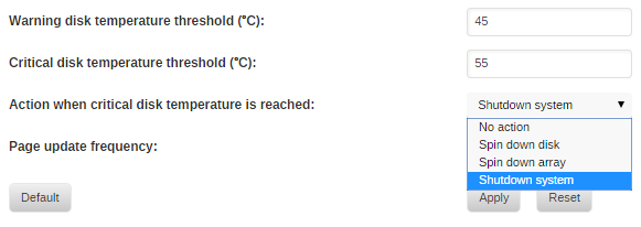

I've asked for this since unRAID 4.4 or so. I think I had an extra setting, and if the temp got to there then it would give up any attempt at a clean shutdown and do its level best to just power down (i.e, "pull" the power button in for 5 seconds :))
Auto shutdown would help if HVAC failed and ambient got crazy hot, or fan broke, or fire, or who knows what. You'd just need a way to override it in case of a sensor failure so the server would stay booted!
I had forgotten that @bonienlshowed work in progress for that on that request thread, but he probably forgot about it? ;)
When I jumped on unRAID, version 5 was so lacking on supervision that I did build a supervisor monitor that I have been running since then. But that was a c++ application with no GUI for configuration. It collected all SMART + fans + temps + voltages + volume storage levels + CPU% and a couple of other metrics and fed to an external MQTT broker but with the ability to do a shutdown if in real panic. I've had a real bad lesson costing significant $$$ with a system where the PSU started to oscillate the output voltages when it got warm.
Shutdown would be atleast a way to stop all this without a atomic explosion.

I hope the will implement that feature, or maybe add it to dynamix systems temp / fan plugin.

When I wrote tons and tons of data to from my SSD I would get periodic Over Temp messages from unRAID. To the point I was at dinner and was freaking out until I got home to check.
You have to remember the default settings in unRAID are just that. Just defaults. I took some time and realized the temps for my drives was way off and adjusted them to allow for my heat since every drive manufacturer sets Normal/High/Low thresholds. As well I took a 5th look at my SSD and realized it wasn't getting the best air flow in my case and corrected that too.
In the end everything was fine, but getting some messages from unRAID made me take a second, third look heck even 5th like I said to make sure things are where they should be. If something had of shut my system down because of a temp problem I could of lost some data simply because of a freak out that really wasn't anything.
Don't get me wrong I'm not saying there shouldn't be something built in. I'm just saying we should check our own systems to make sure we are sitting in the Norm or out of the Norm.
