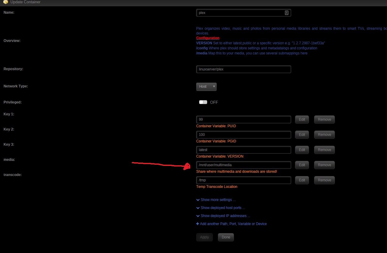

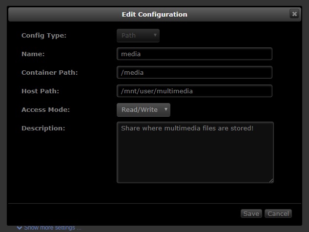

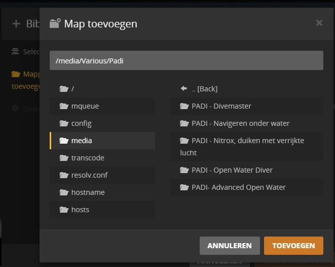

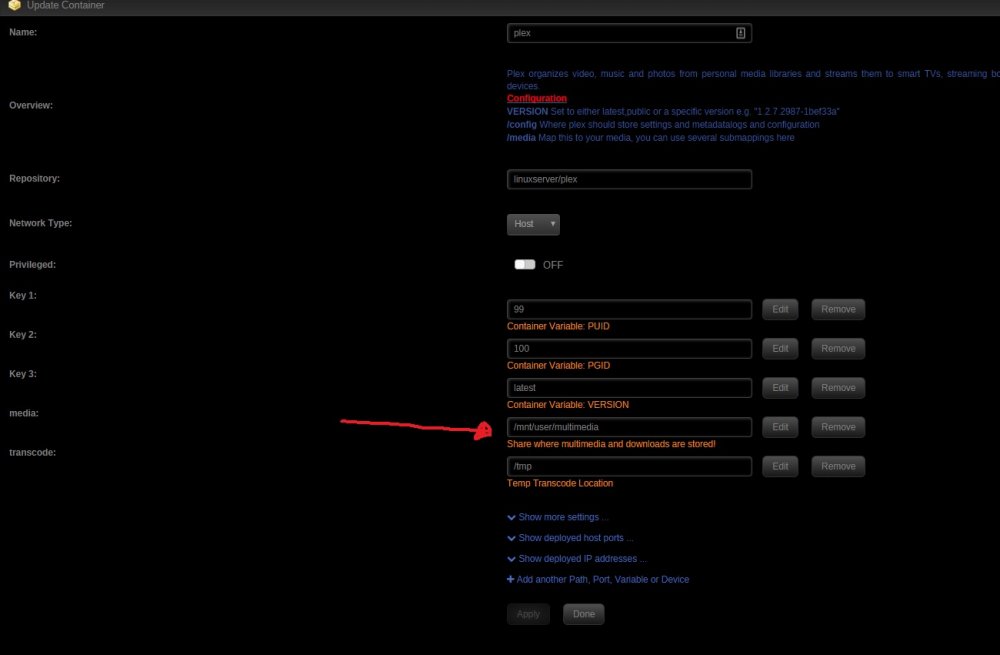

January 29, 20188 yr @codo1234 Added some screen shots, first set the config correct, and then add a new library in plex. Else create some screenshots, so we can check if you are setting it correct. Edited January 29, 20188 yr by SiNtEnEl
