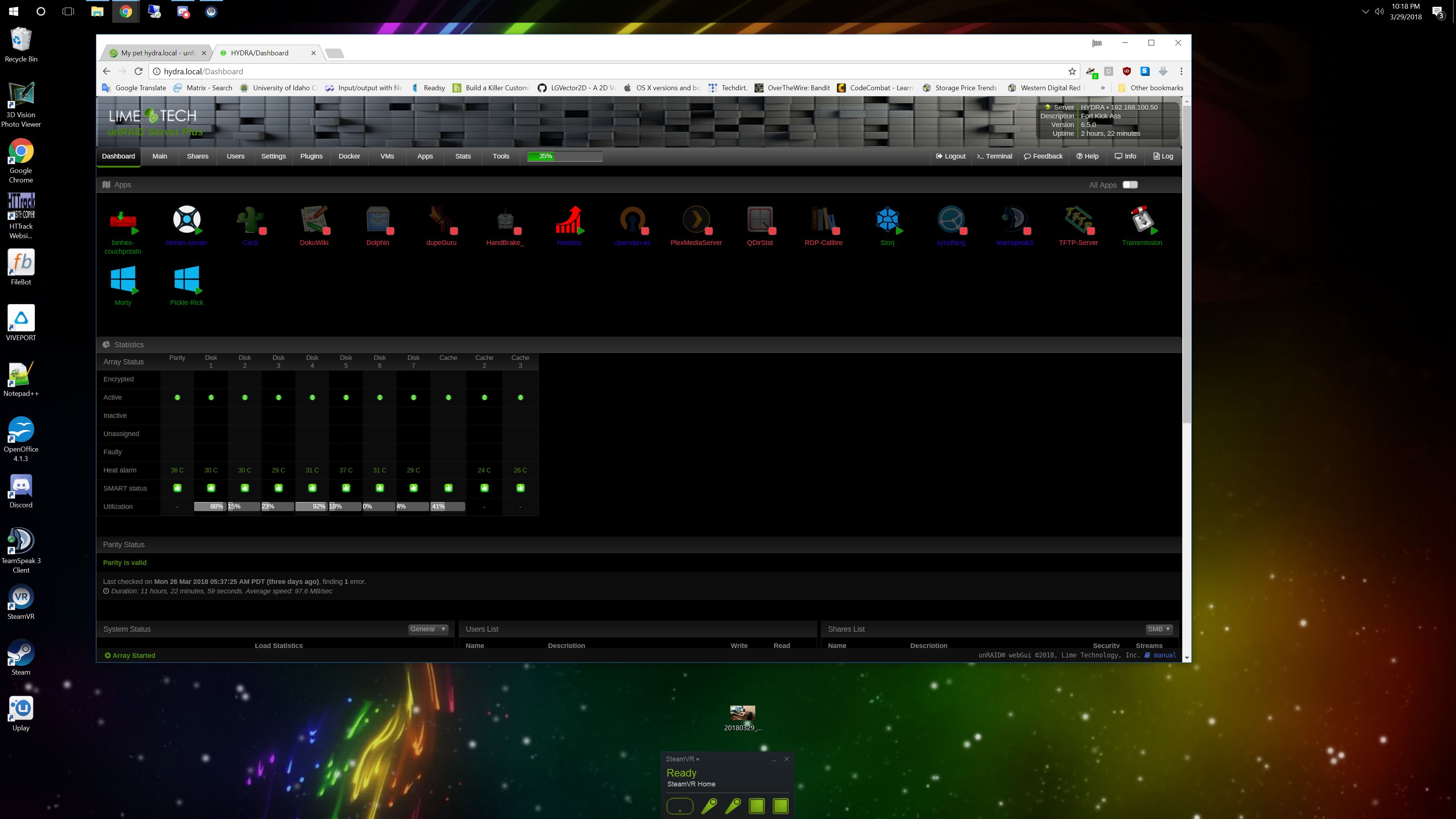

My pet hydra.local

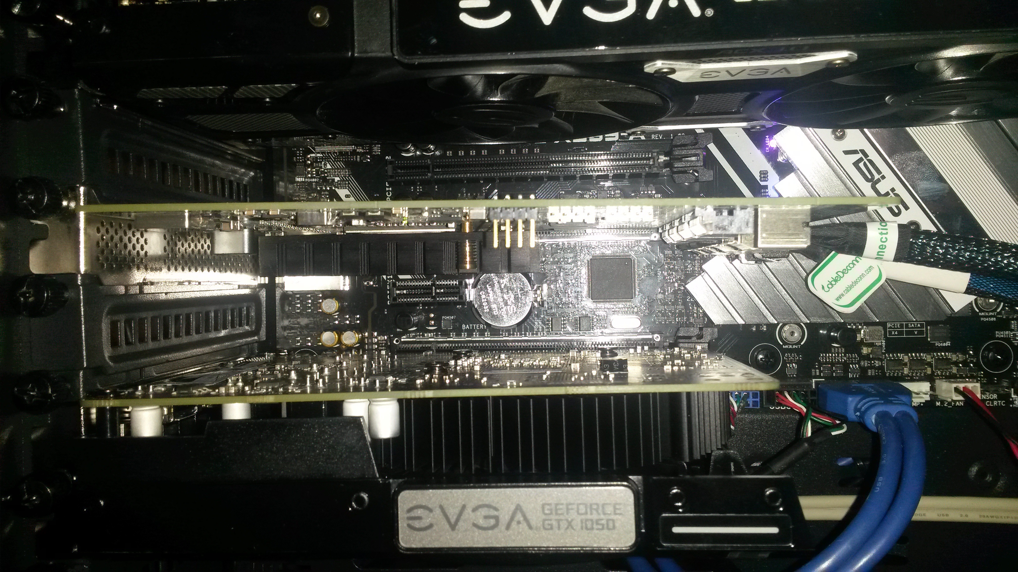

Simple experiment, I moved my HBA card and GTX1050 around in slots, just to make sure that wasn't funky. Works perfectly, as it bloody should! HA. At this point the real test would be to move the HBA up one slot, against the GTX1070, and then a third video card in the HBA's current slot.
 Also updated onto 6.5.0-rc6 to look at the vm webgui improvements. I like the new version of noVNC. The added vbios rom file entry -- VERY NICE! :D
EDIT: Total fopa, made two changes at once. It's happened three times now getting intermittent audio distortions in VM1. No errors in unRAID logs so peculiar -- going to have to watch that for a while.
EDIT2: 3-16-2018: Haven't heard the audio distortions since EDIT1, odd, but I'll take it.

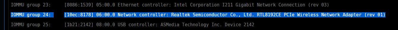

Also asked if the PCIe-1x slot had it's own IOMMU group, tried to find out using an e-sata card ... with a Marvel chip set. DOH!  Seg faulted emhttp so hard. Thought I had recorded the results, while I was in the fault, but I can't find output (which I thought I saved to the flash drive). I'll have to try the experiment again later.
Yes, the PCIe-1x slot has it's own IOMMU group -- FYI, for those who are keeping score at home.
root@HYDRA:~# lspci | grep -i wire
06:00.0 Network controller: Realtek Semiconductor Co., Ltd. RTL8192CE PCIe Wireless Network Adapter (rev 01)
IOMMU group 24:	[10ec:8178] 06:00.0 Network controller: Realtek Semiconductor Co., Ltd. RTL8192CE PCIe Wireless Network Adapter (rev 01)
Successfully able to provision the card to a VM; seen device in Device Manager with driver; and saw my wifi network, but didn't really test the card as it's a known defective card (it was the only hardware I could find, and borrow, without spending. Not a great test card, but it checked and proved for the functionality in question, so good enough.iommu_pcie1x.thumb.JPG.35491a0386350fb60cecceed19d1dd12.JPG

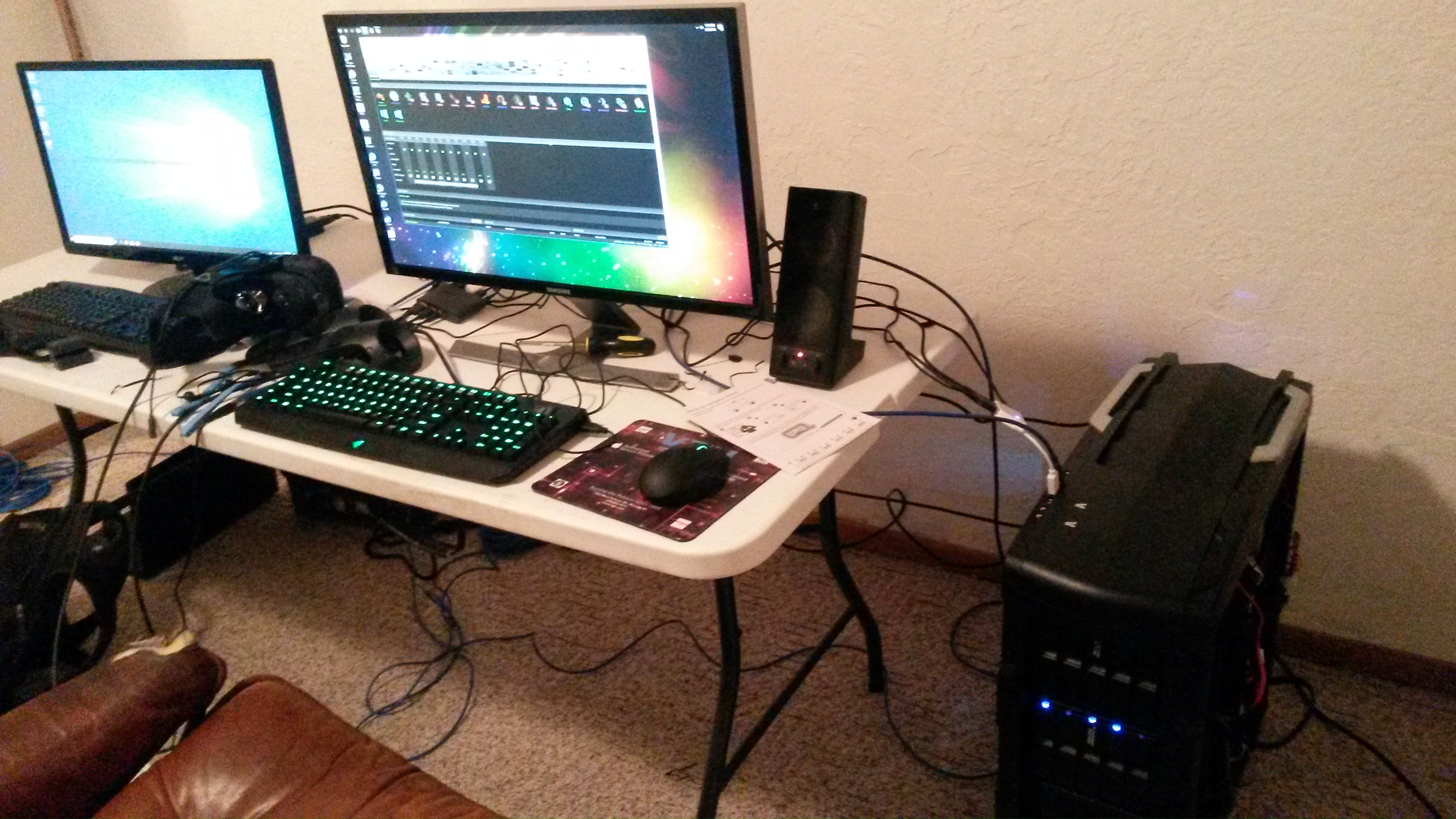

However the VIVE did go down, and I found myself in this state:  Jolly candy-like button
Standard shipping and few days of life later; computer and kuality desk moved to larger room.  Only two unRAID tasks required for working VR: passed through an USB3.0 port(s) to VM for PnP setup of drivers in Windows; second, ran out of space on my VM image file, was 35GB, ran (with vm off):
qemu-img resize /mnt/cache/domains/MyVM/vdisk1.img 50G
After restarting VM just had to go into Windows Disk Manager and resize the NTFS volume.  Now to just clean up the house for niece and nephew - I'm the cool uncle I let them play video games, and they don't have to share. ;)  As far as the VIVE goes, I understand the screen-door effect I've read and heard elsewhere.  I like it, but wide angle peripheral view was blurry for me, granted its optics still need play with depth for optimal focal point.
Next project will be to work on running the head-set cable along the ceiling pulley or lanyards.
Very nice setup... But the cool Uncle definitely needs to become the cool Cable-Managed Uncle :-D
HA! Yeah things got messy after I had to move the two stations around because the 15' DP cable I bought was bad (video artifacts), and I really wanted to get the system going so mess was made to support use of 5' DP cable I found in a closet.  And if you think the desk is messy, I'm afraid to show off the house. :\ lol  Uncle Cloud has Canonball-run of spring cleaning to do.

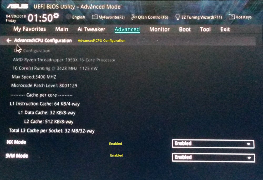

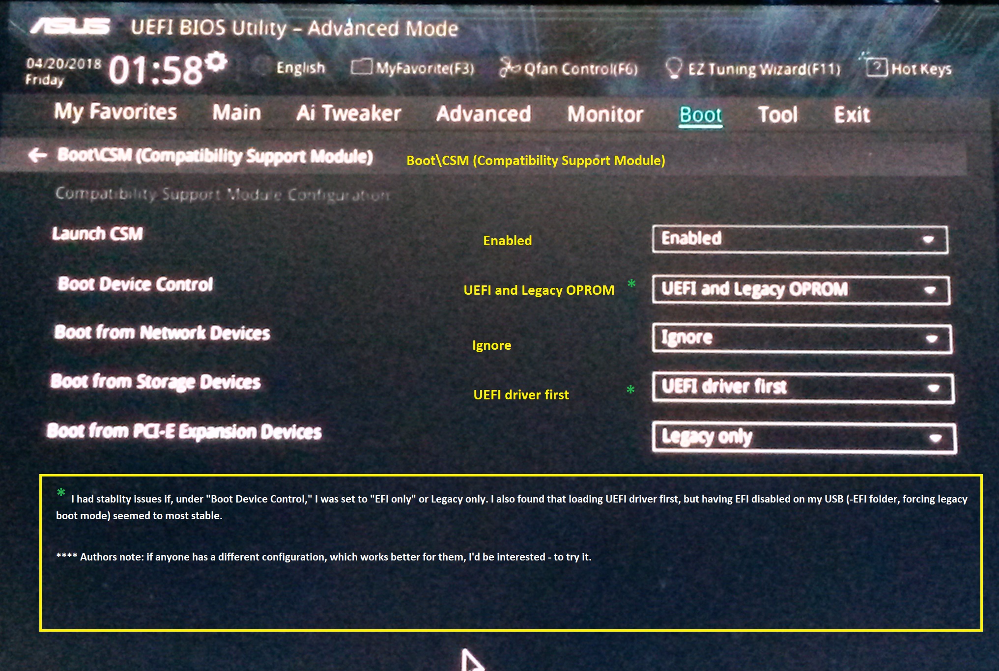

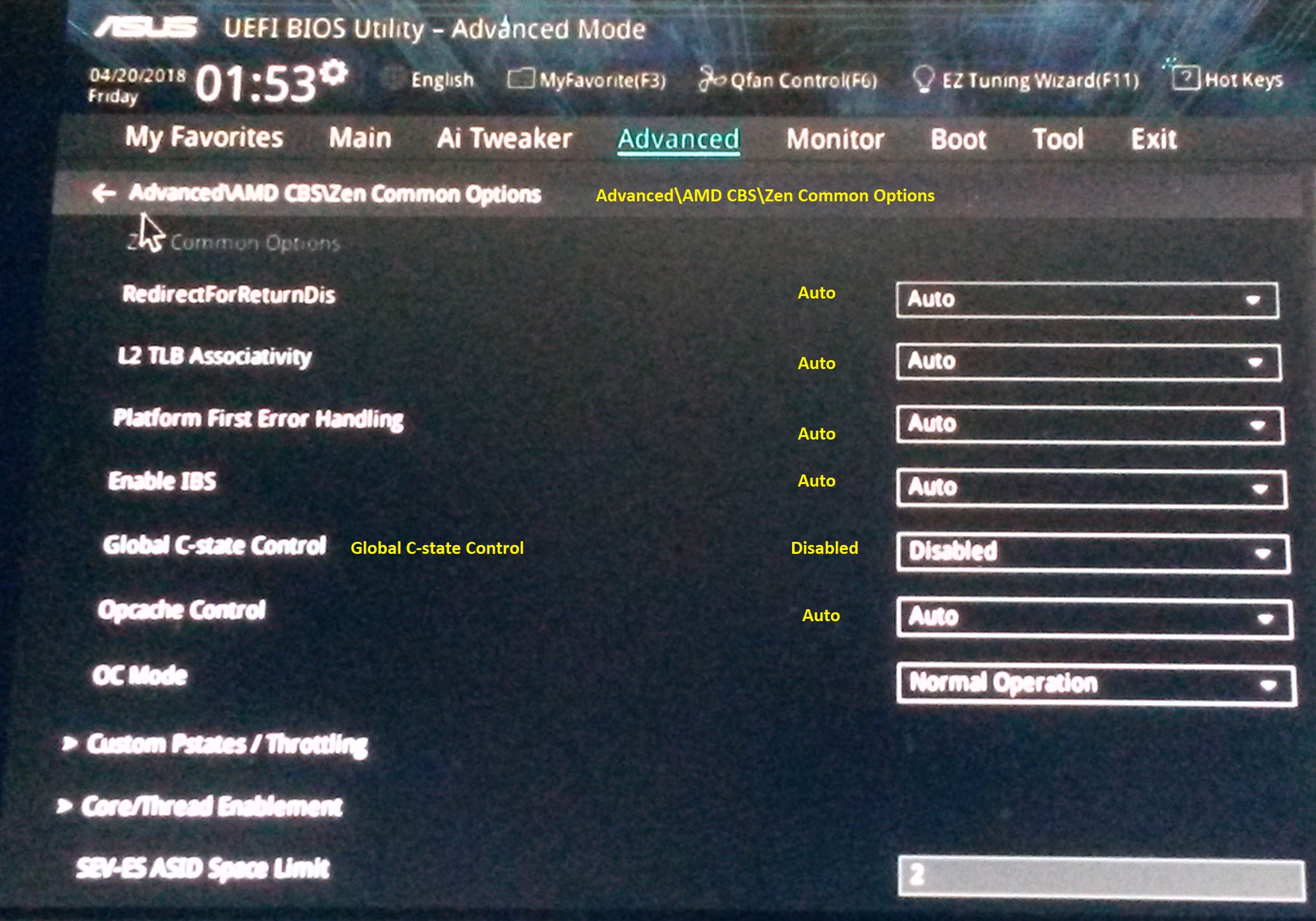

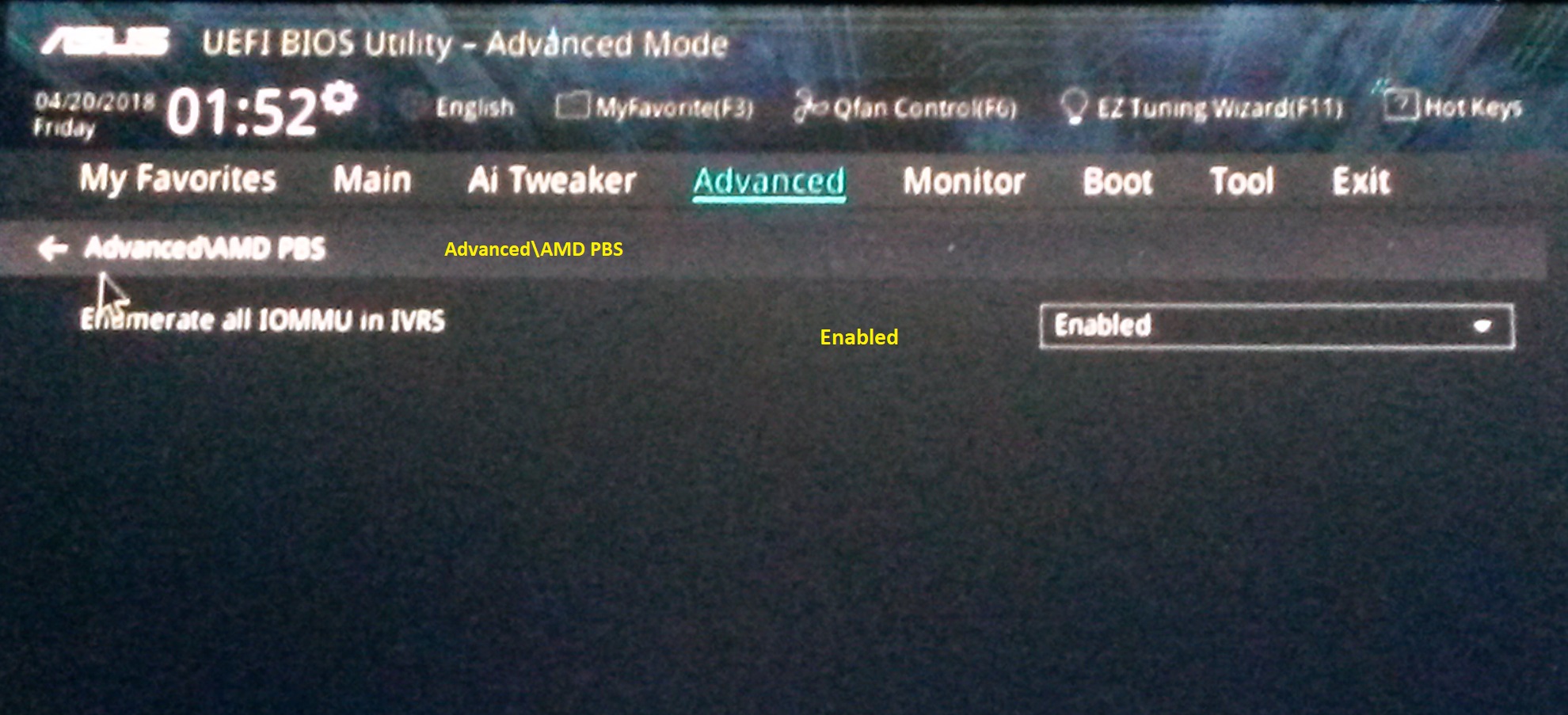

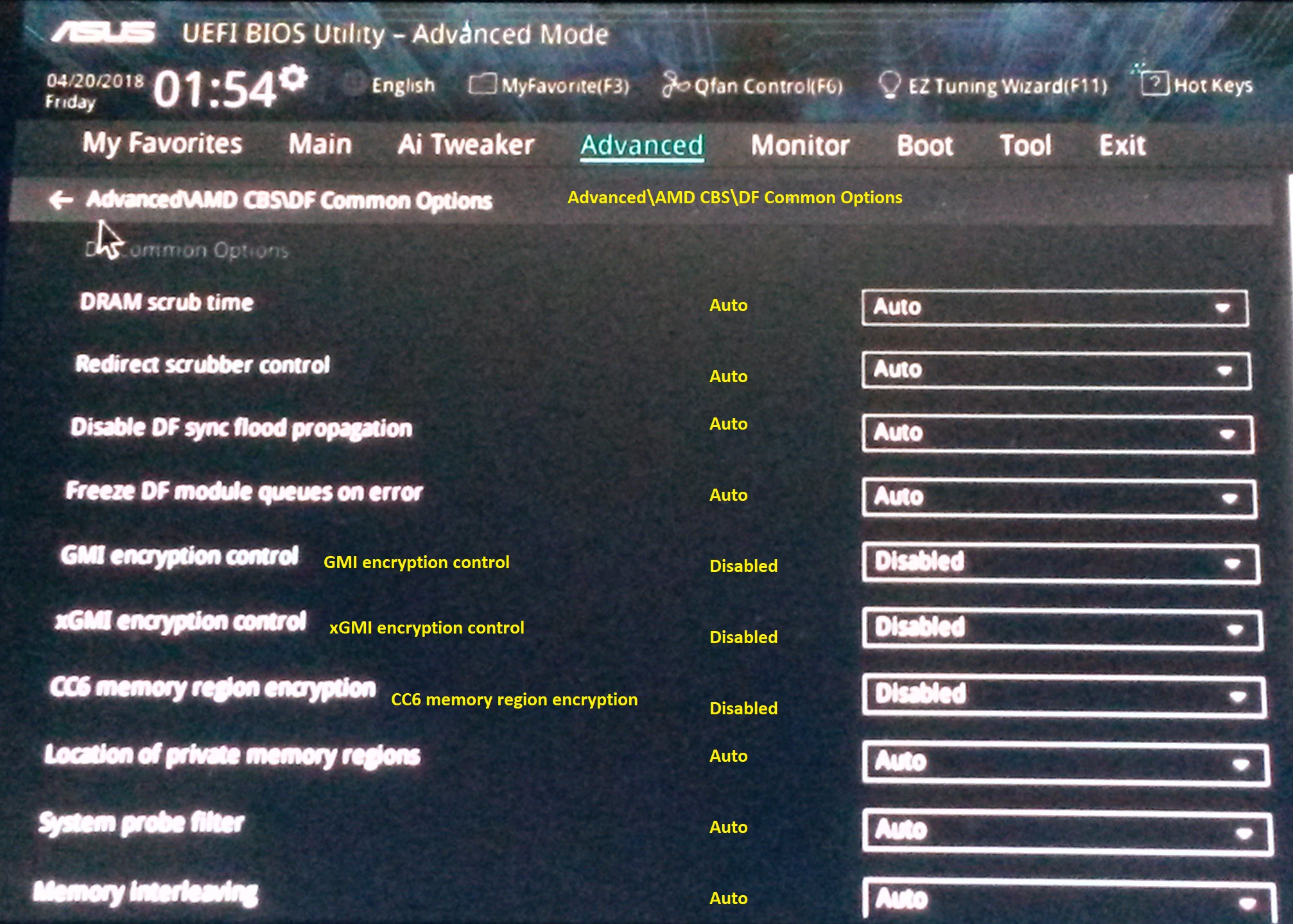

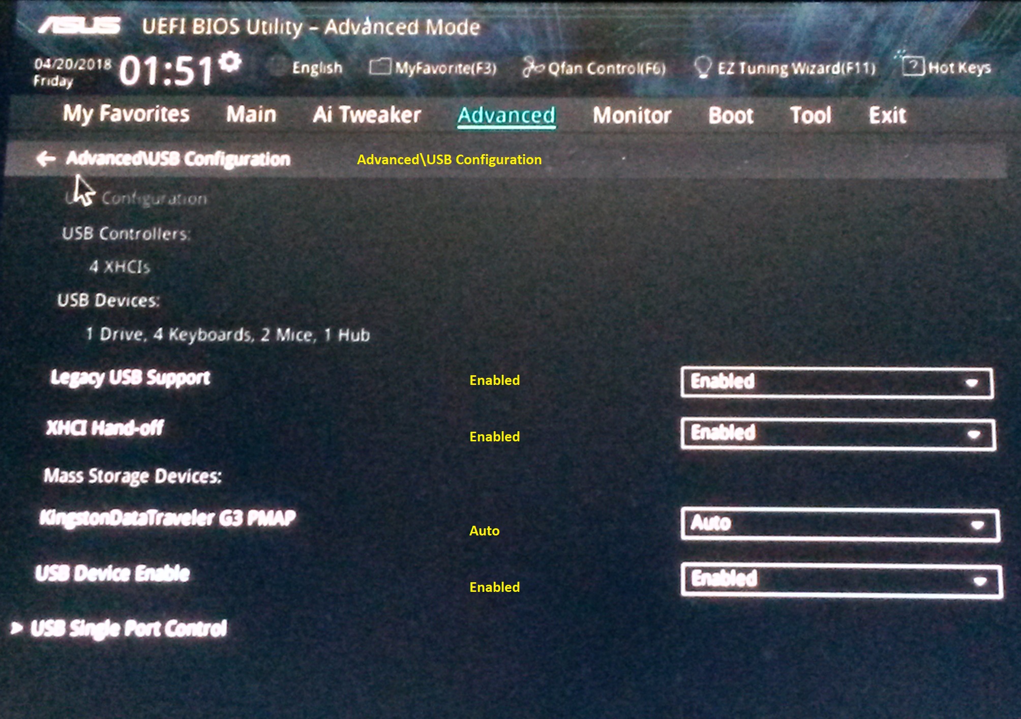

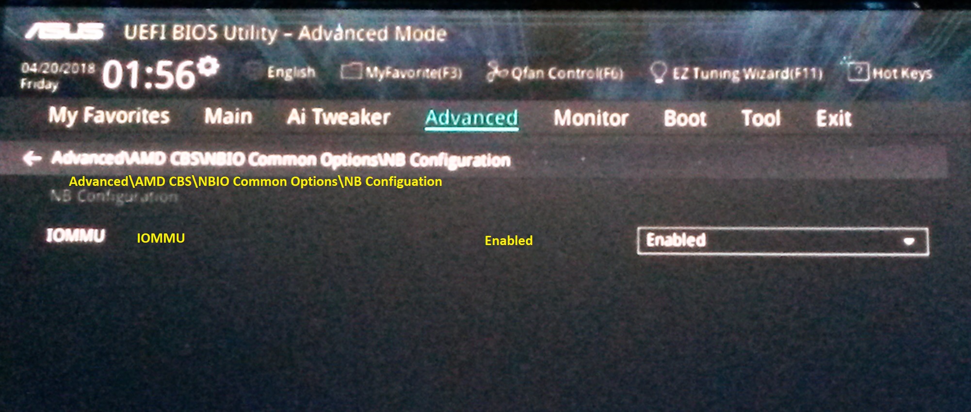

Sorry about the file sizes, the pictures are already grainy and I don't have any good imag20180419_185410.thumb.jpg.0bd847191fee7d744811d9aedb0b0436.jpg20180419_185324.thumb.jpg.e4f7ea9803ec1bc0c532b385fcf61ce7.jpg20180419_185216.thumb.jpg.ec9749fafd96794ccd147fe24323f9ce.jpg20180419_185140.thumb.jpg.a7b83bcced390075a25de218cde67853.jpg20180419_185044.thumb.jpg.c36c37d2b68e671300621860cc616530.jpg20180419_185644.thumb.jpg.3df244343e899623eec21e16ef996b78.jpg20180419_185808.thumb.jpg.c17cdfe97ec95e2124a66d6704275f95.jpge tools presently.
I forgot the syslinux I'll put that on tonight. Not that much in it for TR is all I've done, and again, I'm not 100% sure I really needed this line -- I added it after reading the forums, but my system seemed fine to me at the time.

more info - what's in my go file

:::: place holder for my bios info tonight ::::
I have to plan my shutdowns due to my uses :)
only things different than jcloud is I run 32gb ram for now (crucial), and a liqtech 280 liquid cooler in a norco 16bay case.
4.0ghz stable at 28o idle and 36-42o load (2 VM's with loads of dockers)

Sim04ghz_setting.txt
Edited by fmp4m
added bios info

Added bios info, pics, speeds, temps, as well as hw profile.
Let me know if you need more info :)
(P.s. F12 in bios takes screenshots and saves to flash drive)
