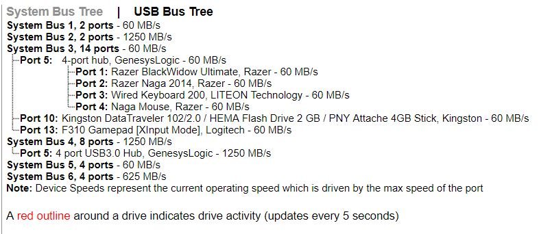

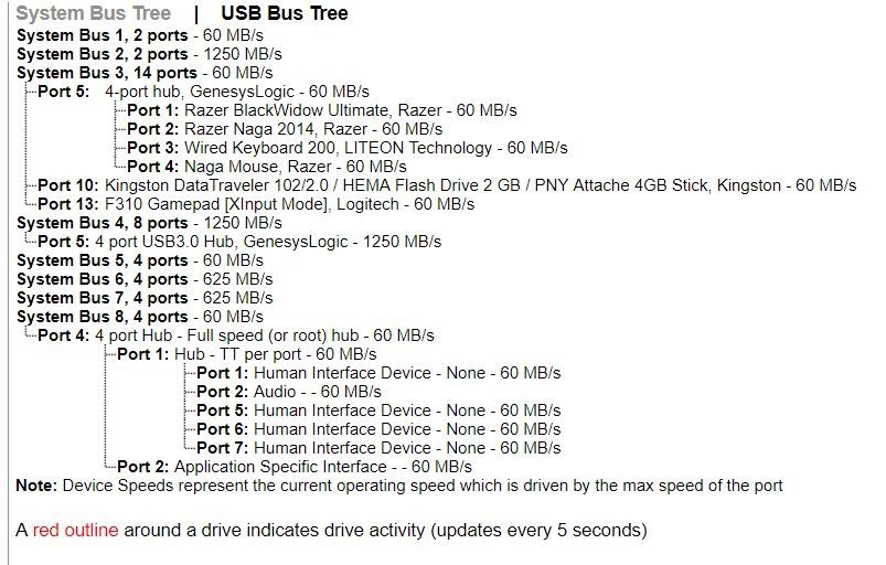

USB Bus Tree, before passing a controller to VM:
And after
System Bus 7 disappeared, and its speed, 625 MB/s (the dreaded 3.1 controller).  And looking at the IOMMUs of the non-enabled ACS override list, group 14 (copy/pasted from past post).

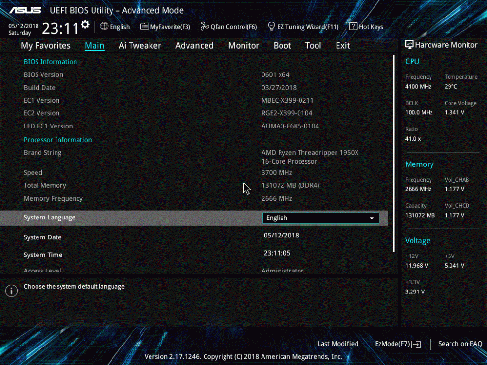

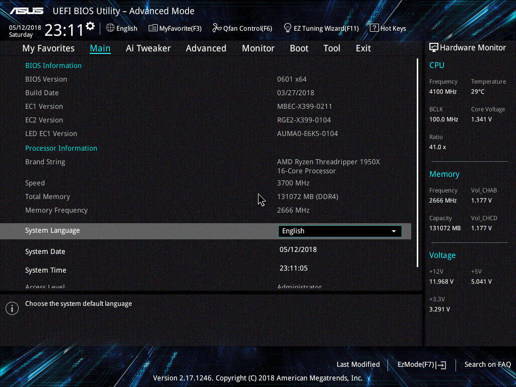

On 5/12/2018 at 7:06 PM, Jcloud said:
Oh that sucks, I know half the reason you bought that board was from my data/setup.  Lets see. . .
I'm just going to go down my list:
  1.  BIOS\Adavanced\AMD PBS  ---> "Enuerate all IOMMU in IVRS is "ENABLED"
  2.  BIOS\Advanced\CPU Configuration  -->  "NX Mode" and "SVM Mode" are "ENABLED"
  3.  BIOS\Advanced\AMD CBS\NBIO Common Options\NB Configuration -->   "IOMMU" is "ENABLED"
  4.  syslinux.cfg  :
    root@HYDRA:/boot/syslinux# cat syslinux.cfg
    default menu.c32
    menu title Lime Technology, Inc.
    prompt 0
    timeout 50
    label unRAID OS
      menu default
      kernel /bzimage
      append pcie_acs_override=downstream,multifunction initrd=/bzroot
    label unRAID OS GUI Mode
      kernel /bzimage
      append pcie_acs_override=downstream,multifunction initrd=/bzroot,/bzroot-gui
    label unRAID OS Safe Mode (no plugins, no GUI)
      kernel /bzimage
      append pcie_acs_override=downstream initrd=/bzroot unraidsafemode
    label unRAID OS GUI Safe Mode (no plugins)
      kernel /bzimage
      append pcie_acs_override=downstream initrd=/bzroot,/bzroot-gui unraidsafemode
    label Memtest86+
      kernel /memtest
Going to reboot after posting and look for a board revision number, for comparison.
I'm sorry dude, I feel like I let you down or I've misreported something (although I honestly don't know what that would be).
SO VERY SORRY to hijack a thread.  But this is the only one which I could find mentioning "NX MODE".  My Taichi manual doesn't describe it and I don't know what it's for.  It's not been in one of my boards before (Nor has "PSS Support").
