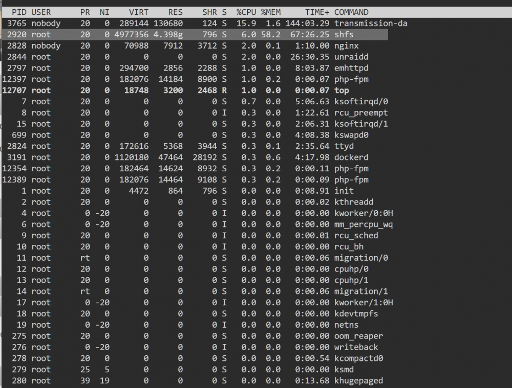

Same issue here. Memory increasing quickly with transmission open and barely increasing at all with it disabled. It does still seem to increase and will eventually restart but the tranmission container should be a great control for developers to troubleshoot the bug in shfs.
Share this post
Link to post
How are you monitoring shfs memory usage?
Share this post
Link to post
With top:
  PID USER      PR  NI    VIRT    RES    SHR S  %CPU %MEM     TIME+ COMMAND
 4188 root      20   0 7861252 6.791g    800 S   1.0 44.0 339:39.00 shfs

On 26/02/2018 at 2:37 PM, limetech said:
Yes, looking into this.
+1
I have the same issue, after few day SHFS take up to 4-5Gig.
