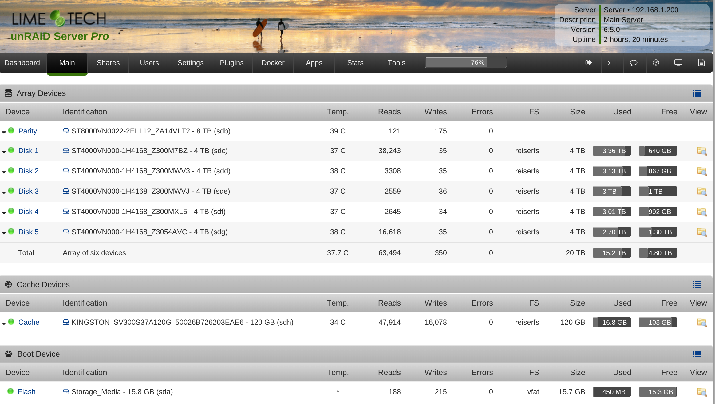

March 15, 20188 yr Hi... I run a 20 TB system and have been for going into 5 years on the road with it. I run all standard platter drives in the system and use SSD just for the Cache. Right now it has a 8TB parity and five 4 TB drives. (I put in the larger parity when I needed a new drive, so I did that for expansion if needed.) It is just part of our routine to shut the server down when we move and turn it back on when we arrive and setup. Same with our Dish Hooper, we always unplug it while traveling. It just becomes routine to do it like anything else you need to do. As far as heat goes, I have it in it's own cabinet and just have one 3" fan pulling air out of the top of it. It does very well and I leave the drives spun up even though I really do not need to. The issue I found, with my system, is that if I am watching something off the server and then a new file needed to be written and it needs to spin up a drive, the show then buffers while that I/O is waiting. So I now down don't spin them down. The big thing in the coach however is the full Ubnt UniFi Wi-Fi system that is running with dual band AP's inside and out and three switches. In the park we are currently at, I designed the Wi-Fi in the park.There is 150Mbps coming into the park, here is the data path I need to take.... Me ---> Wi-Fi --> NanoStation 5AC Station ---> LightBeam 5AC120 AP ---> LightBeam 5AC Gen to Station ---> Lightbeam 5AC Gen2 AP ---> Ethernet to router via 3 switches. 105Mbps down. ...however, I can get 105Mbps into the coach. Looking at the network traffic when I did that, 35Mbps was being used by others. https://OutsideOurBubble.com Edited March 15, 20188 yr by David Bott
