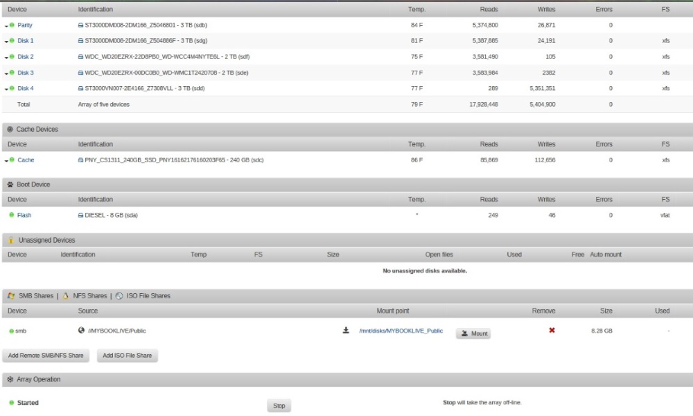

Here is the diagnostic file and a screen print of main. There was a power outage after my post which caused a parity check / rebuild but nothing seemed to change.
