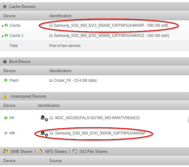

Logged into the server this morning and this is very new... Different device IDs (sdf vs sdk) but shows same serial number.
Not sure what to make of this?

I saw the diagnostics in your other thread. Maybe they ought to be merged. It seems as though one of your cache SSDs (sdh sdf) dropped off line and later reconnected but was given device name sdk. This suggests an intermittent connection so I'd power down and check/replace both the SATA cable and power cable to it. Because the disk disappeared your cache pool is broken and needs to be rebuilt but first you need to find out why it dropped and reconnected.

Yeah I had made the other thread before I realized what was actually happening. Fixing this should fix my log file being full too for sure.
The server uses a backplane though so there's no real cables for me to check/reconnect, if the backplane cable went down everything would have disconnected?
What are my next steps? How do I go about rebuilding the cache pool? My other data seems to be in-tact and I can actually boot VMs still just fine although the syslog of the server itself goes nuts when I do with errors.
Could the drive itself be to blame in this instance? I'm not sure what to make of the logs, if they actually indicate a problem with the drive itself or not?
In that case it might be worth moving the SSD to a different slot or at least re-seat it.
The SMART report for sdk looks good, though SSDs don't reveal as much as HDDs.
