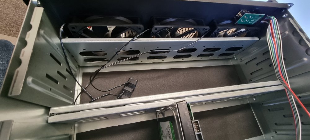

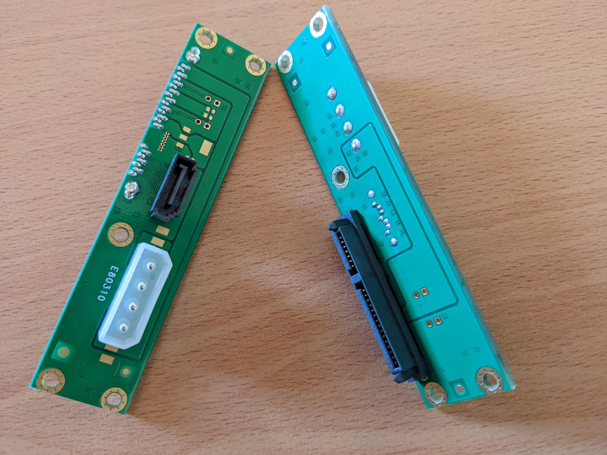

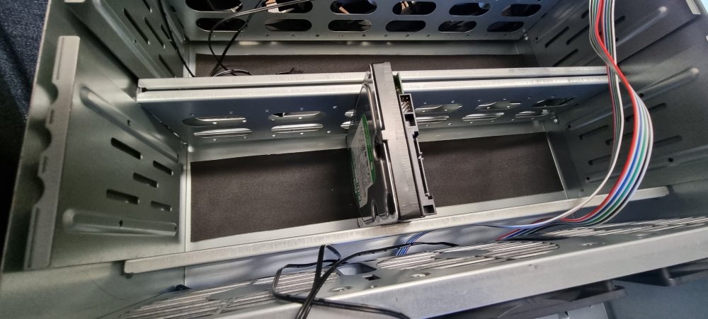

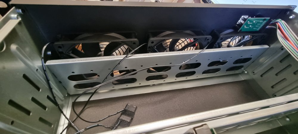

    Received the replacement parts from EKWB (super fast turn around) and was able to finish the install, did some stress testing and was happy with the results. 16C/32T @ 100% for 15min and was sile
  • So I needed a good base to move forward with, so I've got my existing drives moved into the new caddy system... success!    Post fitment, there are definitely a number of things to fix in a
  • The design is pretty crude at the moment, once I finish my current project I'm going to work on the v2 which should have improvements and potentially incorporate easy to source backplanes.   I've got

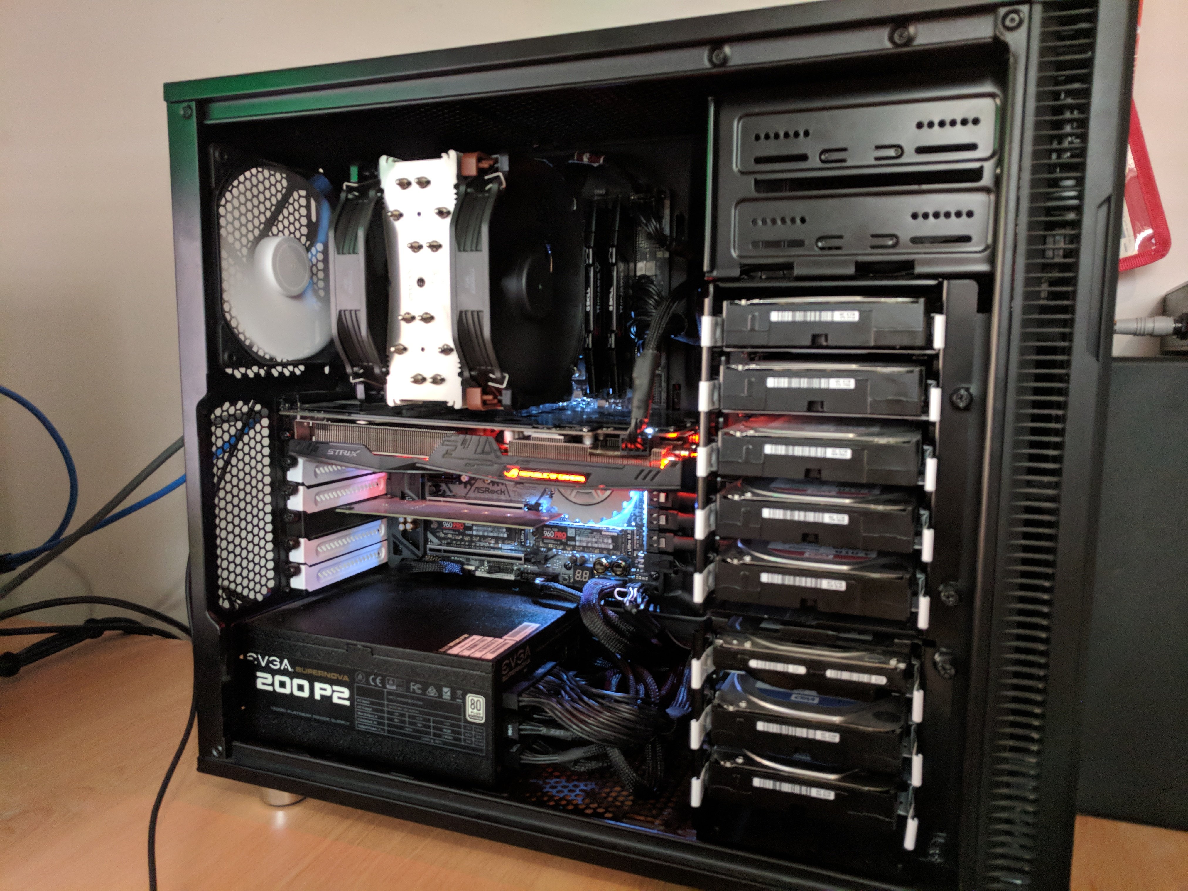

Cheers mate. Looks like I should go Tai Chi direction with my build too.
  1. For your 2 GPUs, did you have 1 for unRAID and the 1060 for VM? or both passed to VM?
  2. The Samsung B-die RAM thingie, that only relates to running overclocked right? I plan to run my RAM at stock but just want to make sure.
  3. Did you add multifunction option to your syslinux acs override?
Edited by testdasi
  1. I have run various configs which all worked including single card which was then passed to VM.
    Current config is gpu for unraid and gpu for VM due to being a little simpler to implement and also having the spare slot + gpu at the moment.
  2. Just stick to vendor recommended RAM and you'll be fine.
    However higher speed RAM has noticeable performance improvement on ryzen/tr and b-die is known to be more stable at these higher speeds (for which they are rated).
  3. No, wasn't needed for my purposes, but may be needed if you want to pass some of the onboard devices
Do you have the 2GPU the same way you have in the pic?
i.e. GTX 1060 in first (primary) slot and HD5450 in 4th (secondary) slot?
I have never had 2 different GPU in the same machine so have never managed to figure it out.
Does unRAID only use the GPU in the primary slot? If the primary GPU is passed to a VM, does unRAID automatically switch to using the secondary GPU?
Otherwise then basically the secondary GPU only purpose is to extract the rom of the primary one.
I'm kinda reluctant to waste the primary PCIe slot on a cheapo GPU just for unRAID - especially when there are PCIe x1 GPU out there.
Would be nice to be able to mount a 1070 on a true x16 slot + a cheapo GPU on the x1 slot and leaving both x8 slots + 1 true x16 slot for other purposes.
No, that picture was a single GPU setup when I first setup the server after upgrading, the bottom card was an m.2 card which was my cache drive in my previous setup (now using the 960 pros)
unRAID uses what is set to be primary GPU in bios, if you pass that GPU it loses the card and I'm not aware of a way to reinitialize it (that would be handy!).
However if your not using the GUI boot mode, it's probably not a major issue.
note: some bios have the ability to allocate a different primary gpu, but it's not common and I've not seen it on the ASRock bios.
You don't need to extract the rom, there are ways around that and they have worked for me (spaceinvader has a good youtube video on the topic).
Even if you do extract, it only needs to be done once then you can remove the other card.
