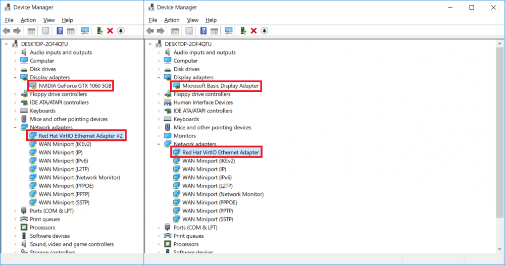

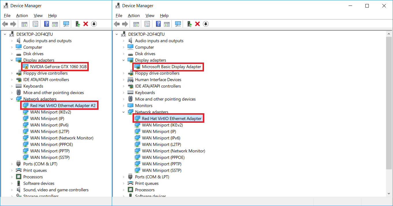

I have now created a new Windows 10 1803 VM and tested how it behaves with and without GPU passthrough (using my GTX 1060 this time). And it's the same! I have attached how it looks like in the Device Manager, you can clearly see that there is two different network adapters depending on if I use the built-in unRAID VNC or GPU passthrough.
Don't mind the warning for my GTX 1060, it's probably because I have not pointed the VM to the correct VBIOS rom file.
The only changes from earlier installations is that I now install Windows 10 1803 and uses the virtio-win-0.1.141. I will see if I can find some time to do another Windows 10 1803 installation using the previous virtio drivers I used. And if it possible, to find a Windows 10 1709 to install.
