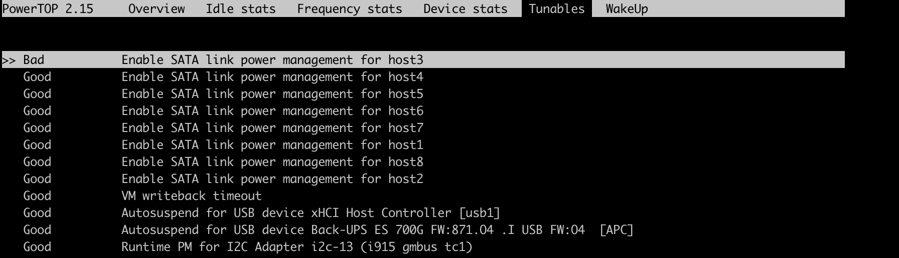

Actually I think I answered my own question, I had it isloated with VFIO and that made it run at high idle power. By not doing that, installing Radeontop, the power draw came right down, I assume because drivers got loaded? Anyway I can still use it in my VMs and power usage is much lower so I'm happy.
Not sure if this is the right place. I recently upgraded my server to 13700K, Z690 motherboard an 64GB 3200 RAm. I am getting 100W idle which feels quite high. I have done a lot of the tuning mentioned here but have narrowed it down to my GPU, a Radeon RX6800. If I remove that then it idles around 40W. Anyone know how I can reduce the idle consumption of the card - it should be less than 10W at idle from reading about.
