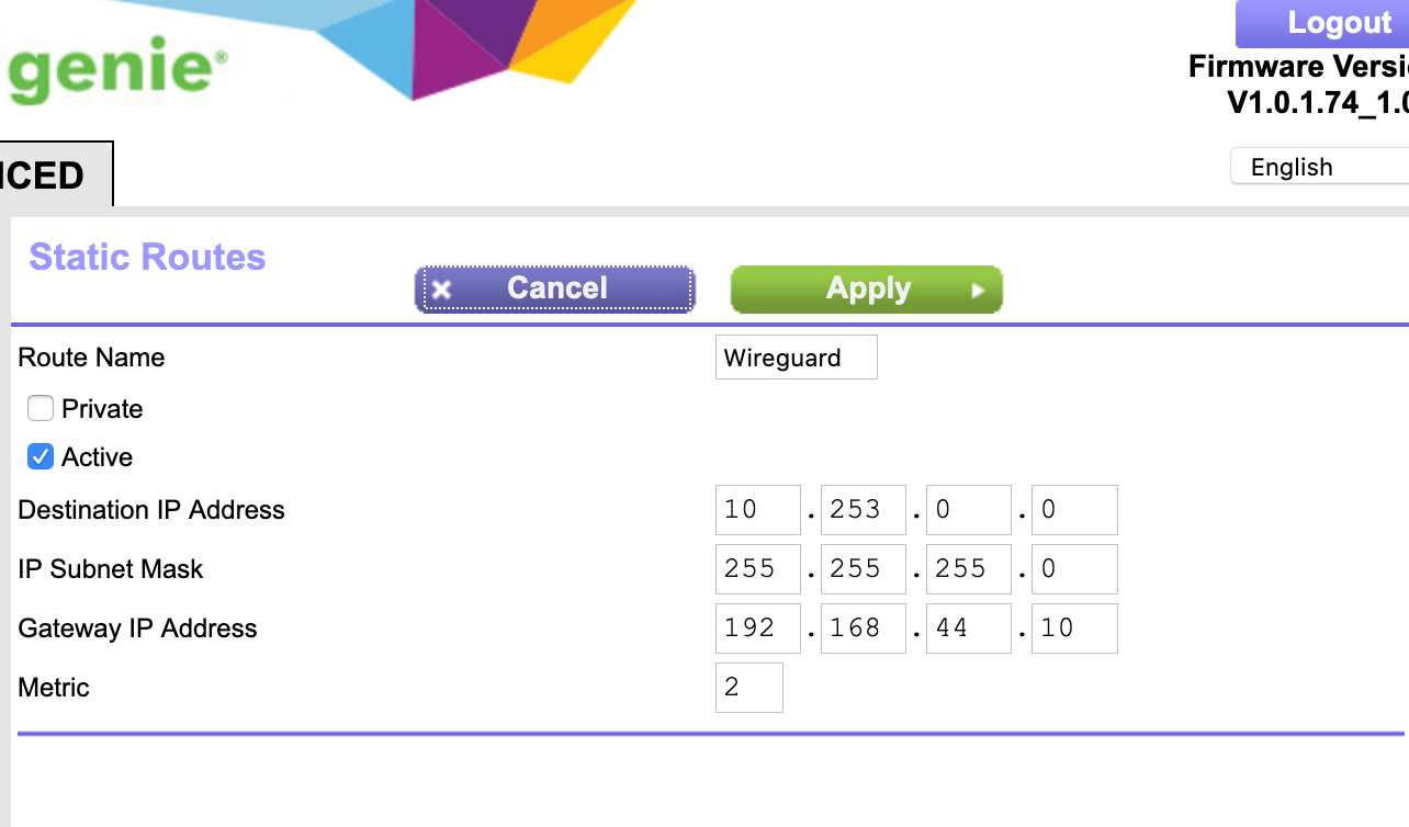

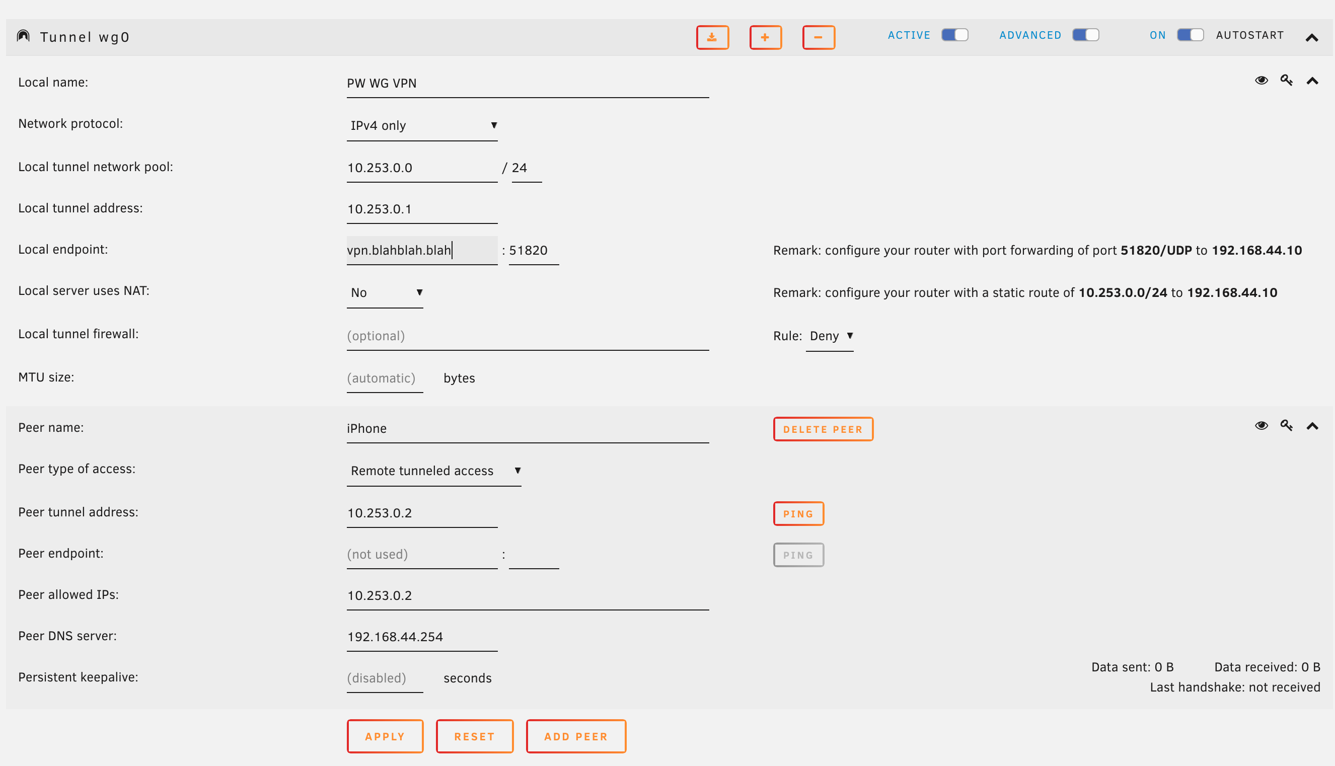

I am struggling with this. I am trying to get a tunnel so all of my traffic goes through Wireguard. I am connecting okay and can access my unRaid server and other servers on the main LAN just fine. I can't access any internet sites though. It feels like a DNS issue but I think I have it all setup as I should. uNRAID IP: 192.168.44.10 Router/DNS : 192.168.44.254 Wireguard config:- Router static route:-

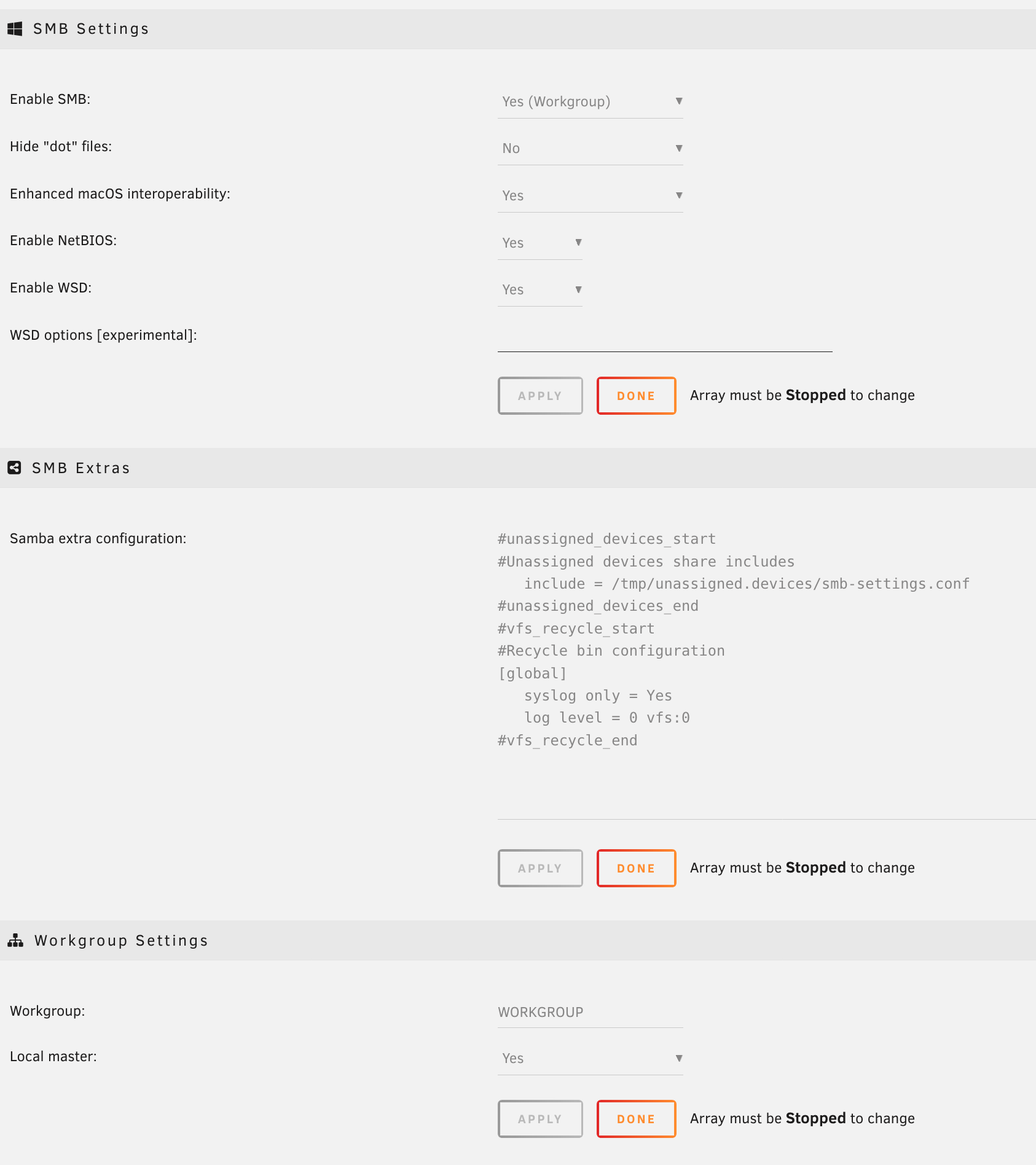

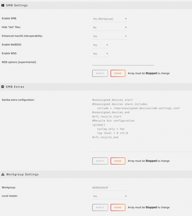

I am finding that unless I open up the shares so they are secure as opposed to private - i.e. guest has read only then the Mac won't connect to them? I get the dreaded "The operation can't be completed because the original item for 'myfolder' can't be found" Anyone got any ideas how to get SMB working correctly on Macs. I've got a few smart devices in the home now and would like to tighten up security on my shares so you can't read what is on them without username and password.- Unraid 14th Birthday Case Badge Giveaway
