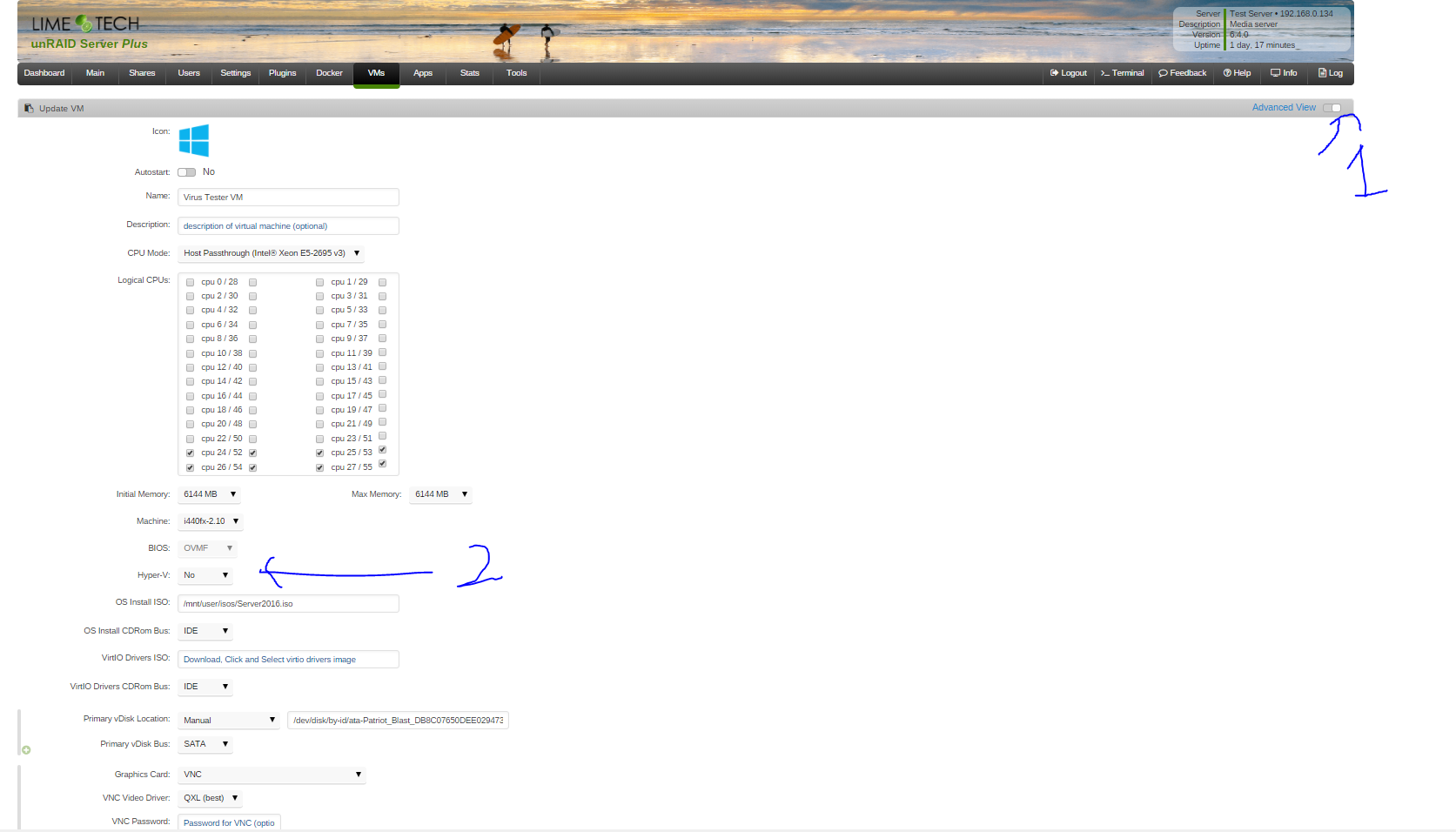

The Easy Work Around
For most scarinos, setting the Hyper-V option to No
1. Go to VMs tab
2. Go to edit VM's Configuration
3. Switch to "Advance Mode"
4. Disable Hyper-V

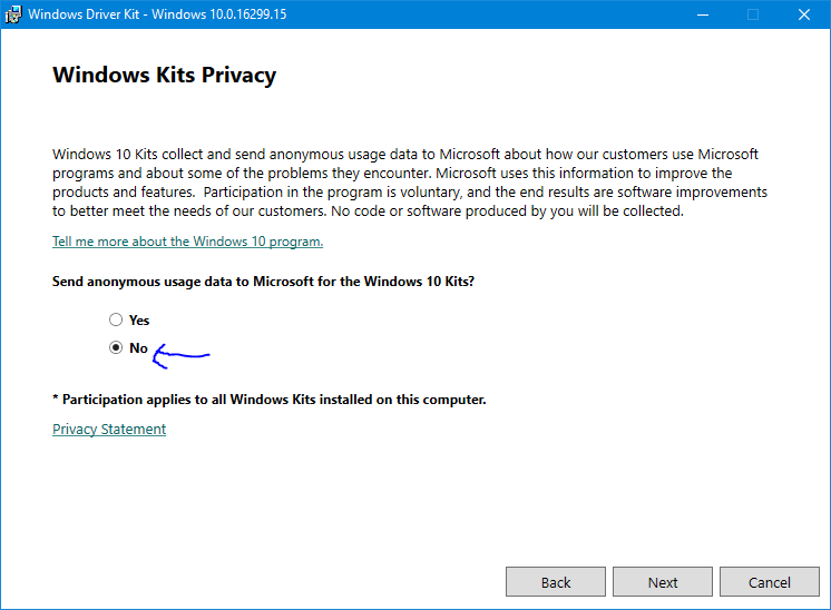

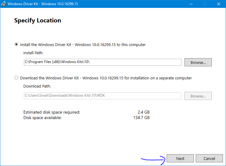

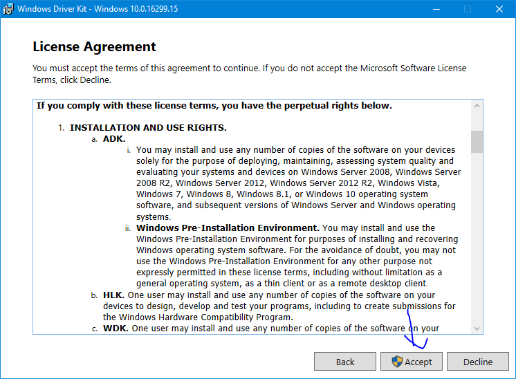

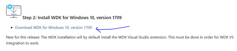

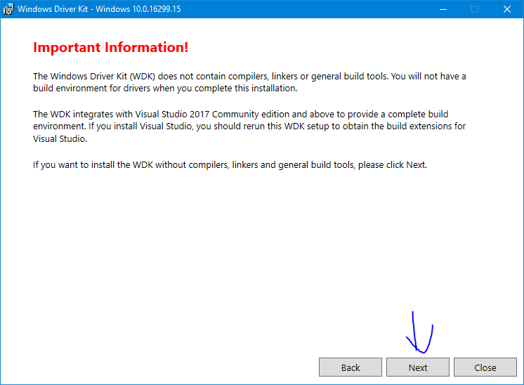

Step 1: [On External Machine] Install Windows Driver Kit
           Navigate to the following Link : https://docs.microsoft.com/en-us/windows-hardware/drivers/download-the-wdk
            Download WDK for Windows 10
5a9276e3400c1_Acceptit.PNG.60e927c1512d0a8ee2ffaa8c744b3f15.PNGAccept it.PNG5a9276ef84131_NextAgain.PNG.703465f4d8f61fa08f47c987f2e0b62b.PNG

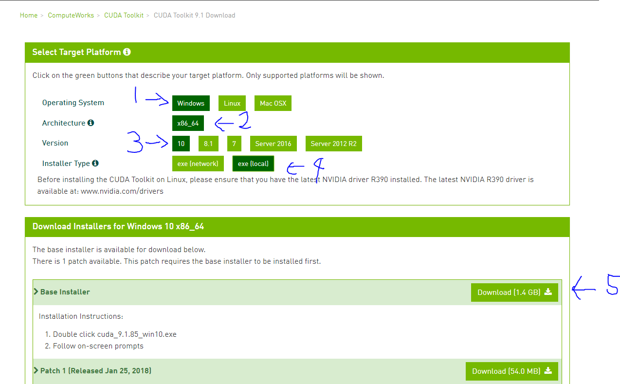

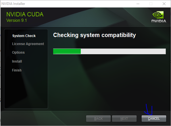

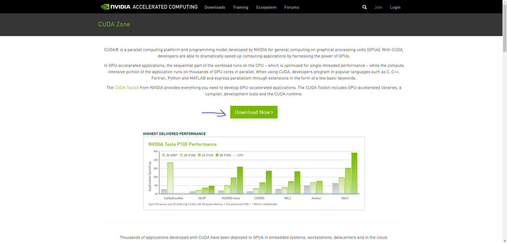

         Downloading Nvidia CUDA : Navigate to https://developer.nvidia.com/cuda-zone5a927760b26f5_DownloadCuda.thumb.PNG.a42aa71bfbdababe6aff28f50b7f0766.PNG5a927774c0d03_SelectCuda.thumb.PNG.4d6c5b57cb50977f934a0896c7c0313e.PNG

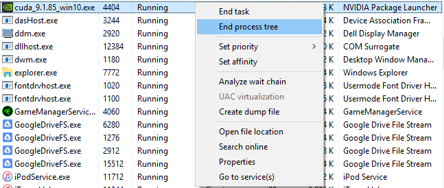

After It has been download, Run it But change the extraction Path to C:\NVIDIA
If the following windows are shown DO NOT CLICK CANCEL You must Quickly end It's process tree with task manager (Cancel Will result in the setup deleting the temp files)

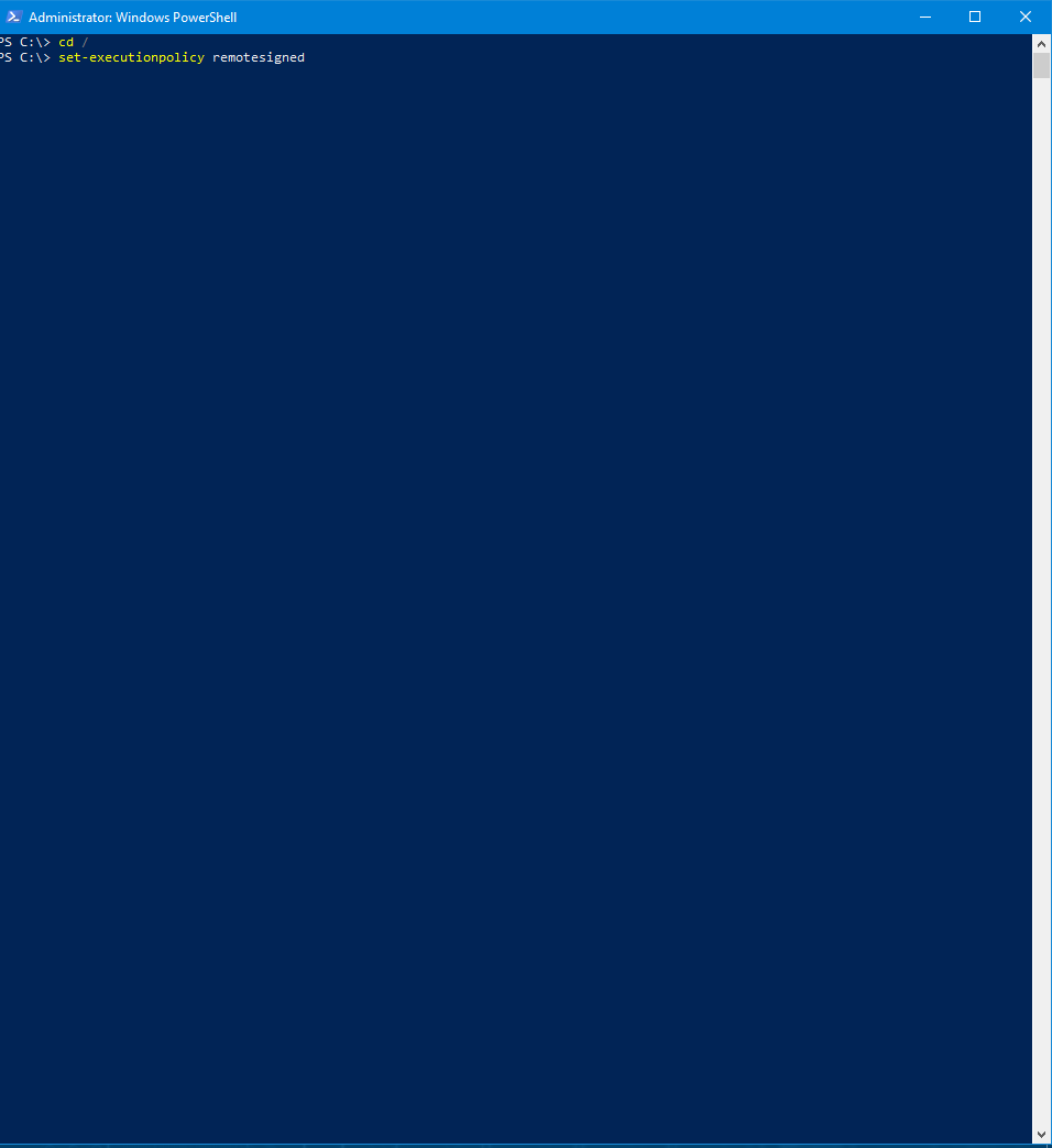

then Open A Powershell Windows as Administrator
type in cd /
Set Execution Policy to Remote Sign with "set-executionpolicy remotesigned"

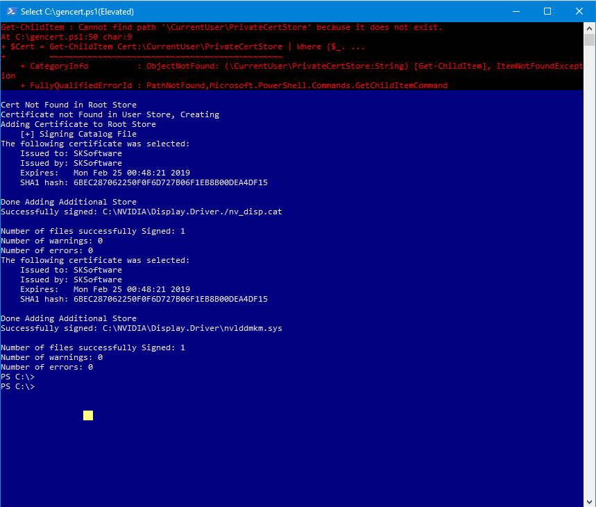

Press Y then Enter then type in ./patcher.ps1 C:\NVIDIA\Display.Driver
The following Should Happen :

Use Advance Mode Set Hyper-V to No,and Set BIOS to OVMF, attach your usb to the vm too

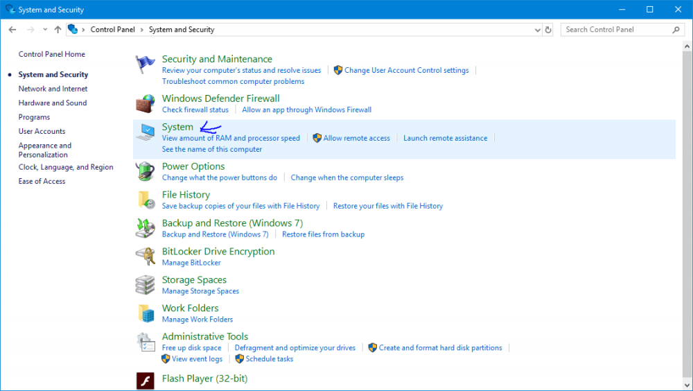

Disable Windows 10 Auto driver installation by
[IN VM CONTROLLED USING VNC]

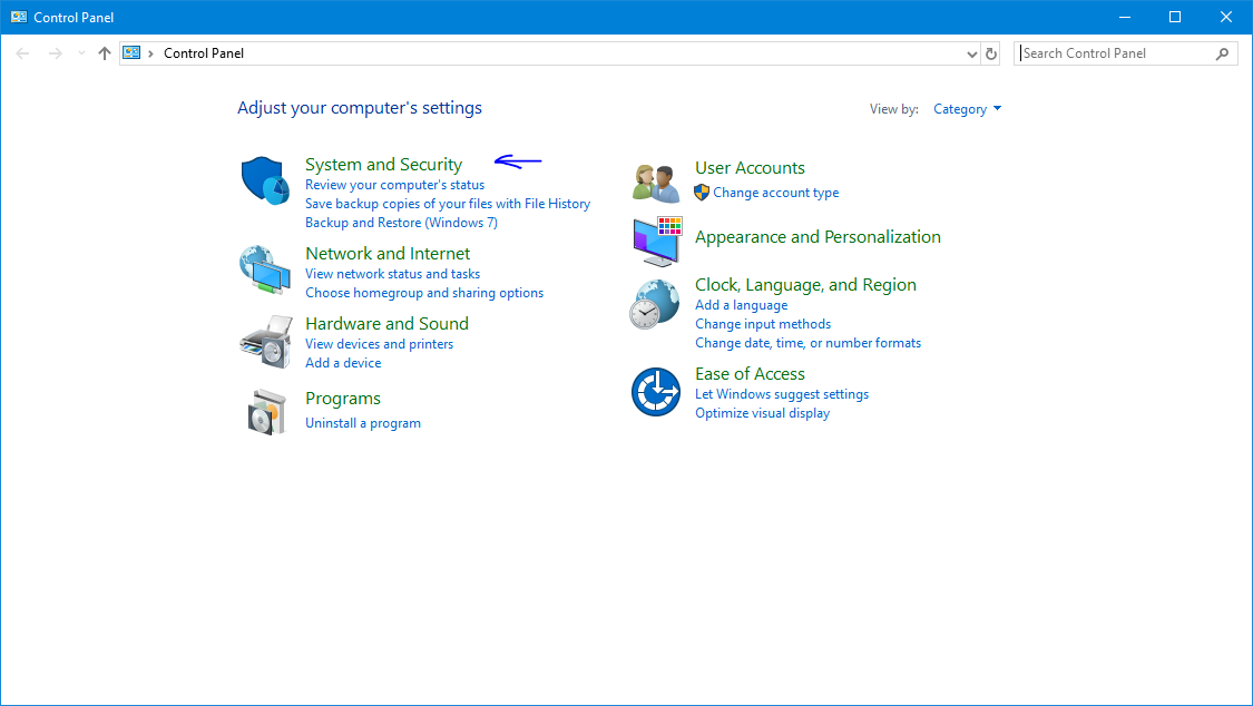

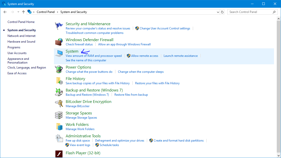

1. Open Control Panel
Navigate by following the picture
clicksys.thumb.PNG.4c72d87ef49892b7f56603711d1b2d43.PNGadvsys.PNG.5d24c9a721ae80bdc6ccb9a33fdac2fc.PNG
Click Save Changes
