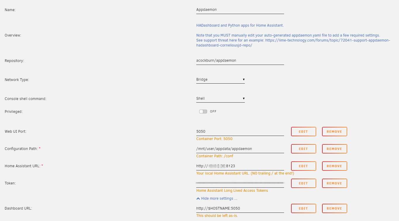

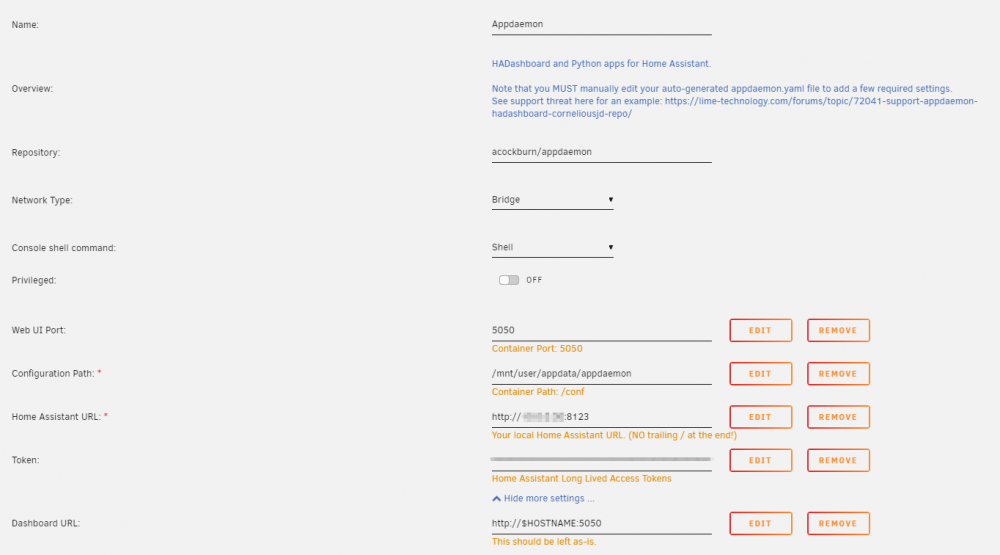

May 8, 20206 yr Author Ok, template has been updated, but CA will need to re-scan it to reimport it, it will take a few hours. I've updated the top post here for newcomers to see some much-needed info on how to get this to run. Here's what the template should look like now. Note that the end Dashboard URL is a hidden variable and shown under "More Settings". Most people shouldn't need to change this. Edited May 8, 20206 yr by CorneliousJD

July 19, 20251 yr Note that the end Dashboard URL is a hidden variable and shown under "More Settings". Most people shouldn't need to change this. As of AppDaemon 4.5, this is no longer true. If anyone stumbles across this thread receiving the error message As of AppDaemon 4.5 the host name specified in the URL must resolve to a known host while using this template and AppDaemon does not start, please expand the More Settings option in the template, and change the DASH_URL variable to http://0.0.0.0:5050 or your preferred port. Editing the AppDaemon.yaml file will not work and this template will overwrite the url on restart. Took me two hours to find this. Hope I can help someone else.
