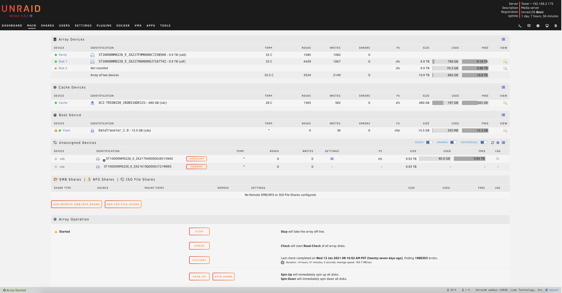

I did as you said, and started in manteinance mode, It shows that disk 2 has 70GB used, however If I want to see what is in there I see that it is empty:
1964672393_ScreenShot2021-02-09at3_15_27PM.thumb.png.608a88dfaba04ff3b551312a0f6b3f97.png
An ‘empty’ disk still has an amount of space used to hold the file system directory structures.   The latest XFS driver releases in the newer Linux kernels have a larger overhead than older Linux releases.
I can understand that, however aren´t 70GB  quite some space for system directory structures?
True - but that is what it is with the latest releases of the Linux XFS drivers :( and is is more than used to be the case.    I believe there are new features available, but exactly what they are and whether unRaid can use them I have no idea.
It's mostly because of the recent reflink support with xfs.
