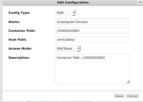

However I don't know how to adjust your volume mappings mode in binhex-krusader to RW:Slave (RW would be needed as I use this docker to move previously backed up data to the array).
Go to the Docker tab.  Find the Binhex-Krusader in the Dockers list.  Click on it (see picture below) and select "Edit".
The Binhex-Krusader Docker edit screen pops up.  Go down the list until you see the /mnt/disks/ for the container path for unassigned.  Click the "Edit" button to the right of it.
The details pop-up for the unassigned devices paths.  Go down the list to "Access Mode" and change that to "RW/Slave" and then save.

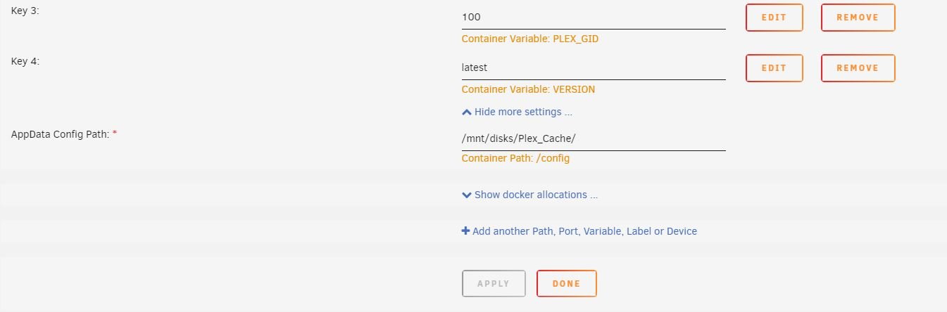

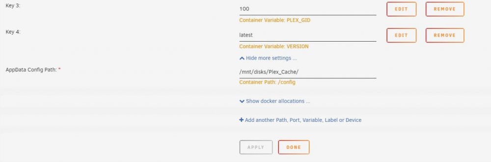

I'm gunna resurrect this really old topic and tack on my question, 1 of my 2 errors were resolved by doing this but if you look at the attached picture, the /config location doesn't have an edit button, so I can't tell it to be RW/Slave....how do I fix this situation?Capture.thumb.JPG.d37085b6132fe2d2ef4337729e65d97f.JPG
You would have to go to Settings - Docker, disable the service, then enable template authoring mode, re-enable the service, and then the edit button will be there.
Beautiful, that got it. Just to add to your fix, I had to go to advanced mode to see the edit button, thanks!
