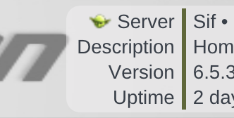

Hello i recently noticed a "Yoda" icon showing on one of my unraid servers by the name on the webgui but not showing on the other.
both servers are running all the same plugins and only dockers and VM's differ between the two...the only other difference is the unraid license
Just trying to understand what this is for and how i can remove it or add it to the other server?

i stopped the array and noticed it disappeared when i started it back up the icon never came back...ill have to watch closely for it again

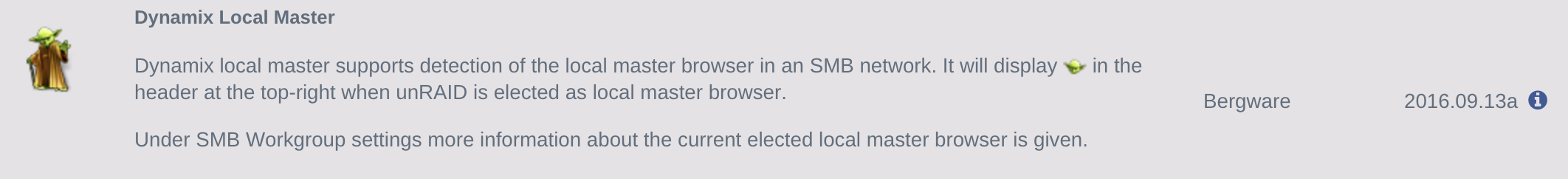

Yoda head indicates whether the server is the SMB Local Master Browser (or not).
From memory this is from the Dynamix "Local Master" plugin

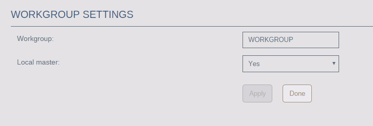

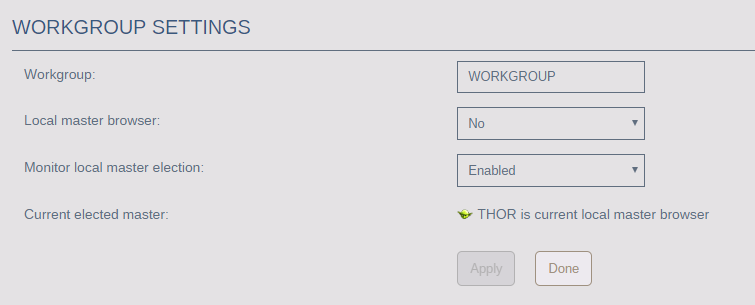

curious now why SMB master setting differ by the two?
Plugin on bottom server might need to be updated?
Mine looks like the top screen.

my plugins all auto update and both servers are on same Unraid version
ill make sure all the exact same plugins are installed
yeah i compared plugins and had the Dynamix local master icon installed on one server but not the other so makes sense now
thanks for the info i dont even remember installing that
