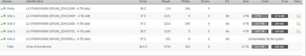

Unmountable : No file system
I just moved my tower yesterday and it was well and working till then. But in the morning one of labour was trying to reach out for a file and it went missing he complained. I thought it could be a disc issue, I checked it actually is.
So how do i solve it guys. I dont understand how it went that way, its a new disc too. Handled it very safe even when it was moved am sure that there are no physical damages happened, because i carried it myself.the disc was  Bought like 1 month back. Now i am need in need of the file also its job critical.

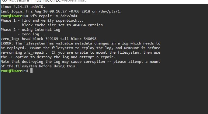

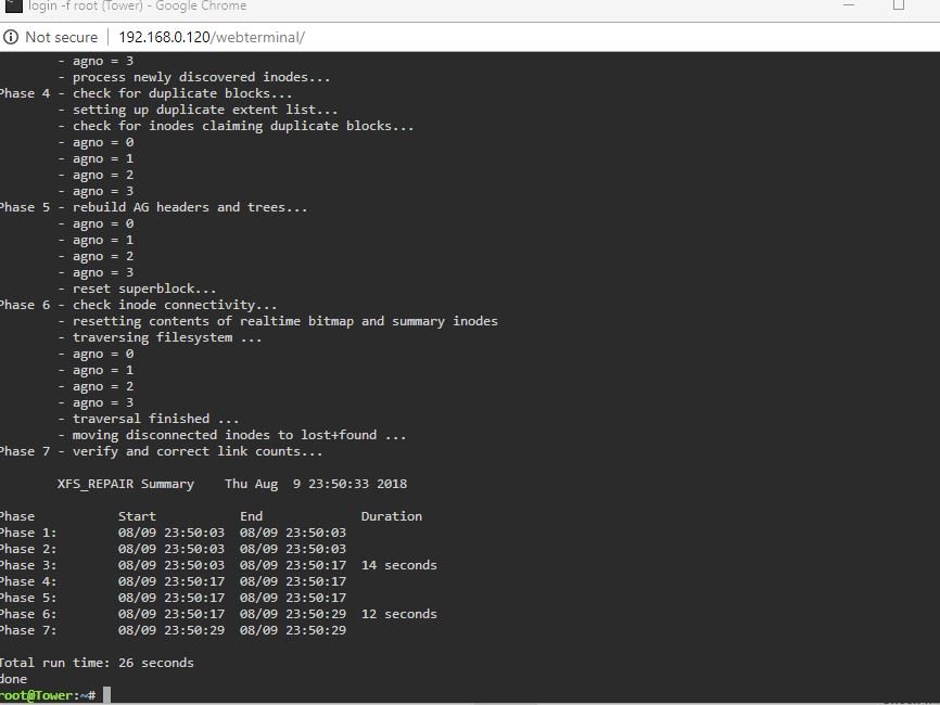

Ran the command and it shows me this. I cannot understand what has been said in the text clearly. what am i supposed to do after this point ?
Start the array.

Yeah done. and the drive remains unmountable.
Post the xfs_repair command you used
Sent from my SM-A605FN using Tapatalk
Sorry the first i have replaced the md3 instead of md4. Now have run it as md4. please check the image.
The next step?
I have loaded array in normal mode and the issue remains the same now.
Edited by ThePhotraveller

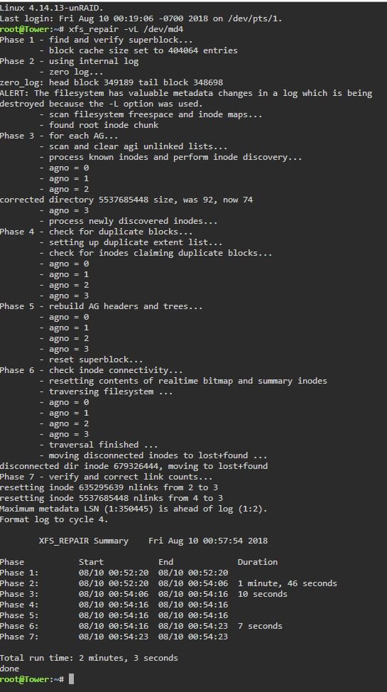

Since the file system remains unmountable you can't replay the log so the next step is to go back to Maintenance mode and run xfs_repair with the -L option. The wording of the message suggests this is a bad place to be; in practice the only files likely to be affected are any that were being written at the time the corruption happened.
Am hoping there was nothing written during that period.
Can you exactly drop the command i need to run here? Actual noob here :/
Yes, I also said disk3 instead of disk4, like John_M mentioned use -L on disk4

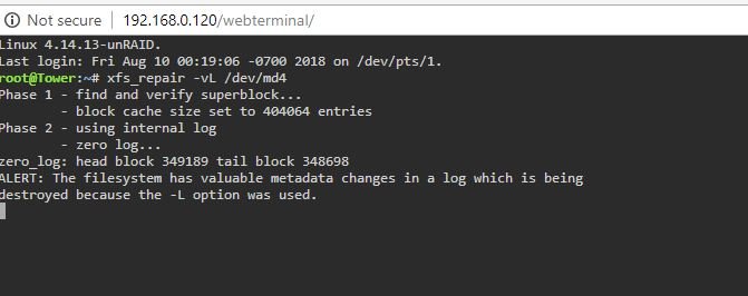

xfs_repair -vL /dev/md4

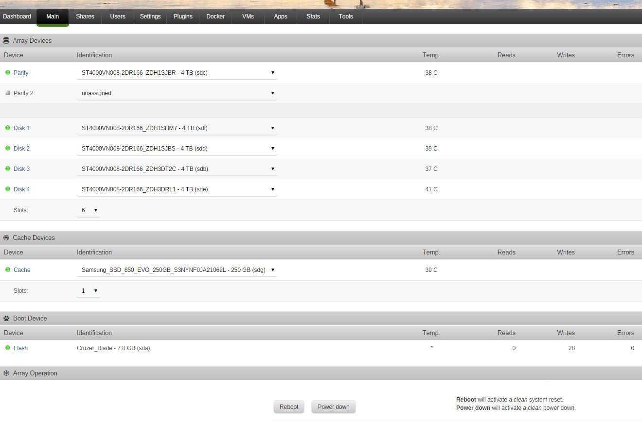

I ran in maintenance mode. stopped to start the array. It stopped but i cannot start again. The buttons are gone now.
You need to wait for xfs_repair to finish.
okie how long does that take usually ?
I mean how do i know if its finished.
It can take a while, when it finishes it will look like the 1st xfs_repair screenshot you posted.

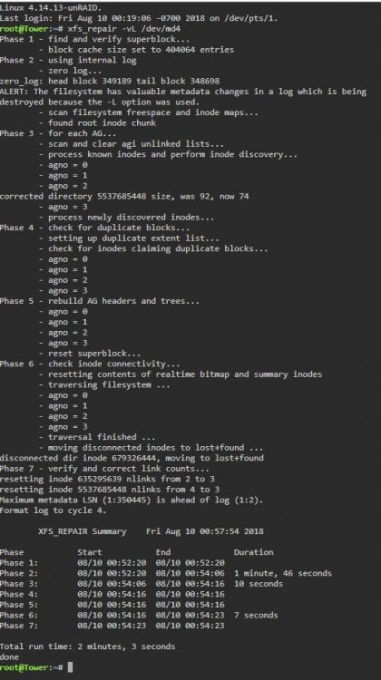

I think its done.  still i dont see the start button here. Reloaded the window also. only reboot and power down appears.
It should start now, if it doesn't reboot, filesystem should be fixed.
No it hasn't mounted yet. ?
5 minutes ago, johnnie.black said:
reboot
Thanks mate. Life saver. It's there. What shall i do now ? do i have to do anything after this point?
