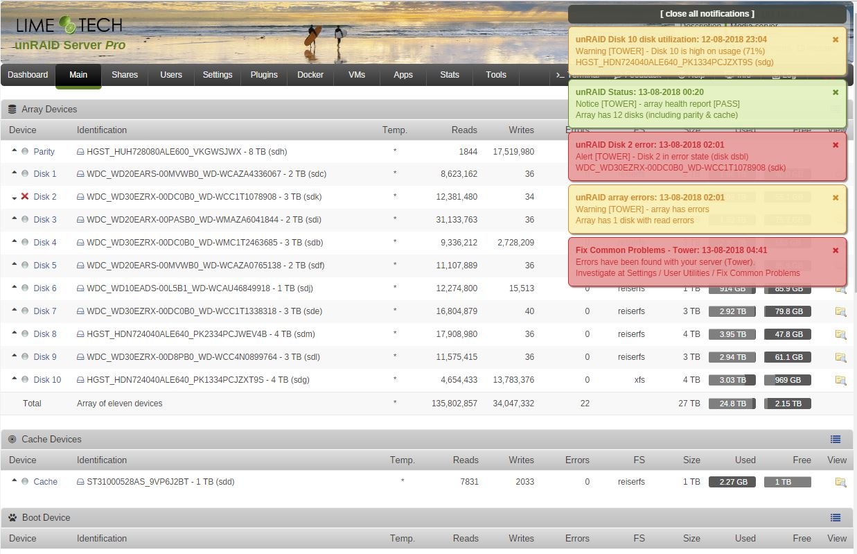

- after the copying finished last night, disk2 started showing read errors
- array is now showing a red X on disk2 (a disk not involved in the shrink process)

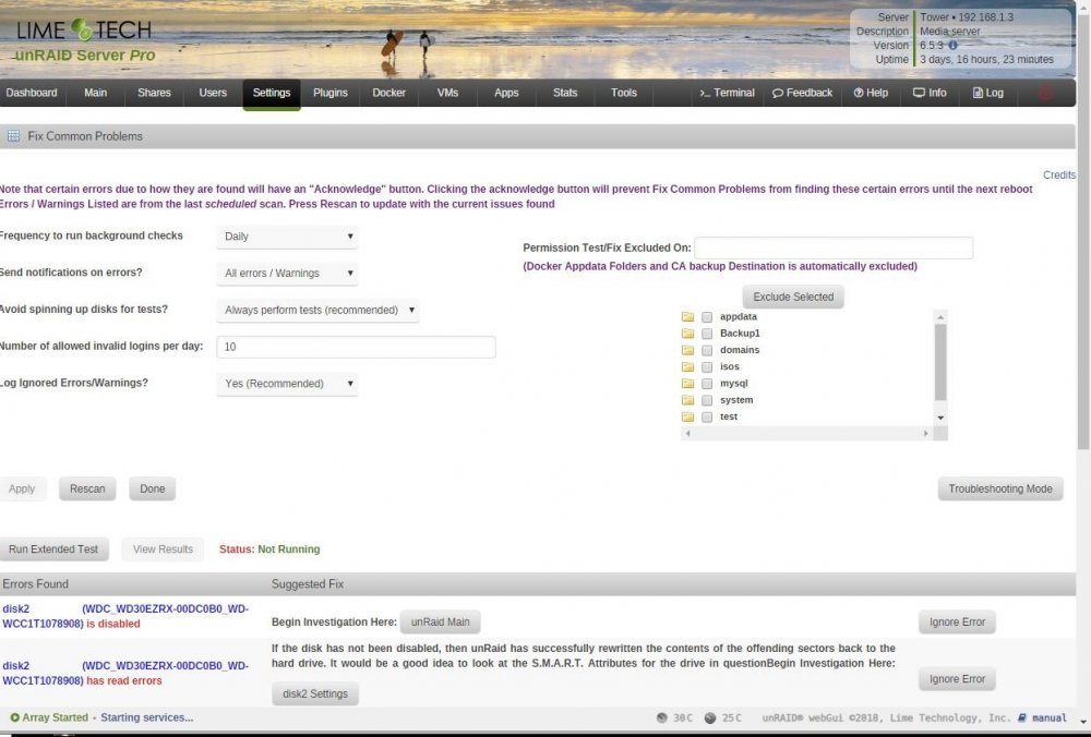

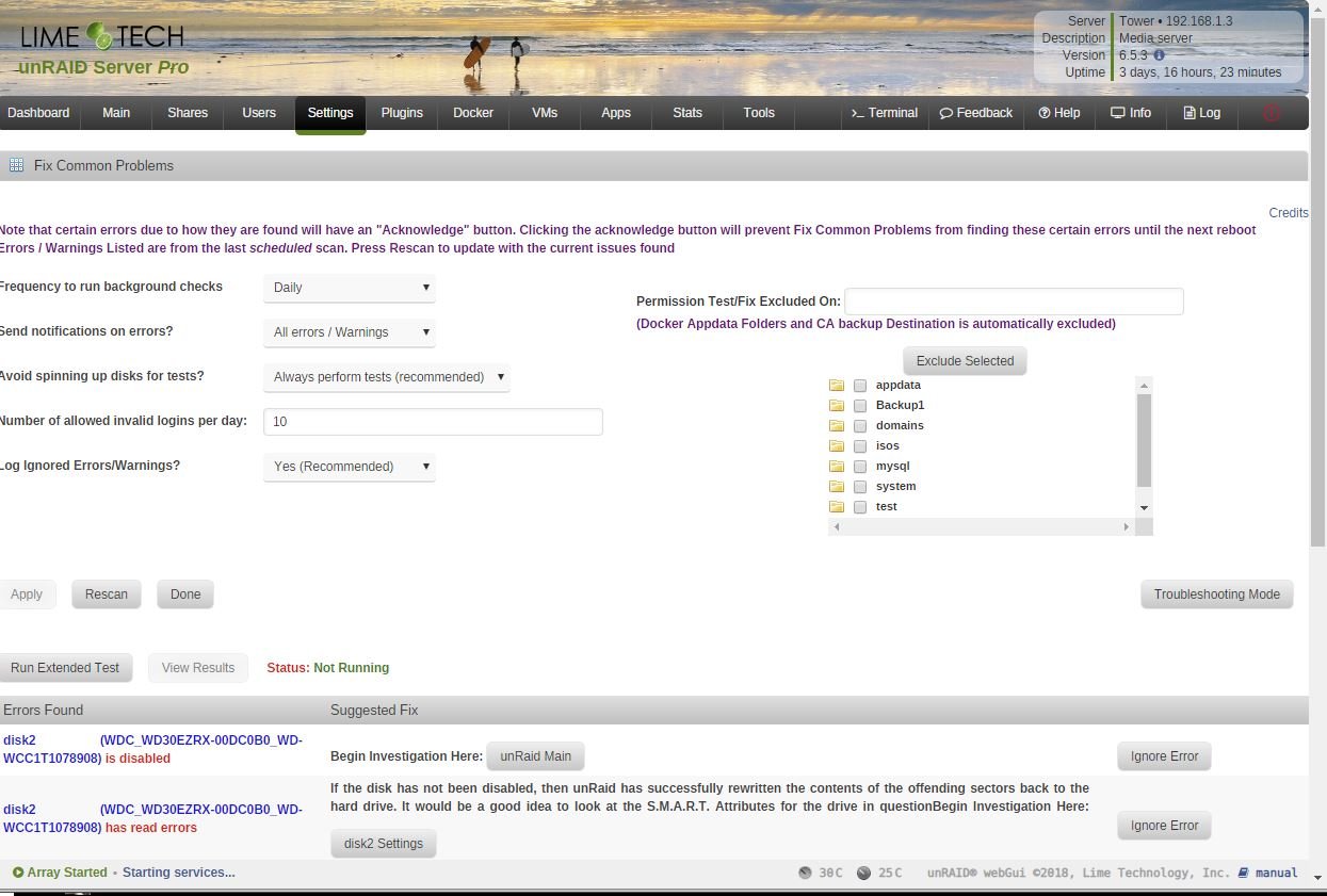

"Fix Common Problems" plugin displays:
    "unRAID Disk 2 error: 13-08-2018 02:01
    Alert (TOWER) - Disk 2 in error state (disk dsbl)
    WDC_WD30EZRX-ooDC0B0_WD-WCC1T1078908 (sdk)"
disk2 is still reiserfs because I just upgraded to version 6.  I had intended to do a data shuffle and reformat later.
some screen shots and the diagnostics log are attached.  sys Log shows disk read errors but earlier mentions an "interface fatal error".  Maybe the disk is OK but the interface failed?  Tried to get a SMART report but it failed.

IMO no point in doing this, and it will always find a few errors due to filesystem housekeeping, screenshot appears to confirm there were no data writes to disk2, so basically you have to options:
