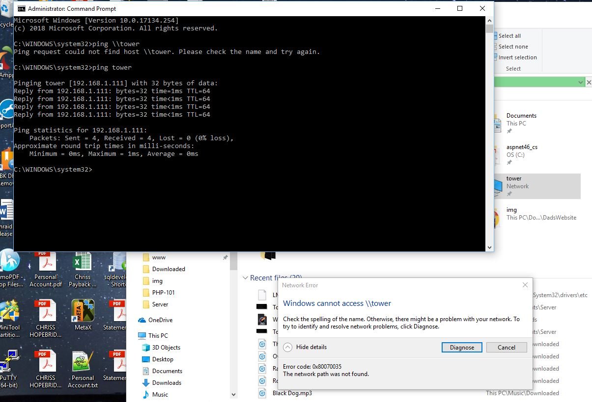

It's not connecting at all.  I tried opening a share through file explorer and I get the error "The network path was not found.  As you can see from the attachment I can ping the server but can't access it to add files.

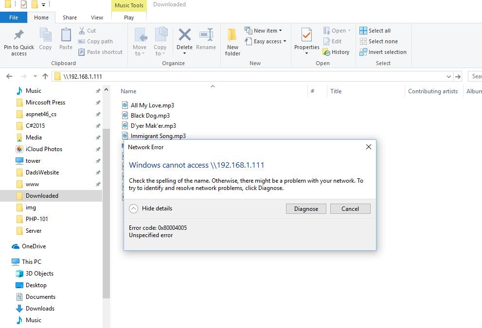

Try using  Windows Explorer (Windows File Manager)  withe address     \\192.168.1.111    and see what the result is.
There's a whole thread on windows issues with unRaid (actually with all NAS systems), but you can save yourself a world of trouble and instead of referencing \\tower, simply use the IP address instead
I get the same thing.
