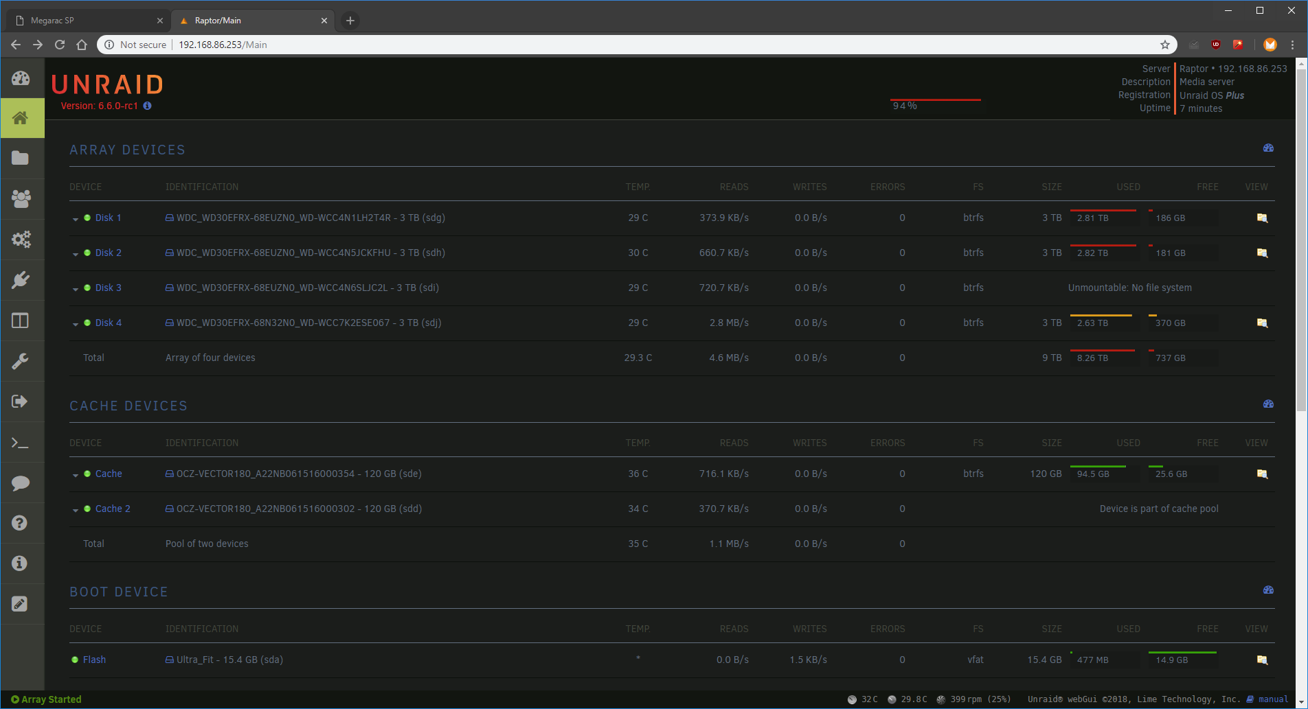

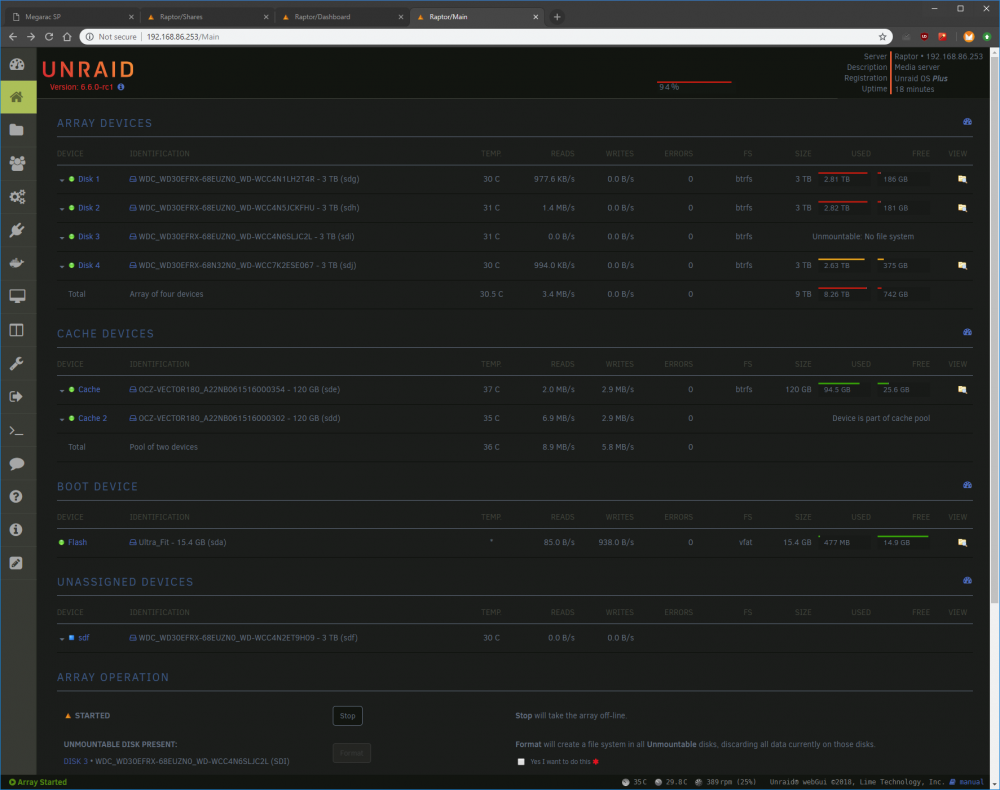

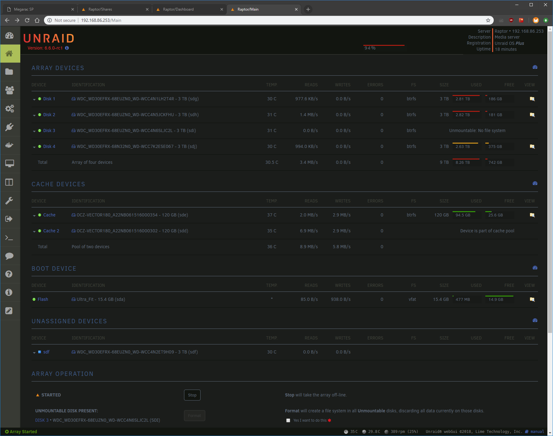

This is what happens when I hit start: I believe I should try to use sdf as my parity and restart the array??
Then hopefully restore data on disk3? But I don't know for sure so I don't want to risk doing anything.
They are BTRFS disks - should I scrub Disk3??
Sh†t .. I should not have set SDF as parity 😭😭
It began a parity rebuild 😭 what the hell!! 😱😖

At this point I would assume you have lost all data on the former disk3 by assigning it as parity. The unmountable disk you have assigned as disk3 will be no help and will never be mountable since it was parity and parity has no filesystem to mount.

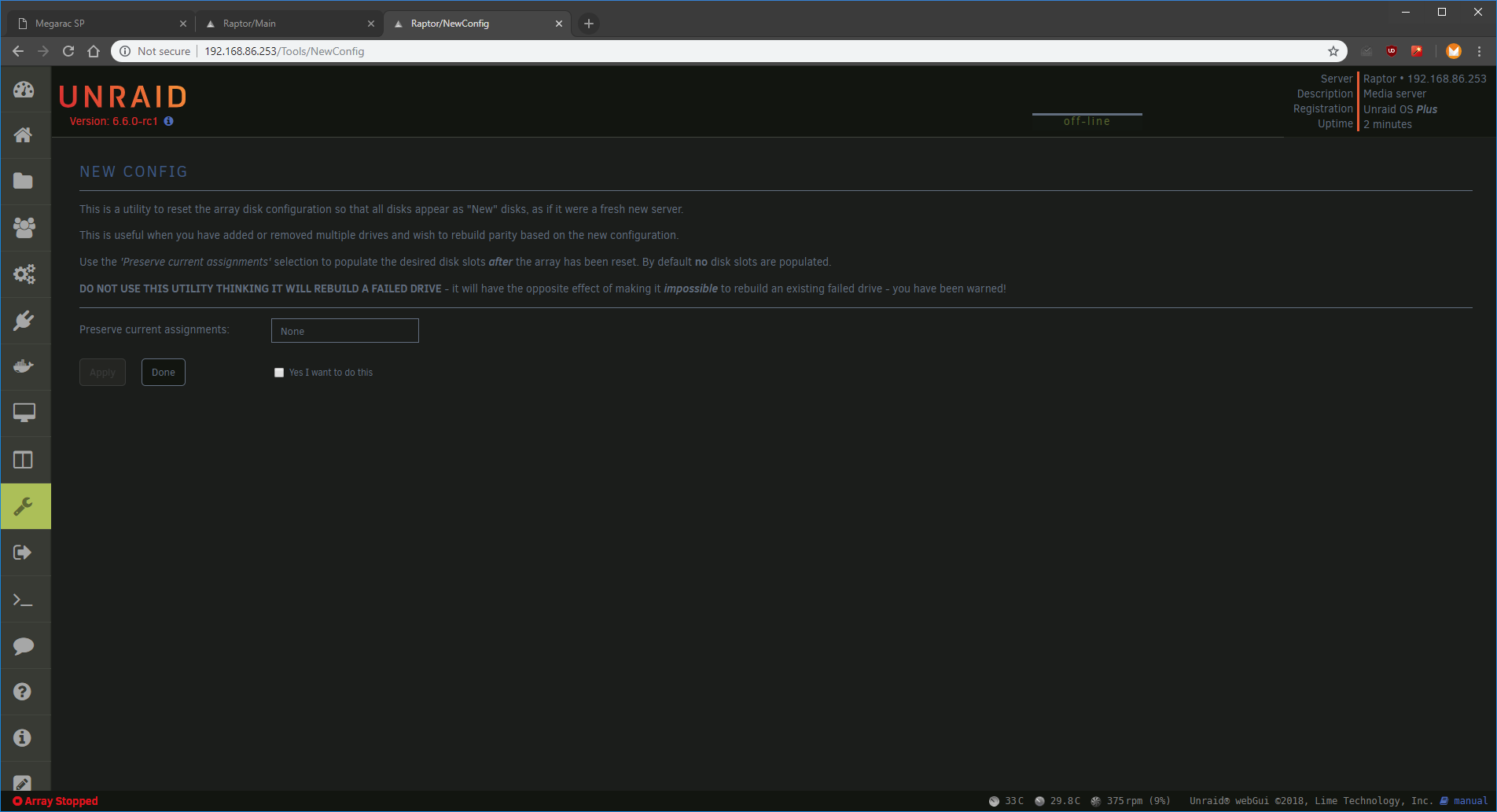

Err... So IF I do a 'new config' and assign disk 3 to parity and then put the other disks into the array as normal will it be possible to recove
no

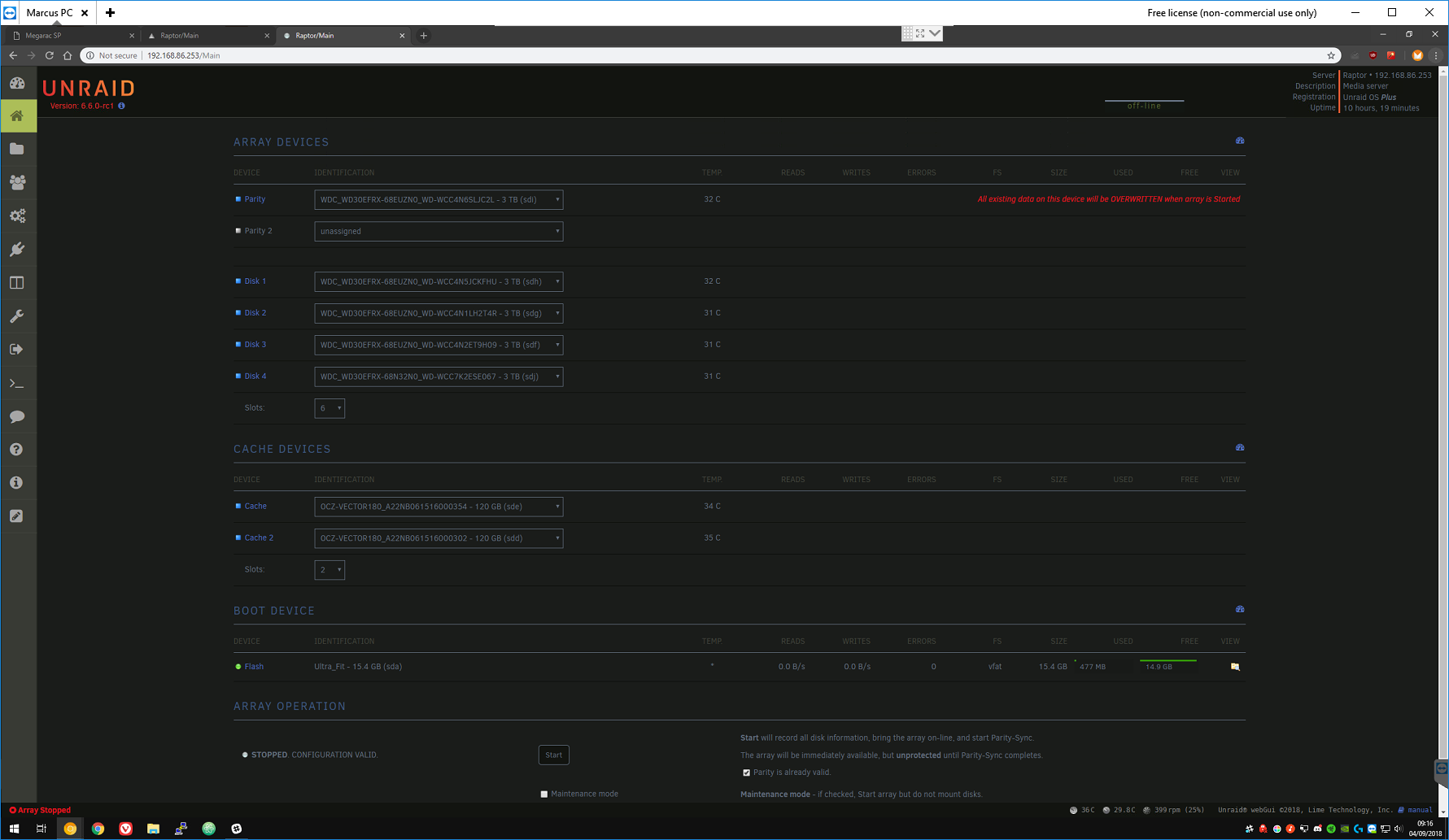

Array currently looks like this, I didn't 'break' my parity drive by putting the wrong disk into the parity slot.
The parity still exists in some capacity - Should be possible to get sdi into the parity slot, right? And treat sdf as a 'new' disk that is missing the data which is housed on the parity disk (sdi)
sdi = parity
sdg = d1
sdh = d2
sdf = d3
sdj = d4
Still "no" ?

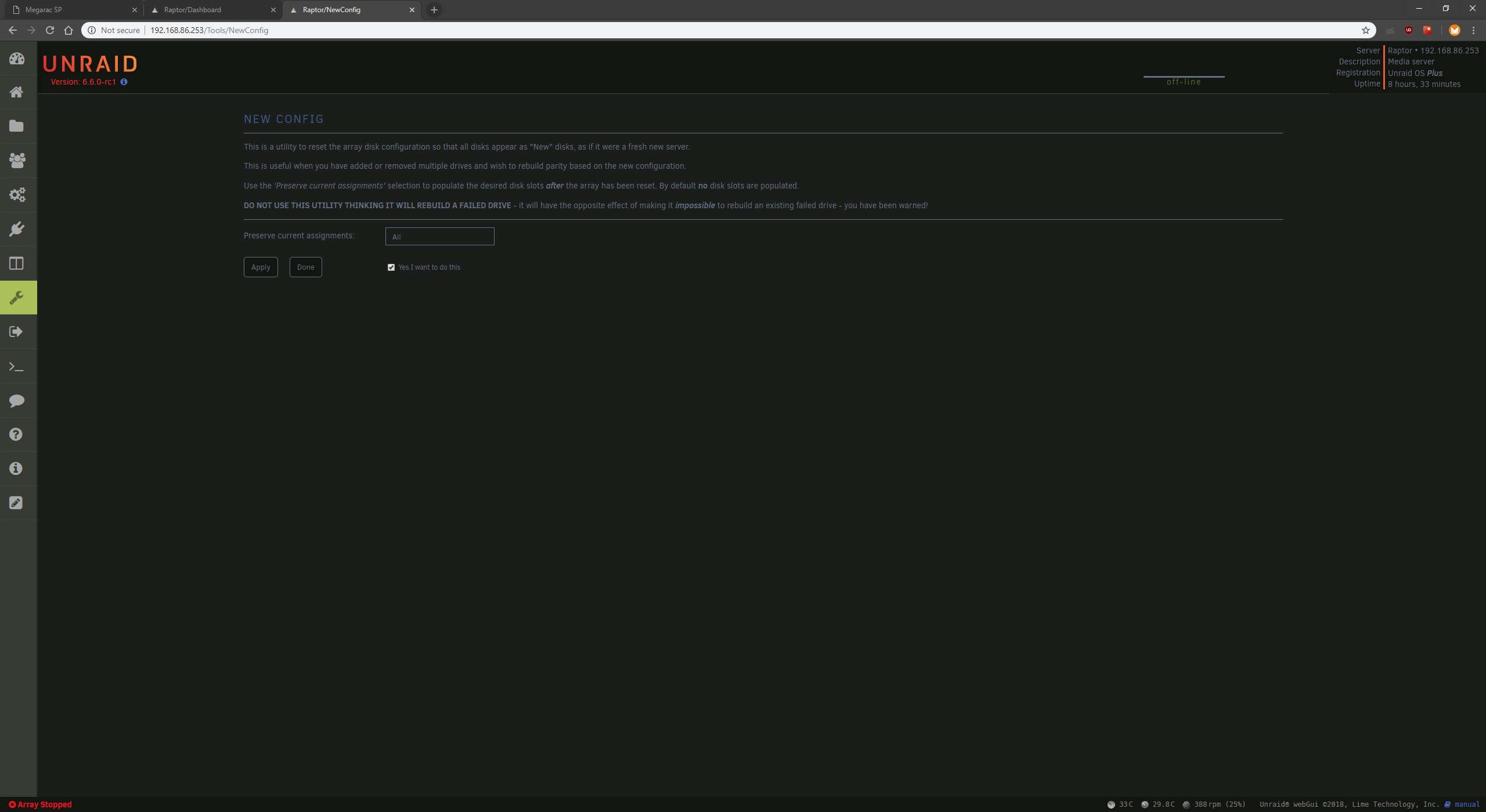

Go to Tools - New Config - Retain All, then change any assignments you need to match above. Do not start the array. Post a screenshot of the assignments before doing anything else. Include a screenshot of the Array Operations section of Main.

You should still be able to rebuild disk3 using the invalid slot command, though not tested yet on v6.6, but should work the same.
-Tools -> New Config -> Retain current configuration: All -> Apply
-Check all disks are assigned in the correct positions.

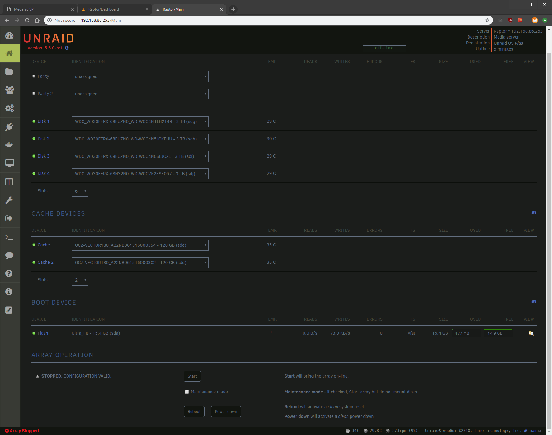

Hi @johnnie.black I've done new config, retain all and hit Apply. I've also put my disks back in the right order as determined by @trurl
I'm not going to hit anything until somebody says what, hoping to recover disk3 :)
That red error message is terrifying...
