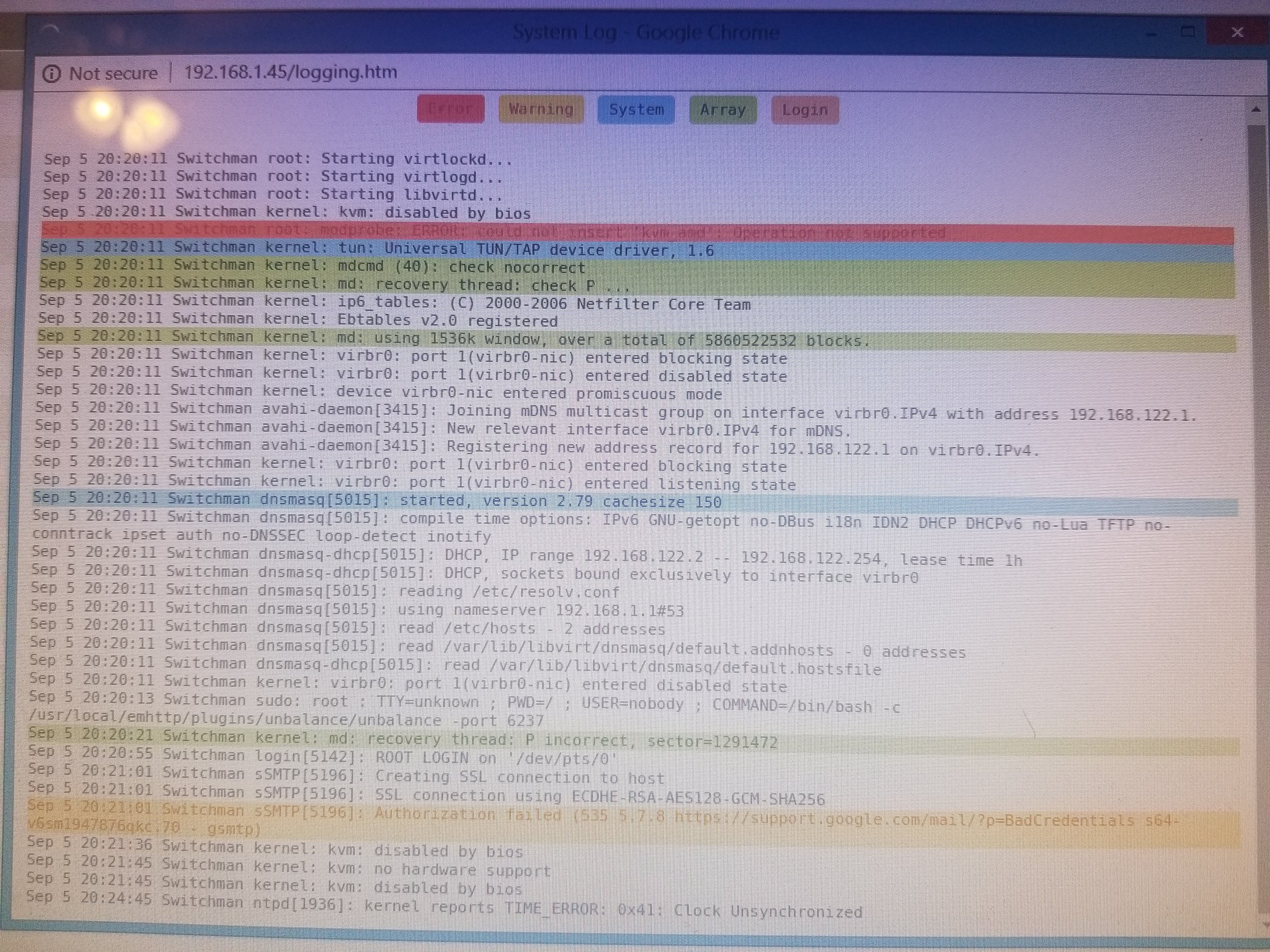

I just built a new server and now I am having issues staying connected to the internet. I have been trying to figure this out for two weeks now. It's no tell how long the sever will stay up but it will not last longer than 24 hours before losing connection. I have changed the ip several time and went extreme taking it to someone else network and still having same issue. Do anyone have a clue what could be happening. This is what I seen after I lost connection
Instead of posting a photo of a small excerpt of you syslog, please go to Tools - Diagnostics and post the complete zip.
