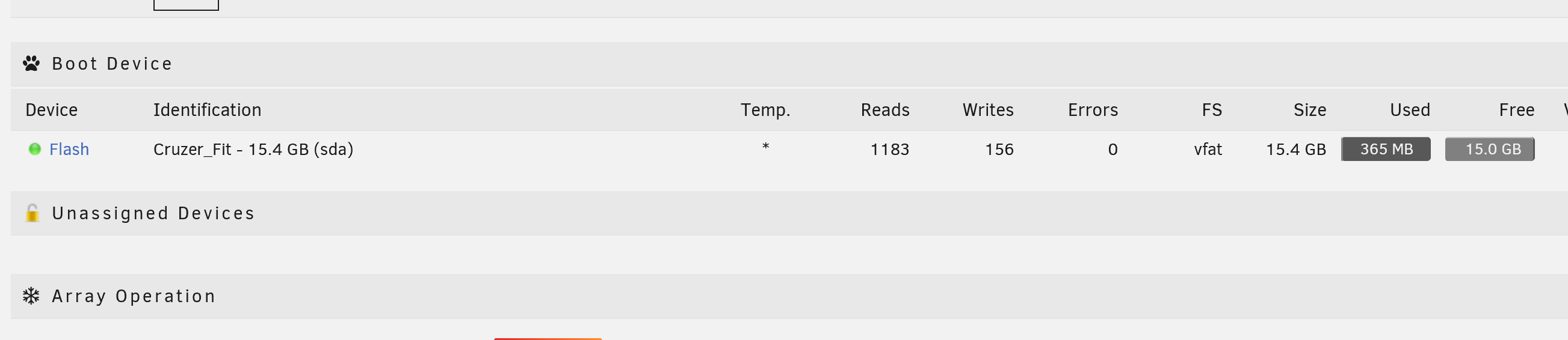

I'm not sure when this happened, but unassigned disks aren't showing up in the main dashboard. There's just an empty space. See screenshot below:
Disks show up on the dashboard page, but not the main page. I have an internal uninstalled disk, but this applies to external USB as well.

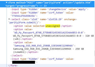

I looked at the source in Chrome and it looks like this, I'm not sure if "hidden has to do with anything.
