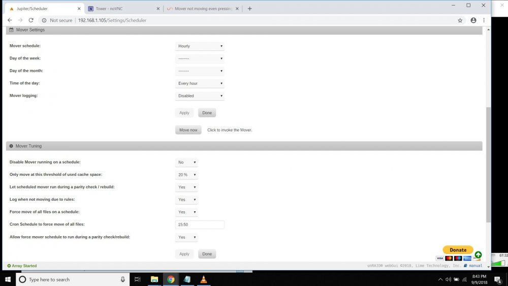

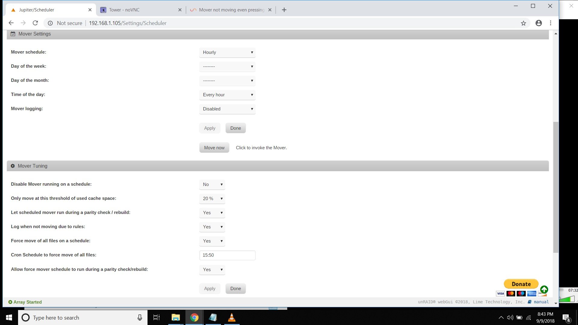

Post a screenshot of the mover tuning page. You've made a mistake in the Cron entry
Sent from my LG-D852 using Tapatalk
15:50 isn't a valid cron expression.

You'd probably want
50 15 * * *

I fixed the cron schedule per Squid then rebooted device. I also reseated my cache cables to make sure and did the recommendation of johnnie.black to monitor the disk errors... Then rebooted.

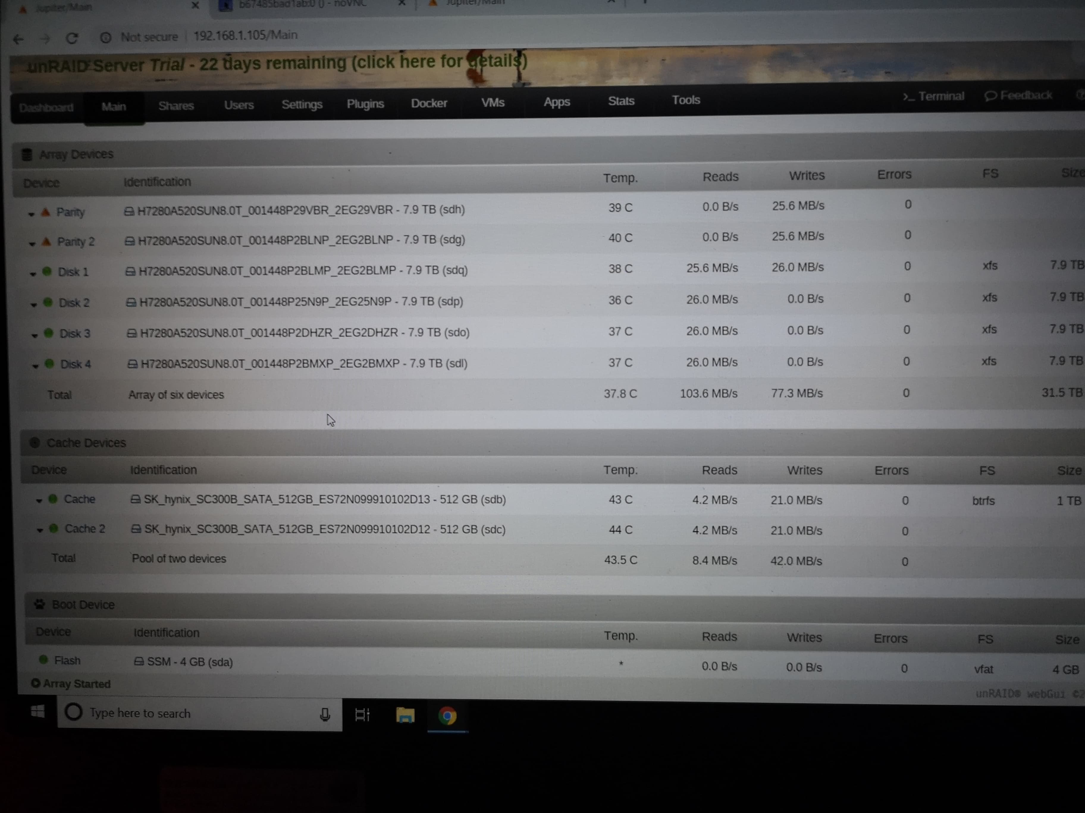

Now I am not sure is this speed normal?
I have cache dual 512gb  raid 0 so from network to the box speed is awesome I am getting about 100MBps. ( 1gbps for now I am still experimenting if unraid is for me and will upgrade to 10gbps soon as I have the hardware already ready I tried and getting about 500-600MBps )
Now the problem is from cache to magnetic.. I am only seeing speeds 26MBps write and read basically my cache getting full via 1gbps network connection !
basically the 4 disk are on an h310, the 2 parity is on another h310 both in IT mode and the cache is on the mobo sata connector.
Edited by aerosmith9110
Writes to HDD array are going to be much slower than writes to SSD cache. Of course SSD is faster, but in addition to that parity is updated in realtime with unRAID so writes to the parity array are typically about one half the speed of writes to a single HDD.
The speeds you are getting are worse than that, and the reason is revealed by your screenshot. You are still building parity. So in addition to the writes to the array updating parity, the parity builds are also reading and writing, and since different sectors are involved there is also a lot of additional seeking going on.
I disabled sync.. is parity different from sync? What speed should I be expecting for an He8 drive for this process? is my screenshot speed normal?

Is your cache SSD? I was assuming it was but maybe not. As for your screenshot speeds, I think it would be better to do a test without the parity sync going on.
I'm not entirely sure what you mean by "disabled sync". Are you saying you stopped the parity sync? I'm not entirely sure what unRAID does with parity until you have completed the parity sync. The screenshot is just indicating parity is invalid. Since I can't see the Array Operations portion of that screen I don't know whether it was actually building parity at that time or not but I assumed it must be since parity isn't valid yet.
We really shouldn't even be talking about screenshots anyway when what we really have is a photo. It would be a lot cleaner if in the future you actually gave us a screenshot (screen capture).
Study this. It gives a more complete explanation of how realtime parity is maintained and the 2 different methods that can be used, with their tradeoffs.
