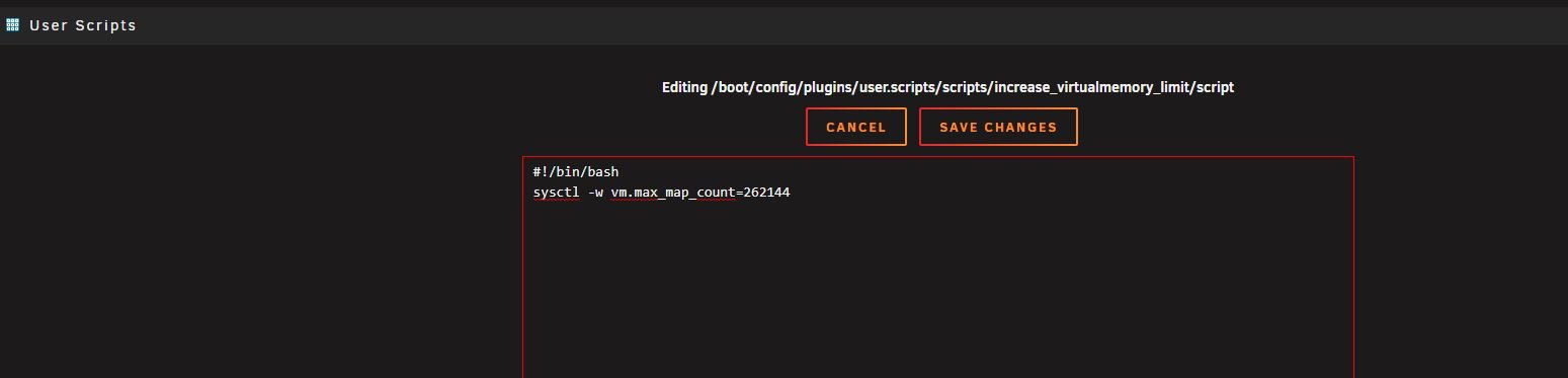

Add the script below to run at start of array:
sysctl -w vm.max_map_count=262144
After this elk stack is fully running, you will still need to set it up with index and all that to parse data.
Thanks @Jclendineng
I added the script but received an error
sysctl: cannot stat /proc/sys/vm/max_map_count: No such file or directory
I attached a screenshot of the script

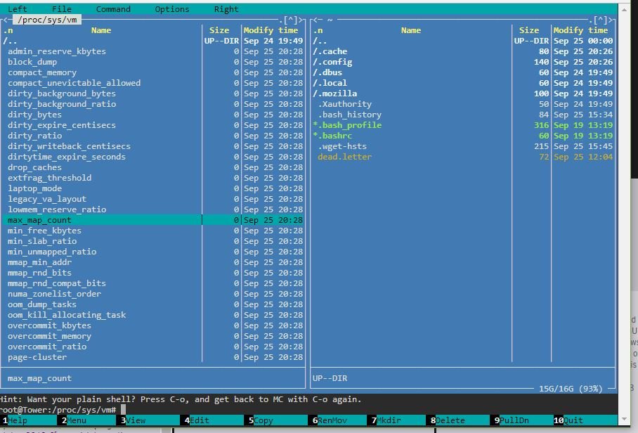

Hmm, I just added a new script, named it vm.max_map_count, and used that command, saved.
The error happens when the script runs...which is after rebooting the server and, subsequently, after the array starts...
Capture.thumb.PNG.f02f7179eaf2d4f52b74f05287e8f45f.PNGThis is what mine looks like, Just tested and it runs fine
Not a lot of room for user error here...I'm not sure how to debug this issue.
I used MC to see if the file exists and it does...
@Jclendineng
Alright. So I was able to change the max map count by running the command as root.

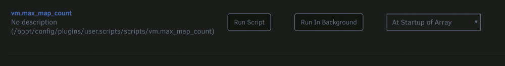

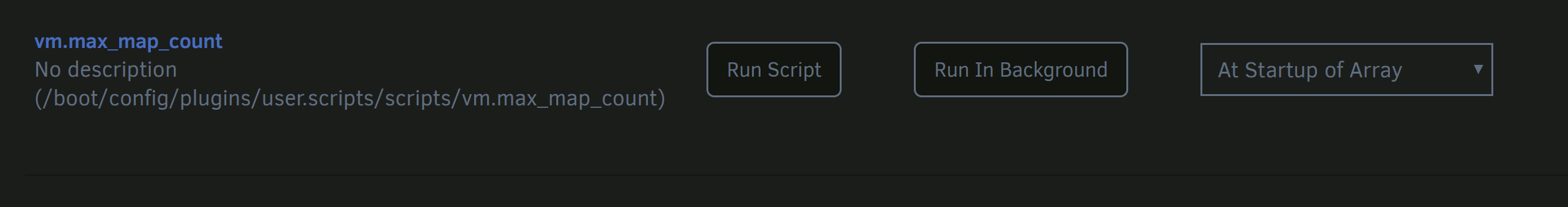

@surfshack66 I actually got the max_map_count working by renaming the script to vm.max_map_count. I'm not sure why this works but it does ¯\_(ツ)_/¯
