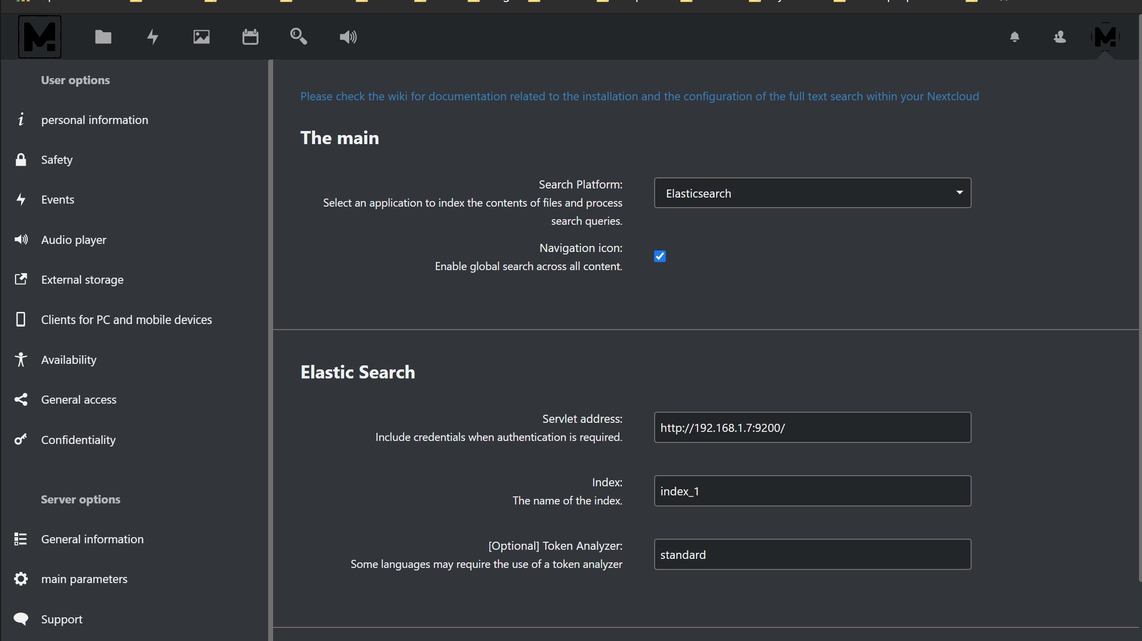

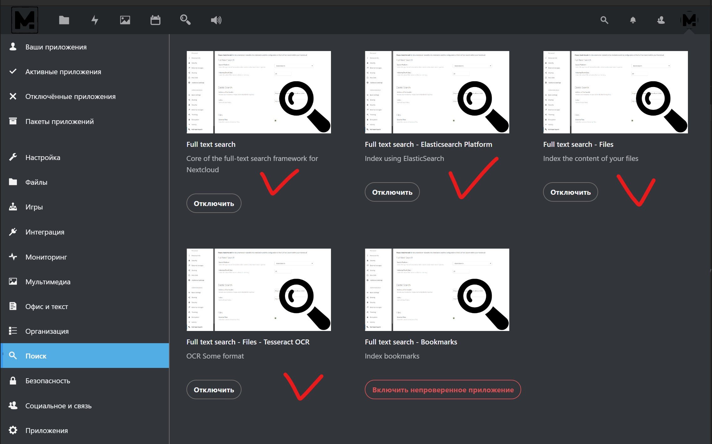

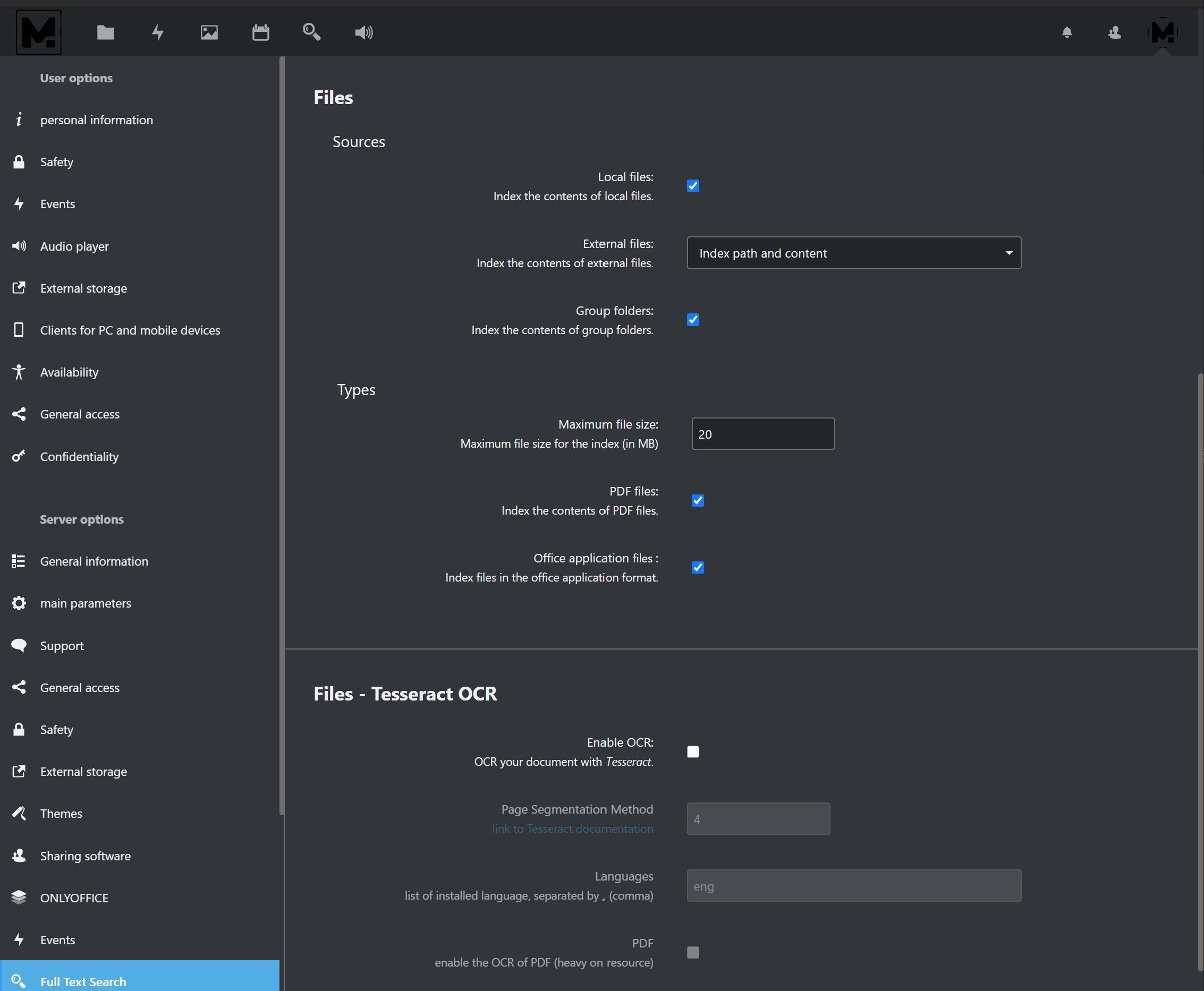

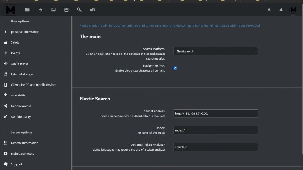

Hello. I want to share, because I myself was looking for Old.
I have NextCloud production, nextcloud repository: production-apache. Version 17.
1. I entered the script from the topic in the terminal
sysctl -w vm.max_map_count=262144
2. I installed 4 plug-ins with a magnifier in the NextCloud, on the NextCloud web.
3. I installed the plugin for NextCloud.
ingest-attachment
Entered in the terminal:
docker exec -it elasticsearch bash /usr/share/elasticsearch/bin/elasticsearch-plugin install ingest-attachment
4. Then I made the settings in NextCloud, as in the photo.
5. Then started indexing. In terminal:
docker exec --user www-data nextcloud php occ fulltextsearch:index
______________
I hope this helps someone.
Edited by muwahhid

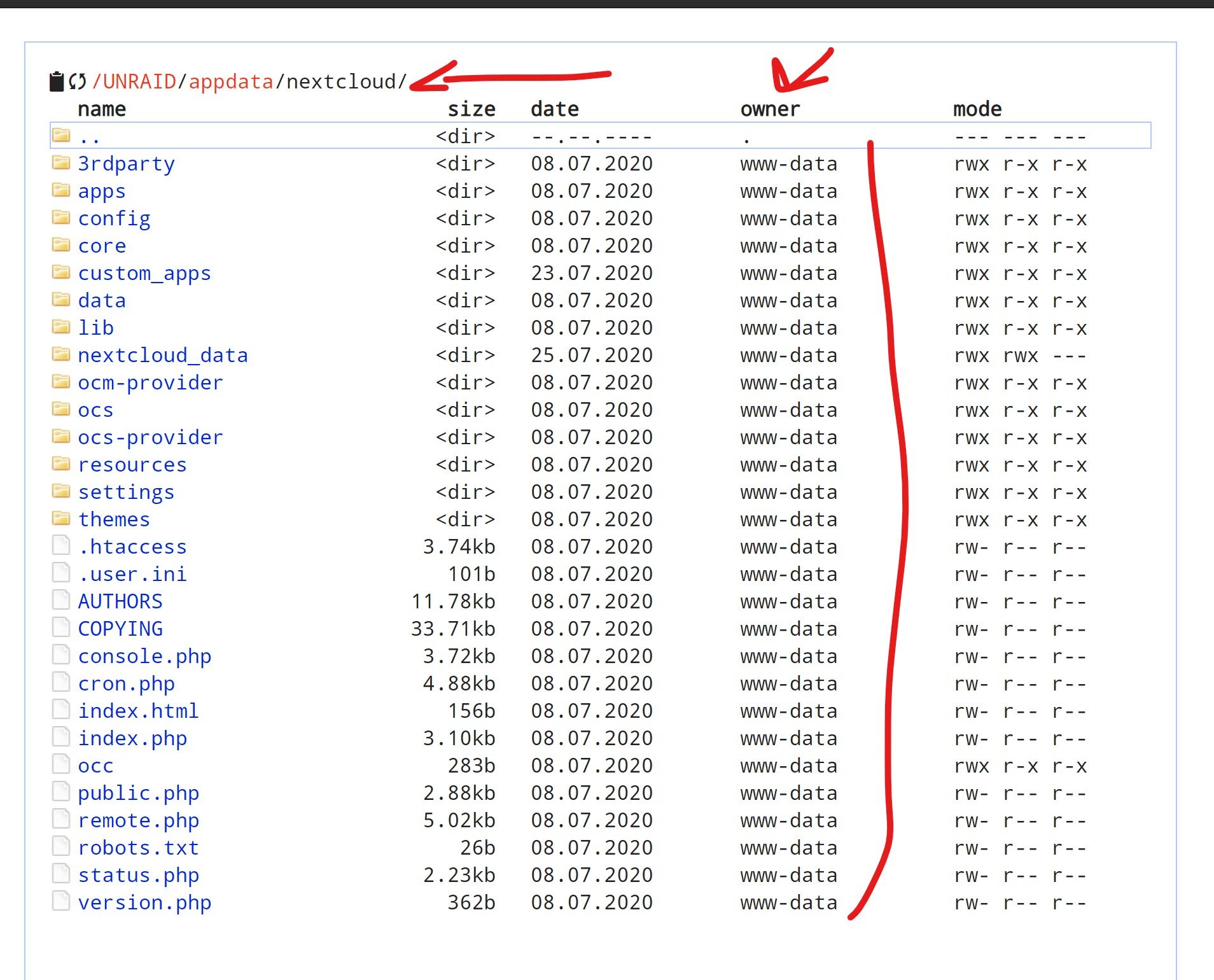

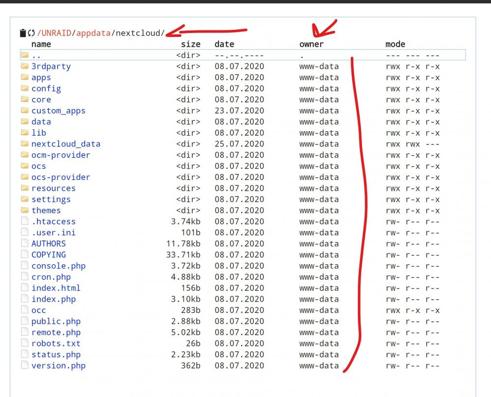

Thank you for your help is worked so far for me exept of the last step when i want to start with the indexing it give me de following error
root@Homeserver:~# docker exec --user www-data nextcloud php occ fulltextsearch:index
unable to find user www-data: no matching entries in passwd file
do you haven an Idea what i have to do to solve this error?

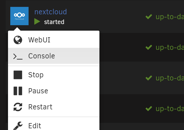

I have permissions to the "appdata/nextcloud" folder of the www-data user. You most likely have another user, so the error.
The www-data user is the default in Nextcloud, if you have another user, you can return everything this way.
open terminal on docker nextcloud, and write:
chown -R www-data:www-data /var/www/html/data

You need to stop the elasticsearch docker and restart it after you have executed the command to install the plugin so it gets loaded into elasticsearch.
Here my steps:
1.) get elasticsearch docker (7.9.1 works) do a clean install (delete old elasticsearch in /mnt/user/appdata/)
2.) Download the full text search packages in nextcloud app store (at least 3 packages)
3.) Configure your Nextcloud search platform to "Elasticsearch" and address of Servlet to: http://YOUR_IP:9200/
It needs to be configured to the port of the REST API
4.) Install the plugin for elasticsearch, by either opening a console inside the elasticsearch docker and type /usr/share/elasticsearch/bin/elasticsearch-plugin install --batch ingest-attachment
OR
through the User scripts Unraid plugin as stated above.
5.) Restart the elasticsearch container
6.) Test everything by opening a new shell in the nextcloud container then navigate to the occ directory (/var/www/html) and type
./occ fulltextsearch:test
If everything is ok, then you can continue with the index: ./occ fulltextsearch:index

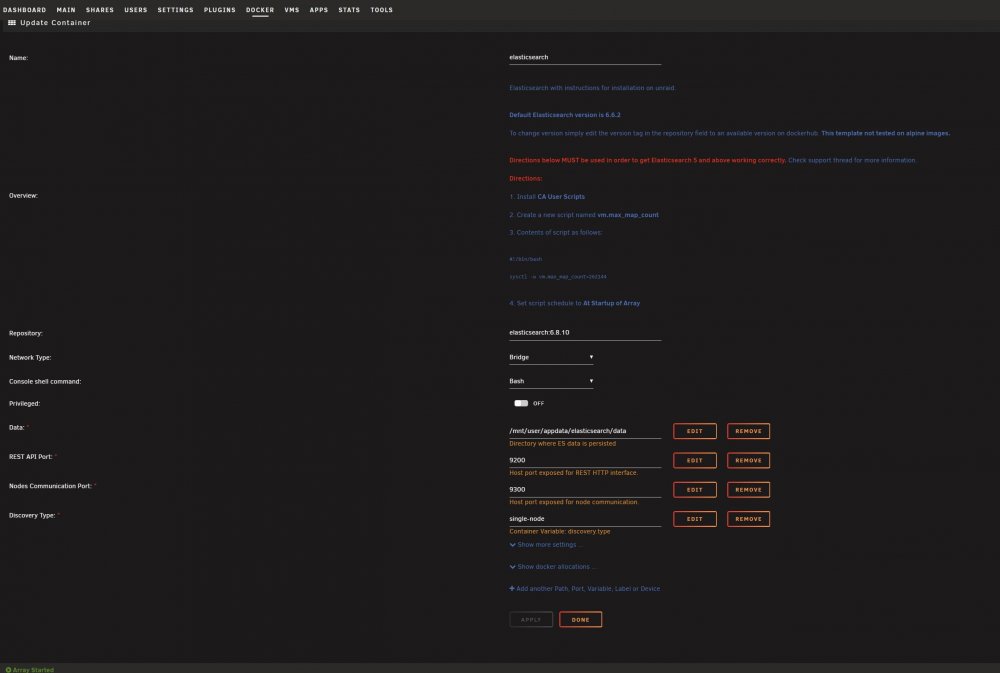

I've been using Elasticsearch 7.9.1. On a docker image reinstall, I'm failing to get this to work again. I've moved to 7.9.3 in case it was a bug fix.
I have a heap size issue. The pull down shows completed successfully, see the environment variable:
-e 'ES_JAVA_OPTS'='-Xms4g -Xmx4g' which I entered. Later in it shows this as well:
-e "ES_JAVA_OPTS"="-Xms512m -Xmx512m"
When I do an "echo ES_JAVA_OPTS" inside the container, it shows that only 512m memory is being used. It appears as if the 512m is taking precedent. I've also set the minimum and maximum heap size in the jvm.options file. It doesn't seem to make a difference.
Below is the container pull:
root@localhost:# /usr/local/emhttp/plugins/dynamix.docker.manager/scripts/docker run -d --name='elasticsearch2' --net='bridge' -e TZ="Australia/Brisbane" -e HOST_OS="Unraid" -e 'discovery.type'='single-node' -e 'ES_JAVA_OPTS'='-Xms4g -Xmx4g' -p '9200:9200/tcp' -p '9300:9300/tcp' -v '/mnt/user/appdata/elasticsearch/data':'/usr/share/elasticsearch/data':'rw' -e "ES_JAVA_OPTS"="-Xms512m -Xmx512m" --ulimit nofile=262144:262144 'elasticsearch:7.9.3'
82d34c8772e2291a617e86a9c4f21dd227a392c3d02f1522384e7b02332566fa
The command finished successfully!
I've tried this for most of the day. I've not had this problem before, I urgently need to get this up and running. Can anybody advise?
{"type": "server", "timestamp": "2020-10-24T16:07:56,878+10:00", "level": "INFO", "component": "o.e.n.Node", "cluster.name": "docker-cluster", "node.name": "82d34c8772e2", "message": "JVM home [/usr/share/elasticsearch/jdk]" }
{"type": "server", "timestamp": "2020-10-24T16:07:56,879+10:00", "level": "INFO", "component": "o.e.n.Node", "cluster.name": "docker-cluster", "node.name": "82d34c8772e2", "message": "JVM arguments [-Xshare:auto, -Des.networkaddress.cache.ttl=60, -Des.networkaddress.cache.negative.ttl=10, -XX:+AlwaysPreTouch, -Xss1m, -Djava.awt.headless=true, -Dfile.encoding=UTF-8, -Djna.nosys=true, -XX:-OmitStackTraceInFastThrow, -XX:+ShowCodeDetailsInExceptionMessages, -Dio.netty.noUnsafe=true, -Dio.netty.noKeySetOptimization=true, -Dio.netty.recycler.maxCapacityPerThread=0, -Dio.netty.allocator.numDirectArenas=0, -Dlog4j.shutdownHookEnabled=false, -Dlog4j2.disable.jmx=true, -Djava.locale.providers=SPI,COMPAT, -Xms4g, -Xmx4g, -XX:+UseG1GC, -XX:G1ReservePercent=25, -XX:InitiatingHeapOccupancyPercent=30, -Djava.io.tmpdir=/tmp/elasticsearch-10094349604196076055, -XX:+HeapDumpOnOutOfMemoryError, -XX:HeapDumpPath=data, -XX:ErrorFile=logs/hs_err_pid%p.log, -Xlog:gc*,gc+age=trace,safepoint:file=logs/gc.log:utctime,pid,tags:filecount=32,filesize=64m, -Des.cgroups.hierarchy.override=/, -Xms512m, -Xmx512m, -XX:MaxDirectMemorySize=268435456, -Des.path.home=/usr/share/elasticsearch, -Des.path.conf=/usr/share/elasticsearch/config, -Des.distribution.flavor=default, -Des.distribution.type=docker, -Des.bundled_jdk=true]" }
Okay,
So for those following after me. I'm not very experienced with docker, but I pulled down the container manually and by doing so changed the environment variables, changing the heap size to 2g.
docker run -d --name='elasticsearch' --net='bridge' -e TZ="Australia/Brisbane" -e HOST_OS="Unraid" -e 'discovery.type'='single-node' -e 'ES_JAVA_OPTS'='-Xms2g -Xmx2g' -p '9200:9200/tcp' -p '9300:9300/tcp' -v '/mnt/user/appdata/elasticsearch/data':'/usr/share/elasticsearch/data':'rw' -e "ES_JAVA_OPTS"="-Xms2g -Xmx2g" --ulimit nofile=262144:262144 'elasticsearch:7.9.3'
I changed the second set of ES_JAVA_OPTS (in red) from Xms512mb -Xmx512mb to 2g instead. However, I've just noticed that there are two ES_JAVA_OPTS entries, the other one I've marked in yellow. This was a copy and paste from the original container install. No matter what I did I couldn't get the heap size to change from 512mb to any other size by setting ES_JAVA_OPTS as a variable in the CA settings for the container or via jvm.options inside the container itself.
Anybody shed light on this? I would like to just pull the container down without all this phaff.
